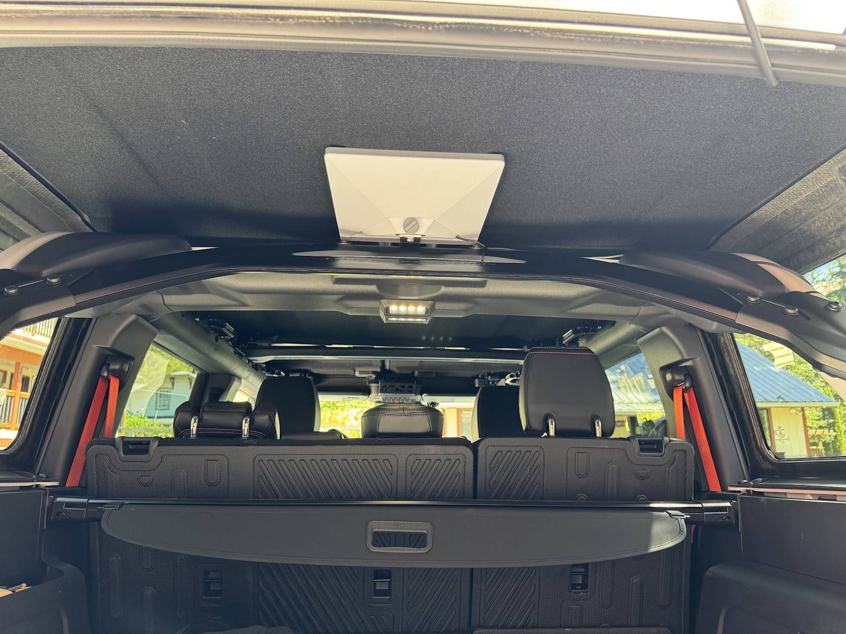

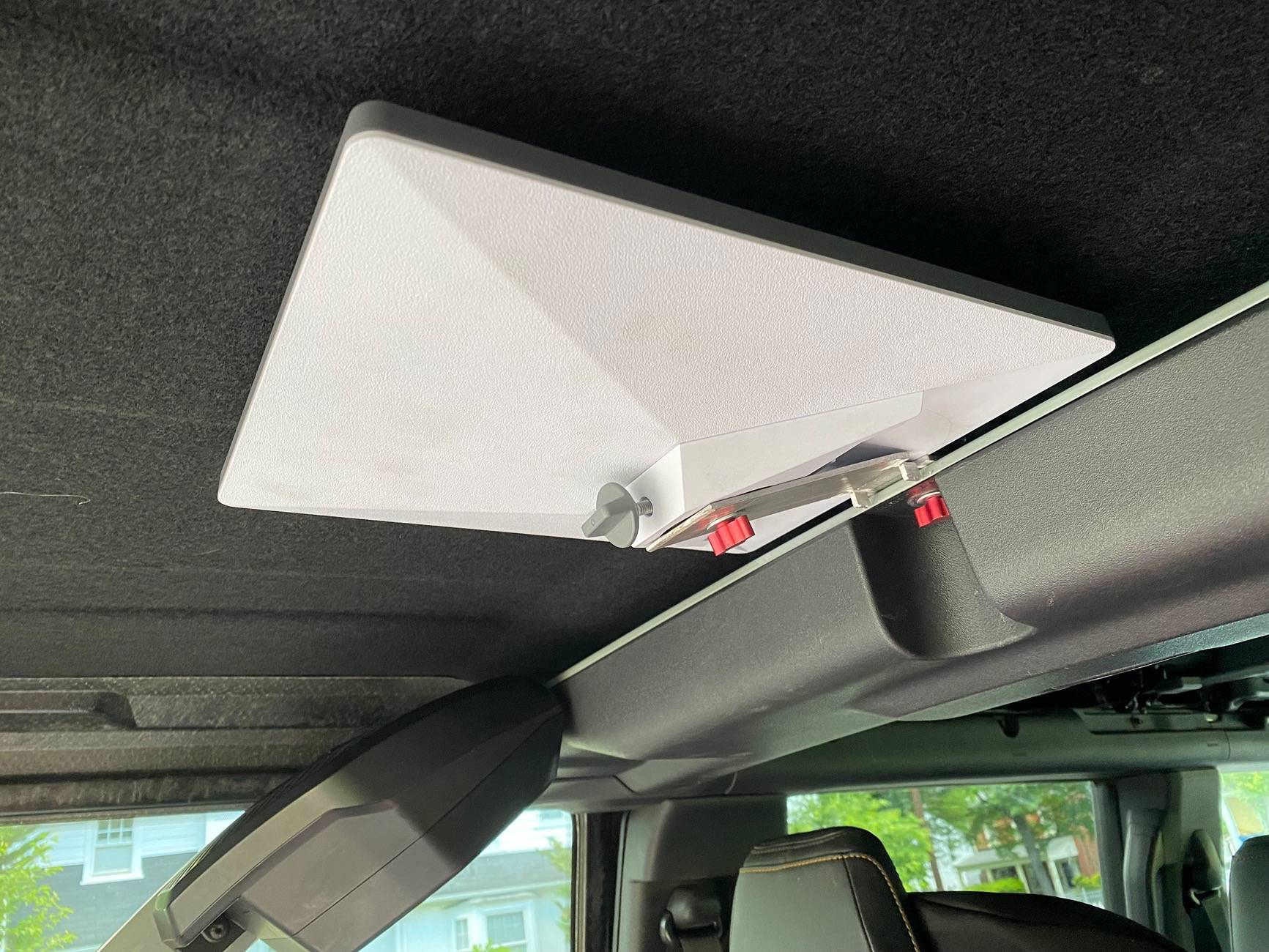

Special thanks to @RHeinz for posting this. I installed mine today using pretty much the same method. I bought some 2" x 1/8" aluminum stock, drilled a few holes, and bolted it up. I used a small piece of velcro tape on the back edge of the Starlink to hold it form sliding, but that may have been overkill with the aluminum pressing on it. I just fired it up, but so far in congested western Washington state I'm getting about 60 down and 15 up, about 1/2 of what I'm getting from the Starlink on my roof. Off to Moab in a few days, but again, thanks for the idea. It's not a very elegant solution, but for about 30 mins of work, this is such a simple solution and total cost was about $10 in hardware, plus $35 for the dedicated charger. I'll probably visit Send Cut Send when I have more time and build a proper bracket, but I just can't seem to justify spending any more on a different solution unless I go full roof off more often, which is rare where I currently live.

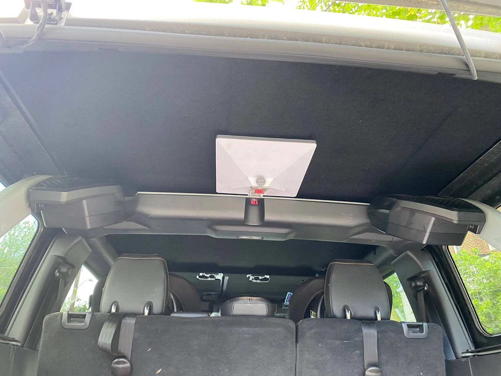

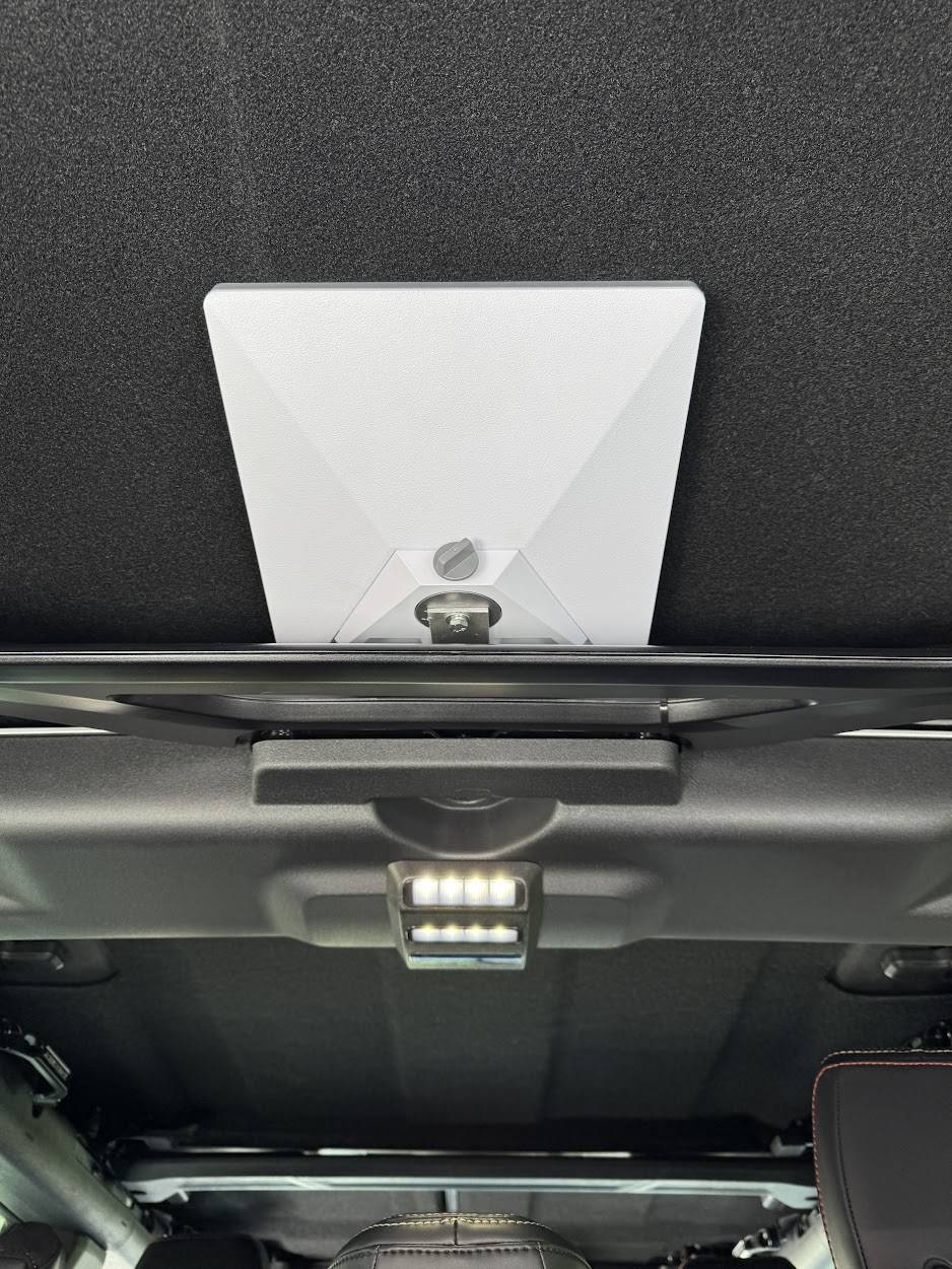

Thanks to @BlarneyStoned for posting the deal, helped me pull the trigger on the mini. I had the larger 3rd gen dish and couldn’t find a good way to install it since it was so big. It also used twice the power as three mini so I’m happy to upgrade.
I used a similar bracket but tried to put a rivnut in it. That turned out to be a huge PIA without the proper tools.
All and all I think it will work for the time being but it is bouncy.
Ford Bronco Starlink Mini installed for remote camping IMG_9317
Ford Bronco Starlink Mini installed for remote camping IMG_9319

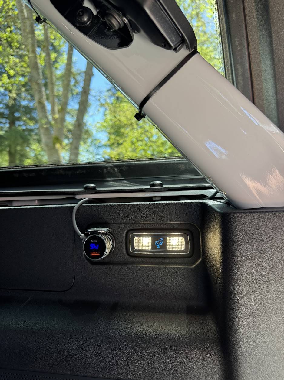

Mounted mine today.
Magnet mount to the Turn Off-Road overhead molle panel. Run thru a Jackery Explorer 100 Plus, which is plugged into the rear 12V port.
