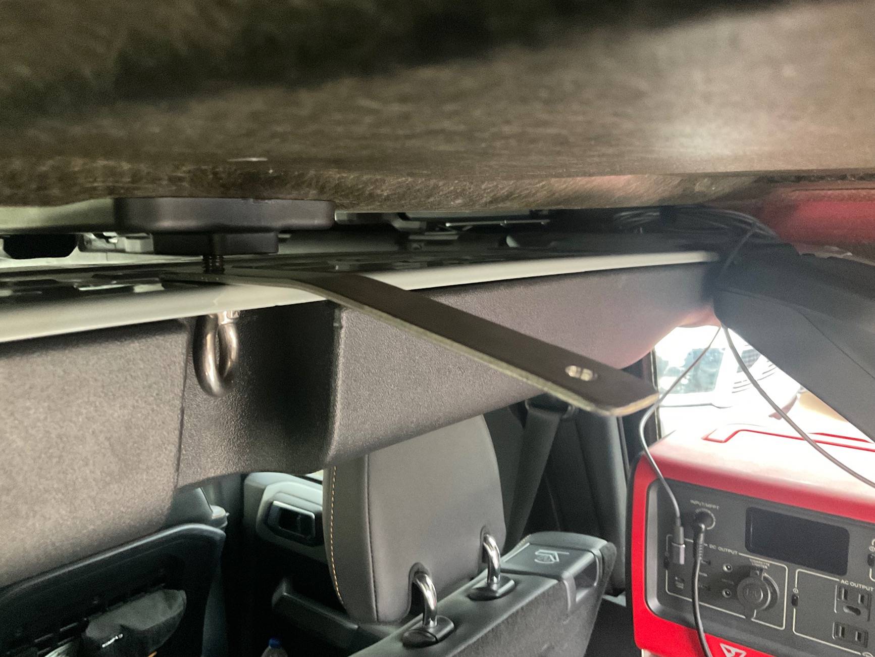

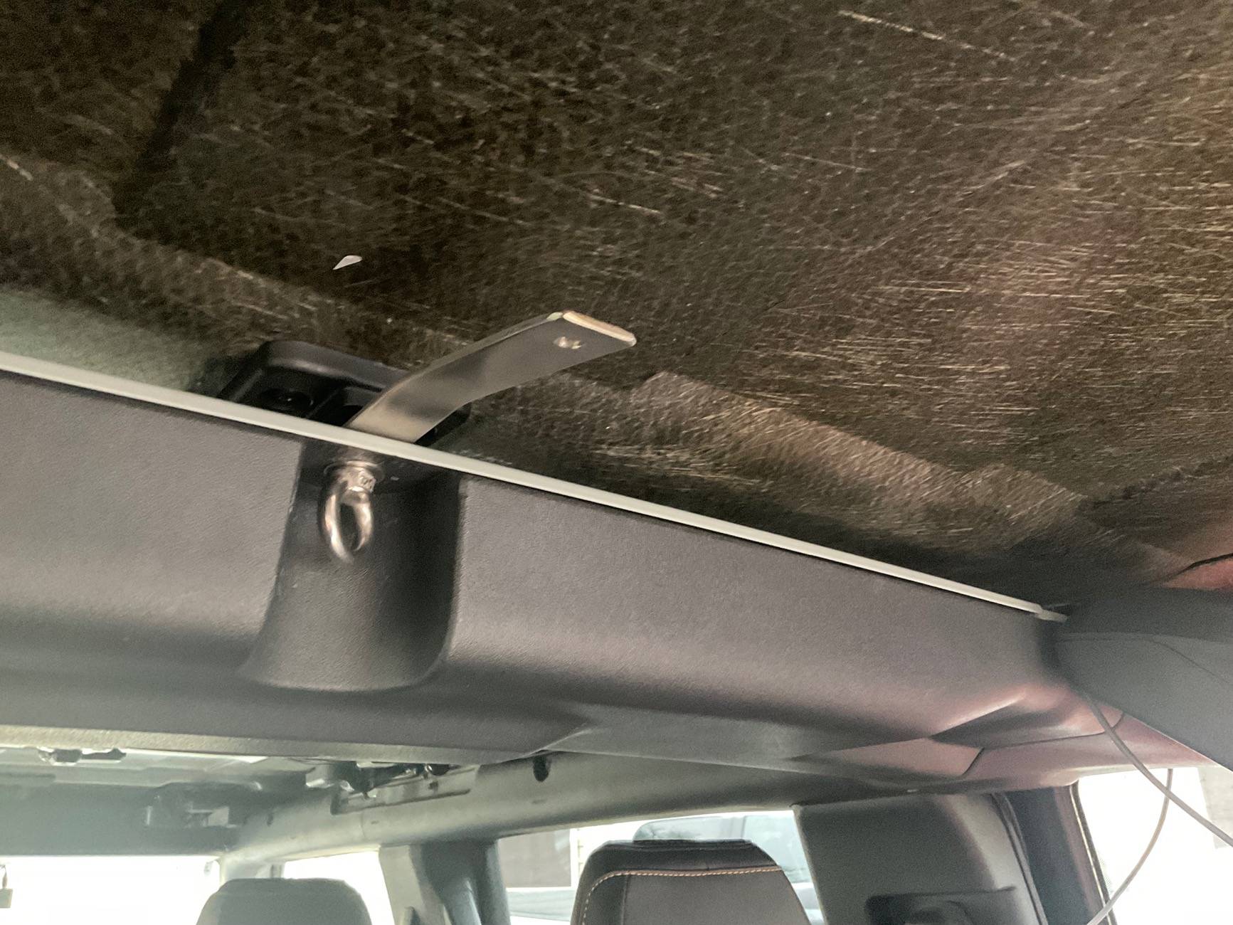

It’s just a piece of 1” flat bar (stainless) X 7” long, bent as noted. Uses the Starlink tripod mount via a hole on one end and M8x1.25 threads on the other. Had some left over M8 eye bolts that match the roll bar holes and the MIC hold down bolts.
The lights are from NEBO, attached with Velcro for battery access.

Thanks for the idea , can you take more pictures of your setup please , to be able to replicate it , thanks in advance
No problem.
Ford Bronco Starlink Mini installed for remote camping IMG_0316
Ford Bronco Starlink Mini installed for remote camping IMG_0317
Ford Bronco Starlink Mini installed for remote camping IMG_0318
I ended up tapping the flat bar at the roll bar end because I could not get the nut started on top. Too frustrating. The bend in the flat bar was just a WAG. IIRC the flat bar was 7” long overall, but the length is not too critical. I used the standard STARLINK pole mount with a tripod adapter from Amazon.
I thought the eye bolts would be handy for hanging camping lights and also for quick removal to get optimum orientation/location when at a campsite.

Ford Bronco Starlink Mini installed for remote camping IMG_7070
Ford Bronco Starlink Mini installed for remote camping IMG_7072
Here are is the pictures this is not the final configuration. I put velcro across the mini to make sure it doesn’t vibrate. The mini is powered by the Bronco’s inverter. I really like how the Starlink Mini works!

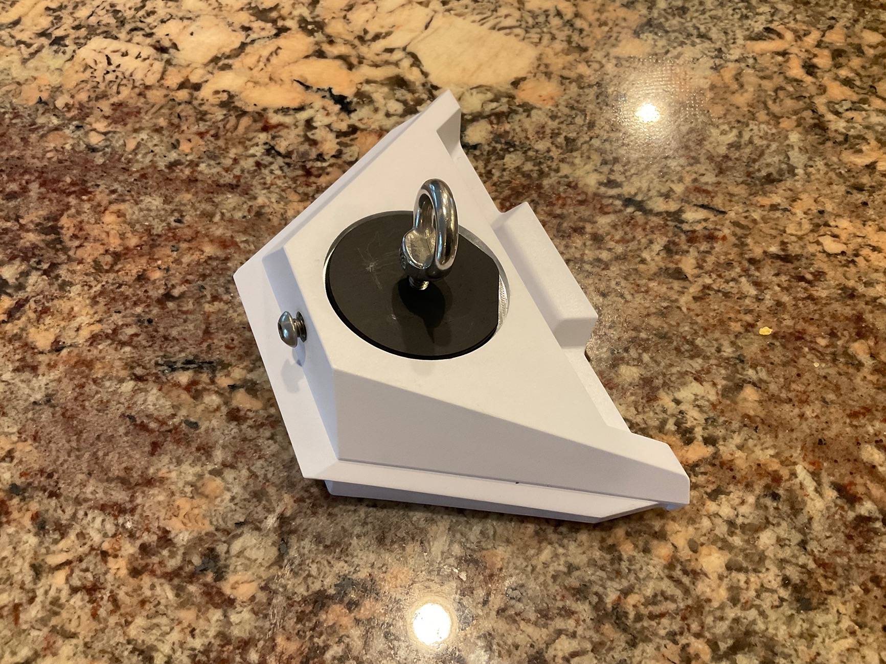

I recently got a starlink mini and after considering using a magnet mount on my roof rack, I found out it perfectly fits on my overhead Molly panel. I used to included pole mount an option to tighten it to the Molly panel. The starlink barely touches the padding on the bottom of the roof panels.
