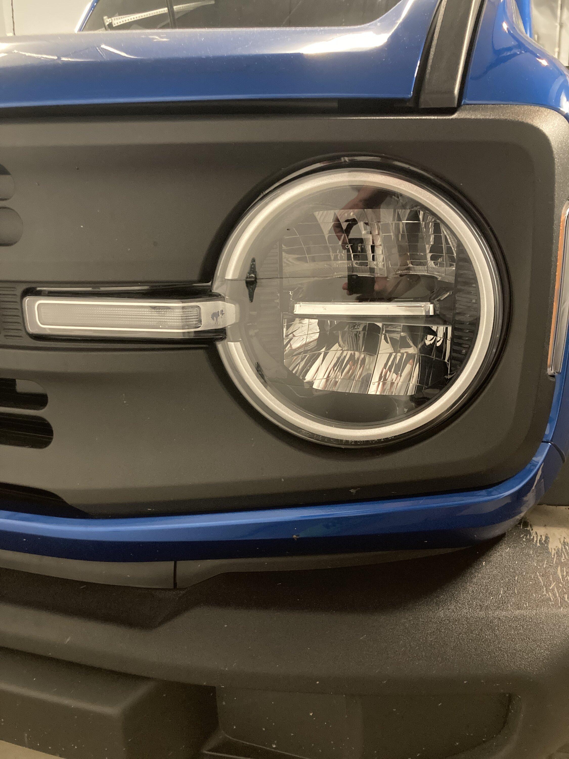

I’ve searched through a ton of threads and found that with the standard headlights (see attached pic - not the signature lighting) that if you change the DRL to the amber turn, the low-beam headlights still come on as the DRL’s.
Has anyone figured out a way to program with Forscan so that ONLY the small amber (turn signal section) can be on for DRL’s?
Thank you so much

I don't think standard lights are configurable in any way. I bought a take-off set to mess around with because I prefer the look over the signature lights, and there are no modules or LED drivers on then like the signature lights have. Not 100% positive on that, but that's my guess from looking at them externally. I had one regular and one signature hooked up, messed with settings in forscan and the regular never did anything different that I saw.

About a year ago, I tried a bunch of options in forscan. I could get the ambers to come on as DRL after changing some things, but the headlights were also on then as well. Never could get just the ambers (without headlights as well) to be the DRL. I gave up, good luck!

I had to look up my old posts, but here you go below in italics. This worked for getting the DRL to activate amber bars and low beams both on as DRL. At that point it was equivalent to running around with my headlights on all the time, same as factory at night. I turned it off, let me know if you find a way to get ambers ONLY as DRL.
I have a 22 Black Diamond with the base headlights. Default from factory for DRL is low beams only. Trying to change to amber bars for drl only, no low beams. I tried all the different DRL settings in the as built, nothing worked. Using the BdyCM drop down menu config, I was able to get the amber bars to turn on with the DRL's by changing both Left and Right Front Turn Lamp Usage to "Turn and DRL'. Now I have both amber bars and low beams as my DRL. Any ideas on how to shut of the low beams and just leave the amber bars for drl?
