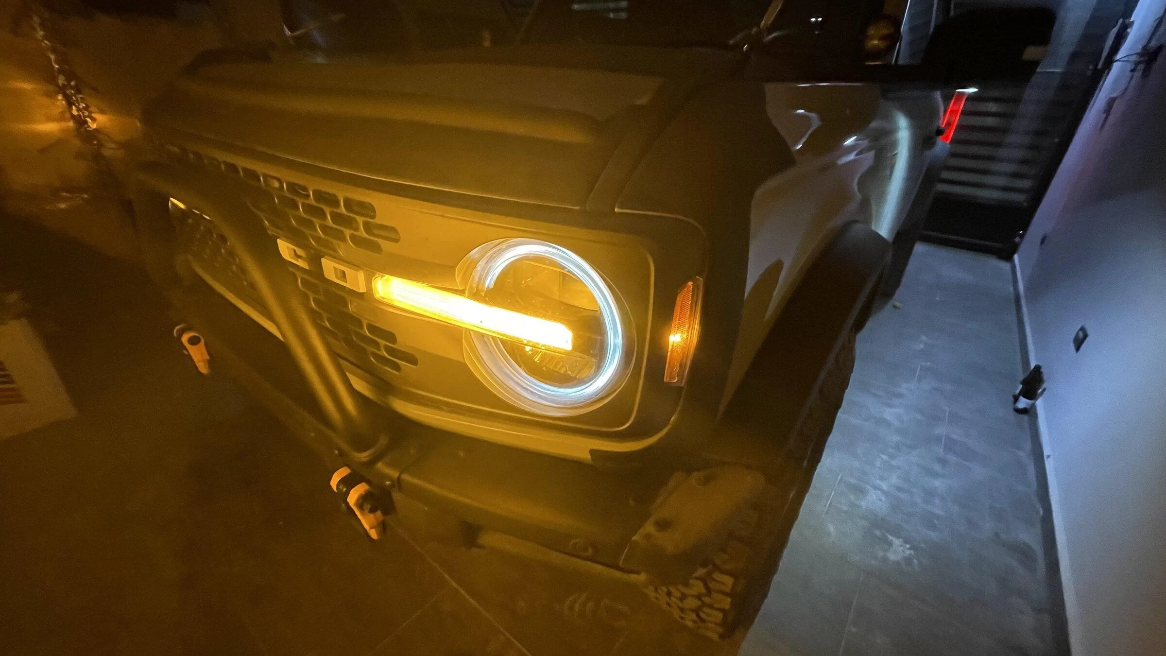

Interested in any insight to this. I would love to have the amber bar for DRL and still work for turn signal, obviously. I haven't invested anytime yet into learning how FORScan works, yet.

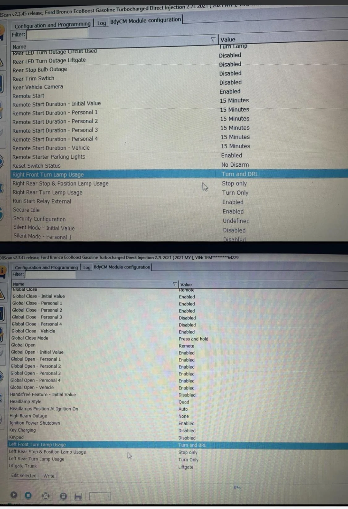

‘21OBX
Ken
Jan 24, 2022
95
2,475
3,189
90Bronco19
2022 bronco outer banks
I did the amber bar with drl in the plain English section turn signals work as they should. This is what I changed.
Ford Bronco DRL settings in Forscan B1F17F19-F321-41C4-80C3-D36D778076C2
