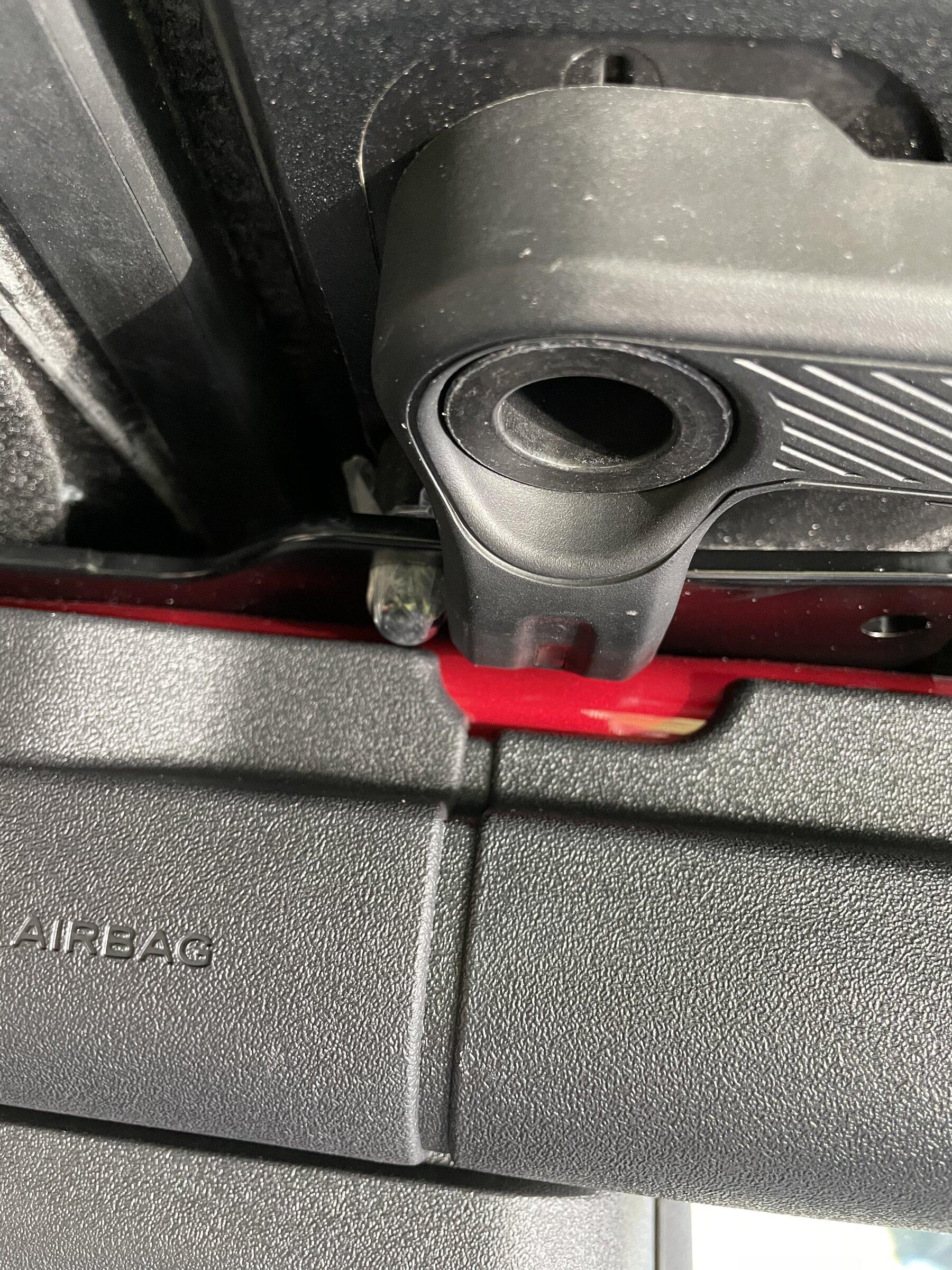

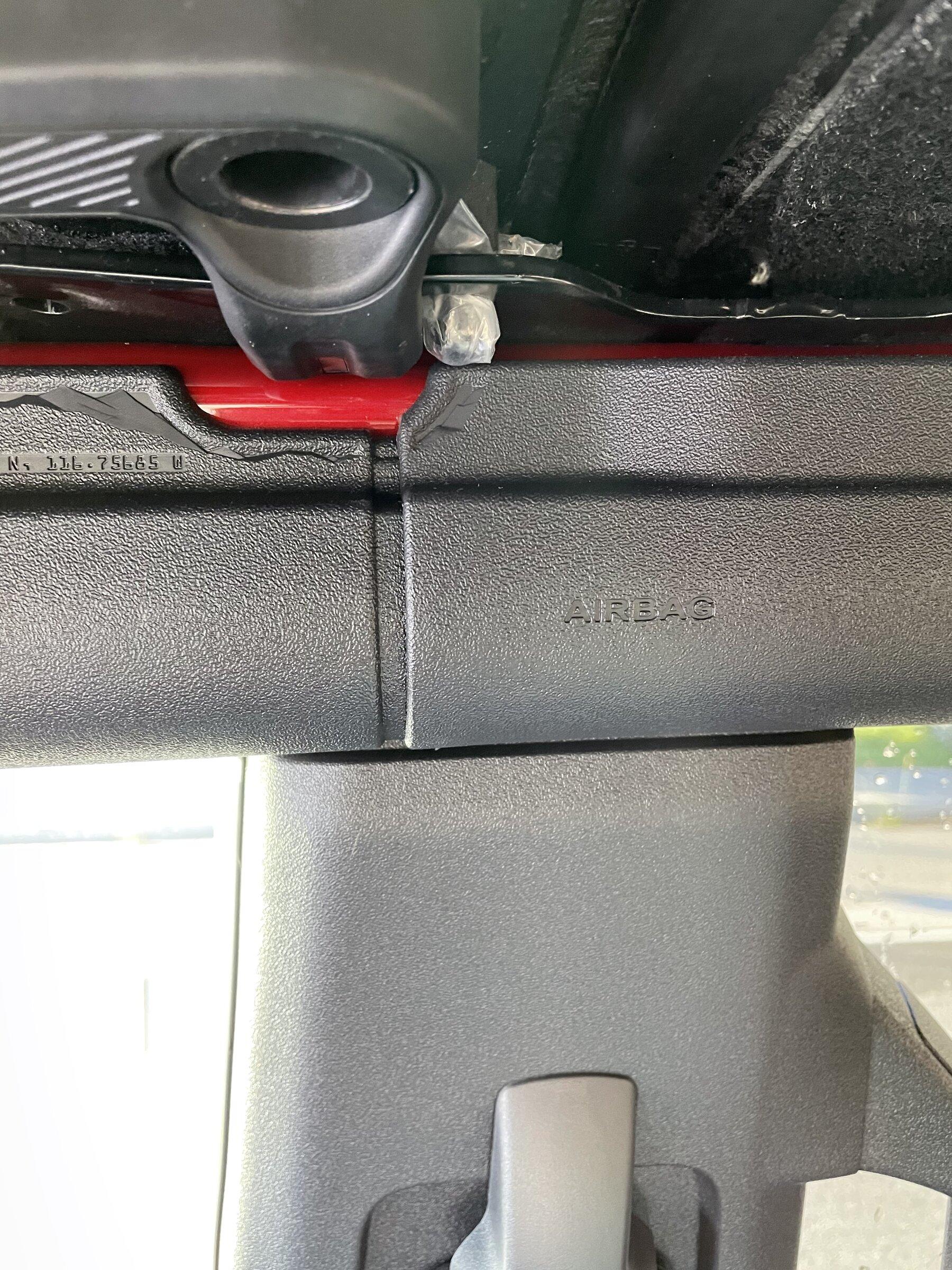

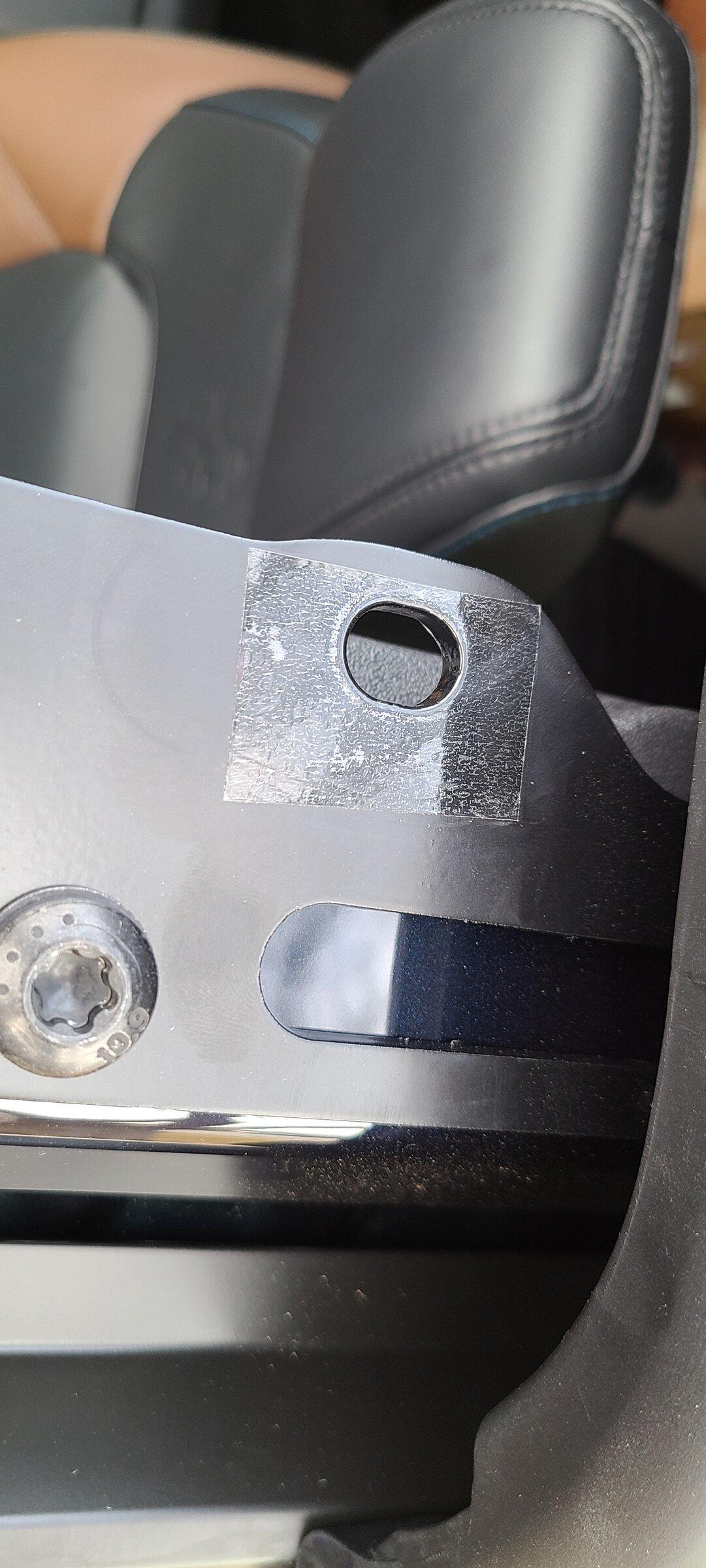

As you can see by this thread a variety of materials will fix this horrible issue. I used plastic wrapper out of the trash can at a gas station during a road trip. 500 miles later not a single pop.

Mine started last week around 2k miles. I put a square of clear 3m wrap that I used on the sills over and inside the pin holes. Seems to have solved it for now.
Good to know a thinner and more permanent material is a possible solution s well. I have a bunch of clear PPF so I’m going to try that as well. It would be nice not to have to keep track of the foam every time I take the panels off.
Improvise, adapt, and overcome. I love it!

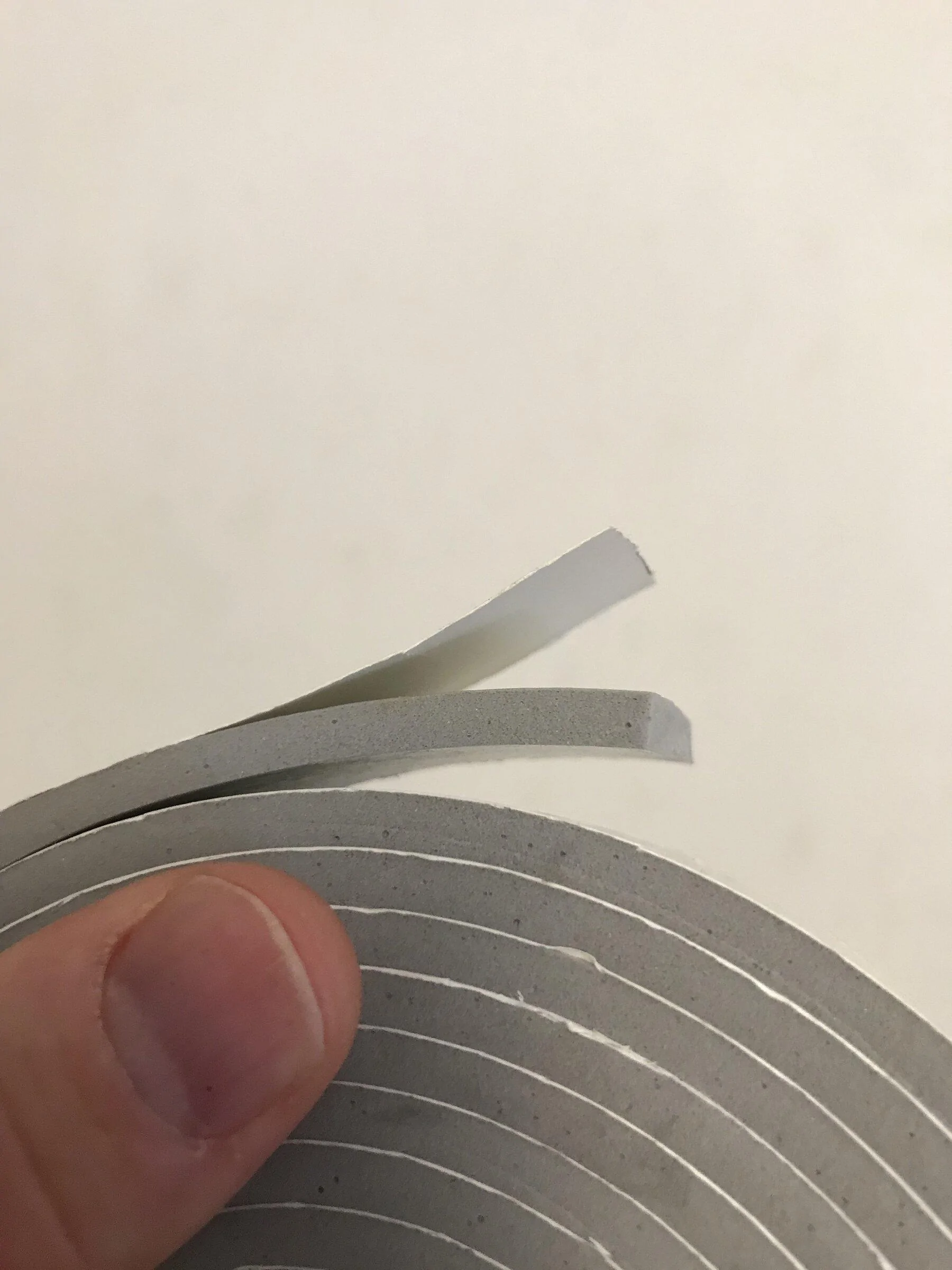

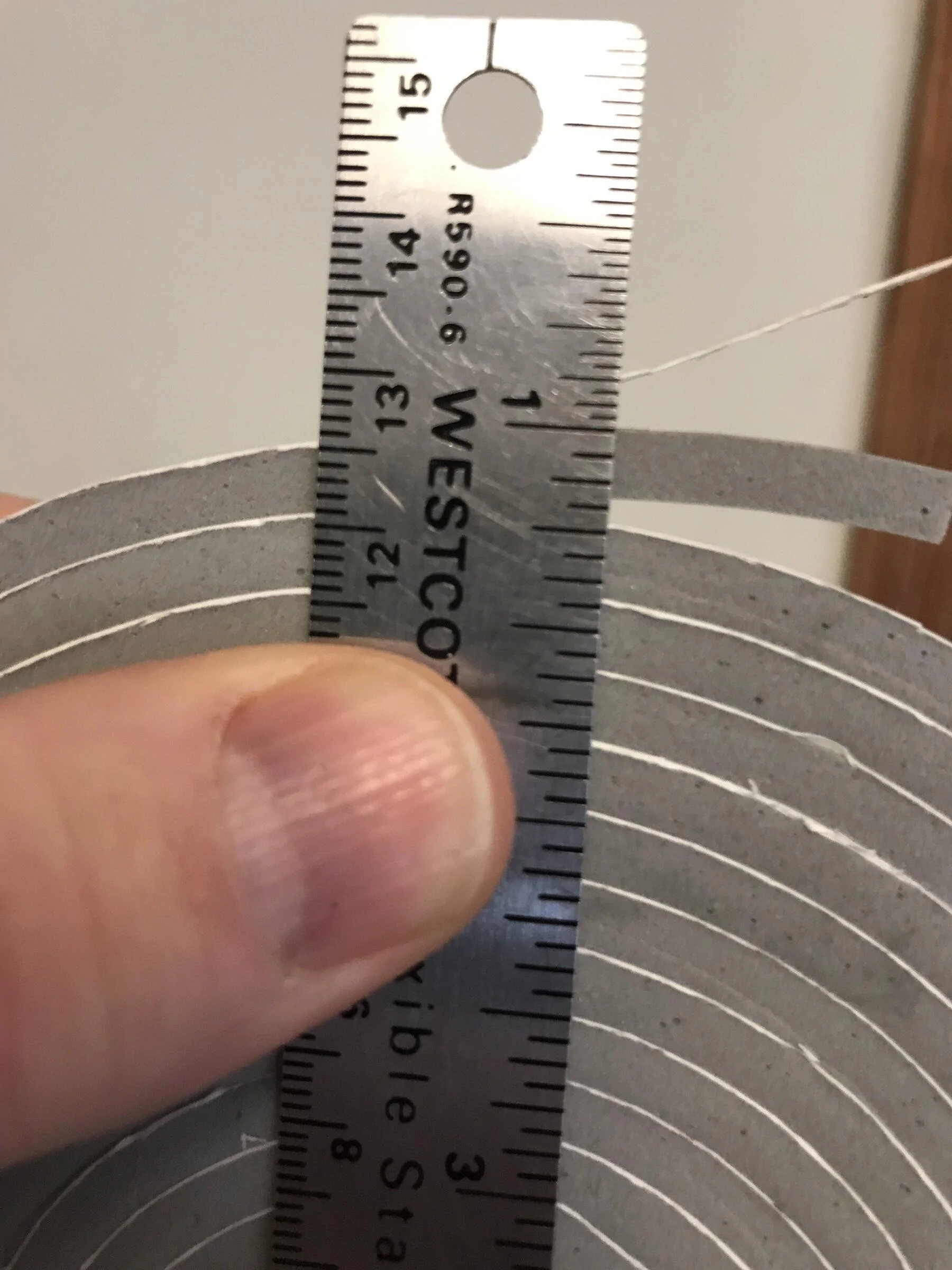

Wanting to cover both the flat surface and the inside of the guide pin hole, we used self stick closed cell weather strip. It squeezed almost flat and is fairly stretchy. It squishes down into the pin hole.
Also used this underneath the black factory rubber on the front and rear corners. The black corner rubber is factory molded to move and squash up some under pressure. The weather strip adds just a little more pressure to this and hopefully will stop some wind noise. It flattens out so much that it may not do any good.

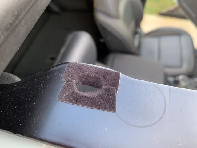

Flocking tape I had laying around worked. The silicon spray did not work.
edit…to add I only did the two holes above the driver and passenger heads. That appears to be the place the popping comes from. Other holes have nothing.

Great adaptation of the foam idea. I need to do something like this so I don't have to keep track of the foam scraps I've been using. It's good to know a much thinner material is effective. I haven't heard any noise coming from the rear panel or anywhere else on the top.

Now that my front popping has stopped, I have heard something from the back. However, I haven't dug into yet. Sounds like it is coming from the way back. Vehicle is being wrapped this week and the OEM protection on the lip where the rear top sits will get new PPF. Waiting to see if that helps. I am almost tempted to ask him to replace my flocking tape with PPF scraps.
