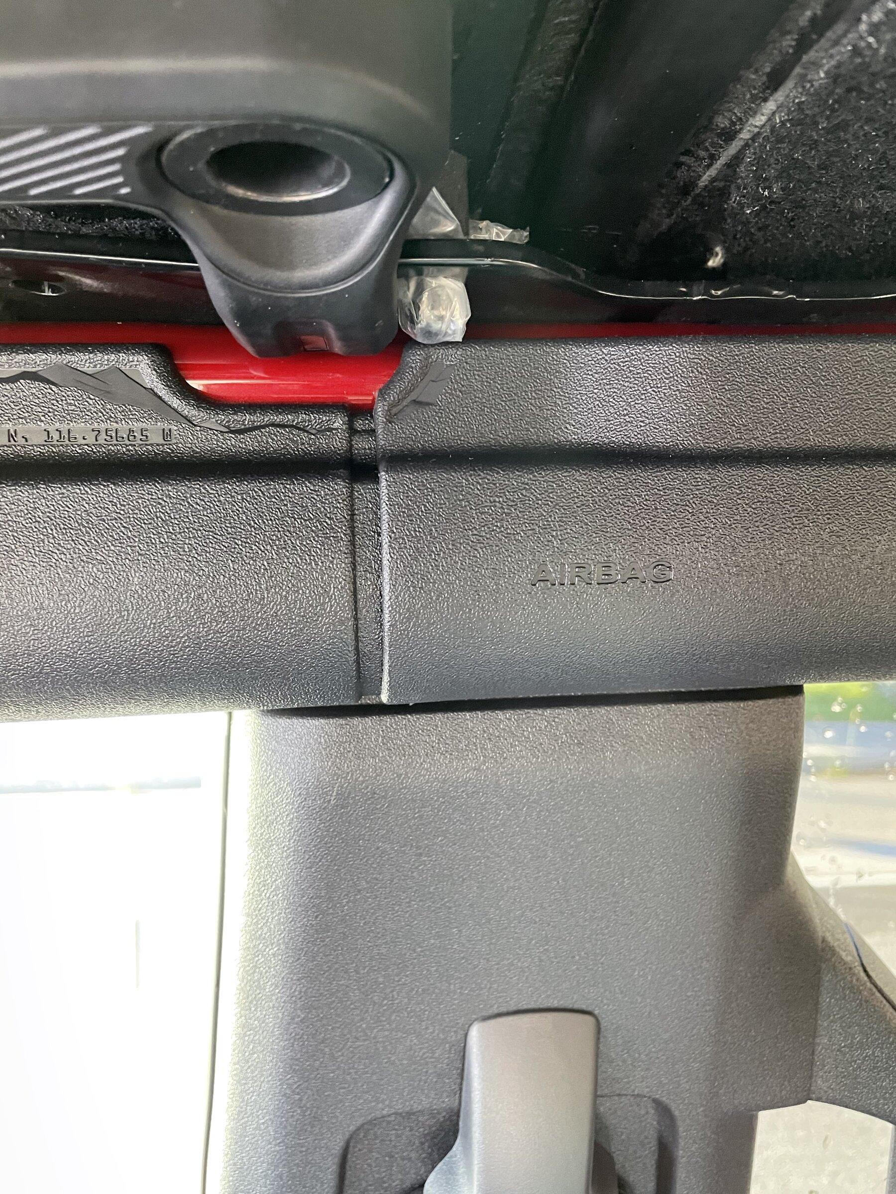

So what is needed are bronco condemns? :rolleyes: Thanks for the update. One less issue to worry about. I watched a video where they purchased a Besttop soft top to solve this problem. It is a father and son team that has a YouTube channel. To bad they didn't read this.
Yes, my first fix was condoms made from plastic wrapper. Worked great lol. As said, there are many ways you could fix this, I like simple and quick. I’m sure someone will come out with an aftermarket condom, especially after more of these rattly tops are out in the wild. I’ll keep using tape until then.

I tried simply loosening the latch just a tiny bit and found it pretty much eliminated the popping noise. I think the turn latch rubs against the guide pin as seen in your picture.
