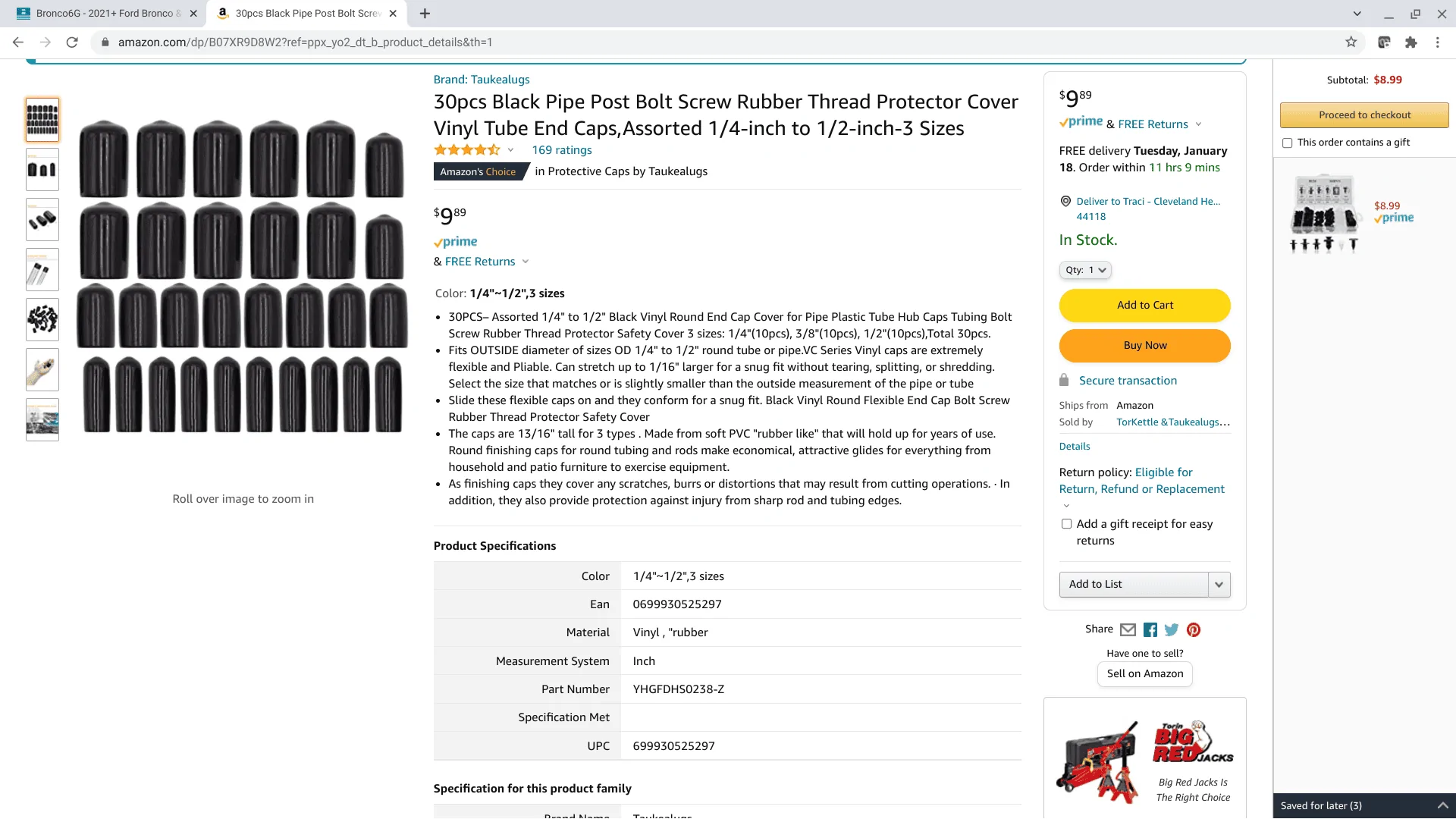

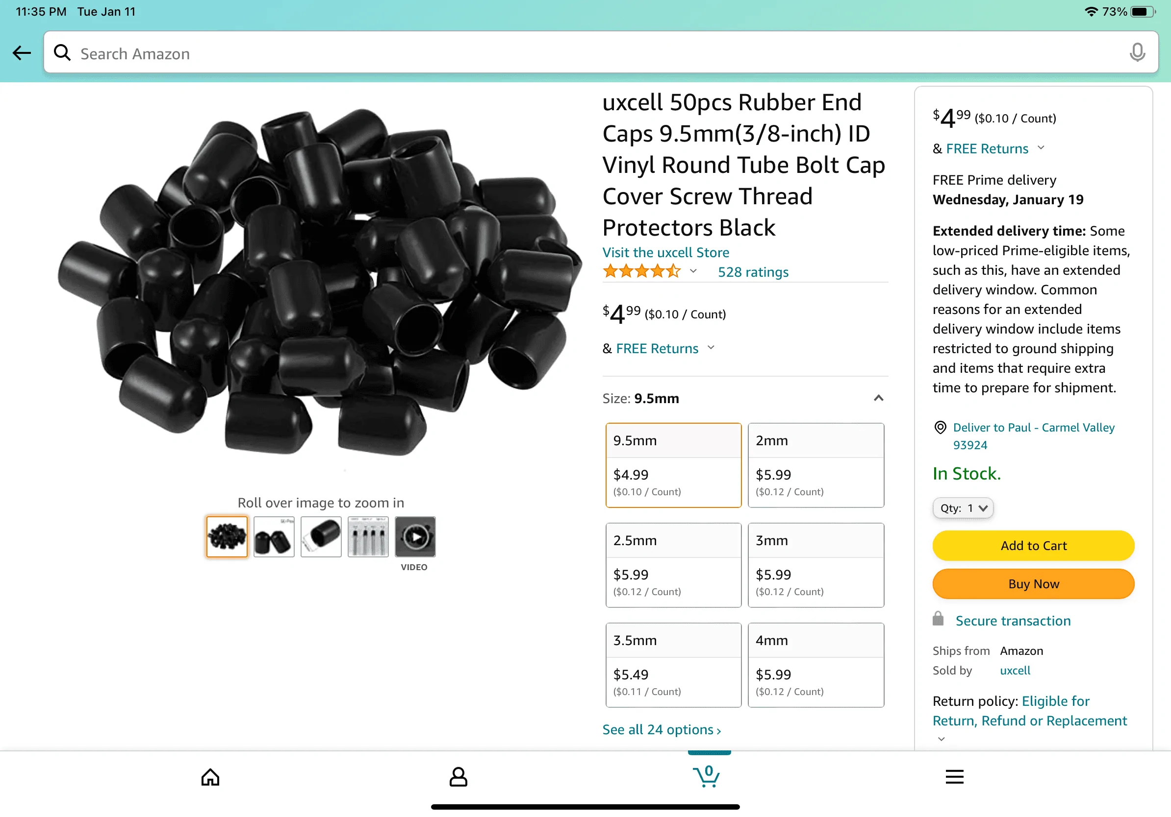

What’s the diameter and length of the pin? I don’t have my bronco yet to experiment with, but could you use a rubber cover cap like these over the pin?
Ford Bronco Solution for popping/rattling MIC top! CD04FE65-EF2A-4C3A-9482-CD6FD7B217A6

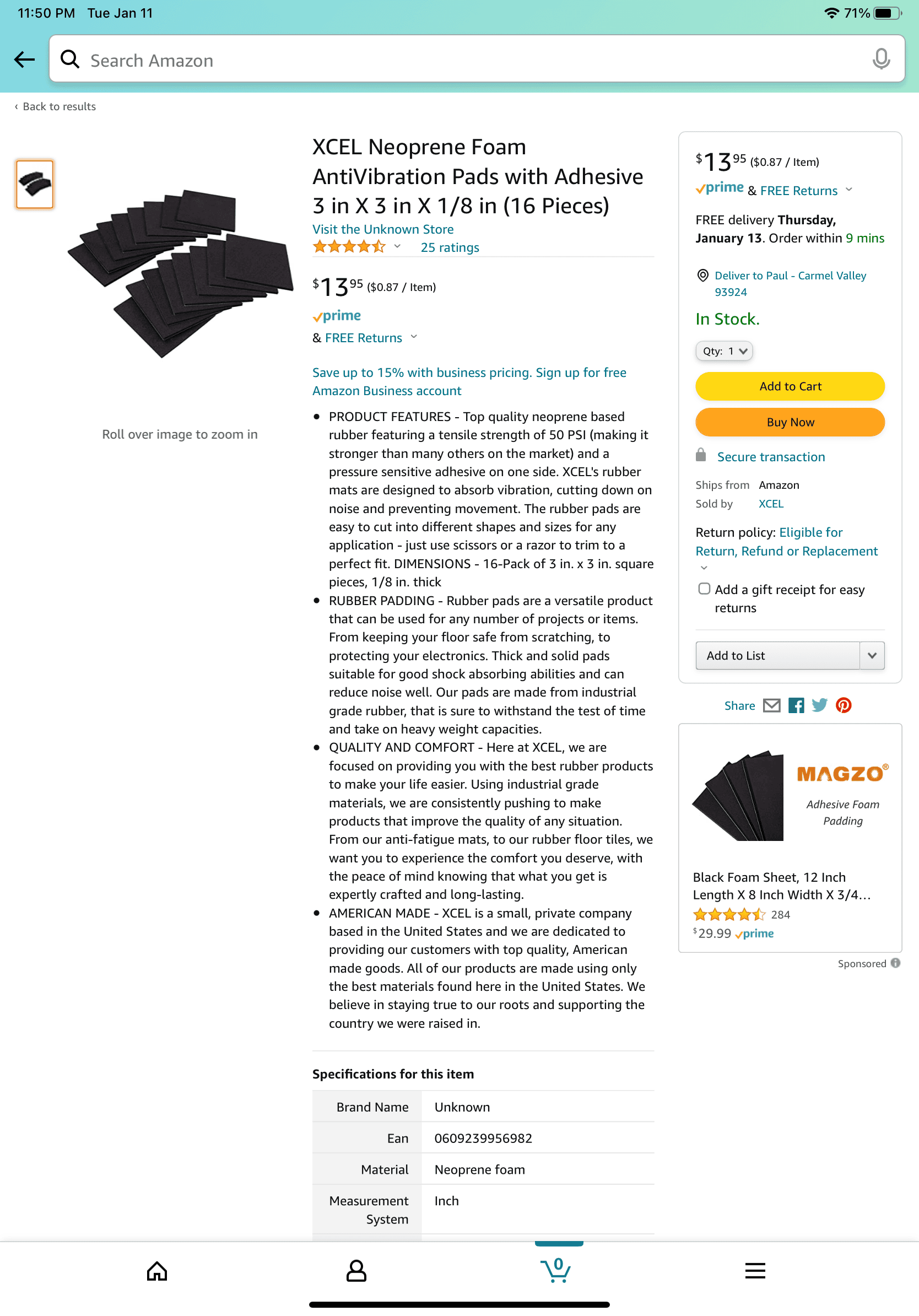

and then maybe get some adhesive backed foam and make little washers to stick down on the top side Out of sight?
Ford Bronco Solution for popping/rattling MIC top! 23A04297-74E4-4A59-9FF2-E6666010F8C2
The foam solution from the op sounds like it works great, but from the pics, it looks kinda ghetto. I’m just trying to figure out a more finished looking and permanent solution. If someone could give me the diameter and length of the pin and the diameter of the narrow point of the oval hole it sits in, I may be able to come up with something. I‘m a GC and I build cabinets, I’m always having to find professional looking solutions to problems like this. I’ve also got a huge catalog of random plastic/nylon parts that could possibly have just what we need. What I’m thinking is something shaped like an upside down top hat that would kind of be like a pin cover and washer in one. If we could find some kind of grommet like that with a nice, relatively tight fit over the pin that’s not too thick to still fit through the hole, you could attach it to the pin using two sided tape with some mineral spirits to get the part to slide on, then it will stay put after the mineral spirits dry…like regripping a golf club.

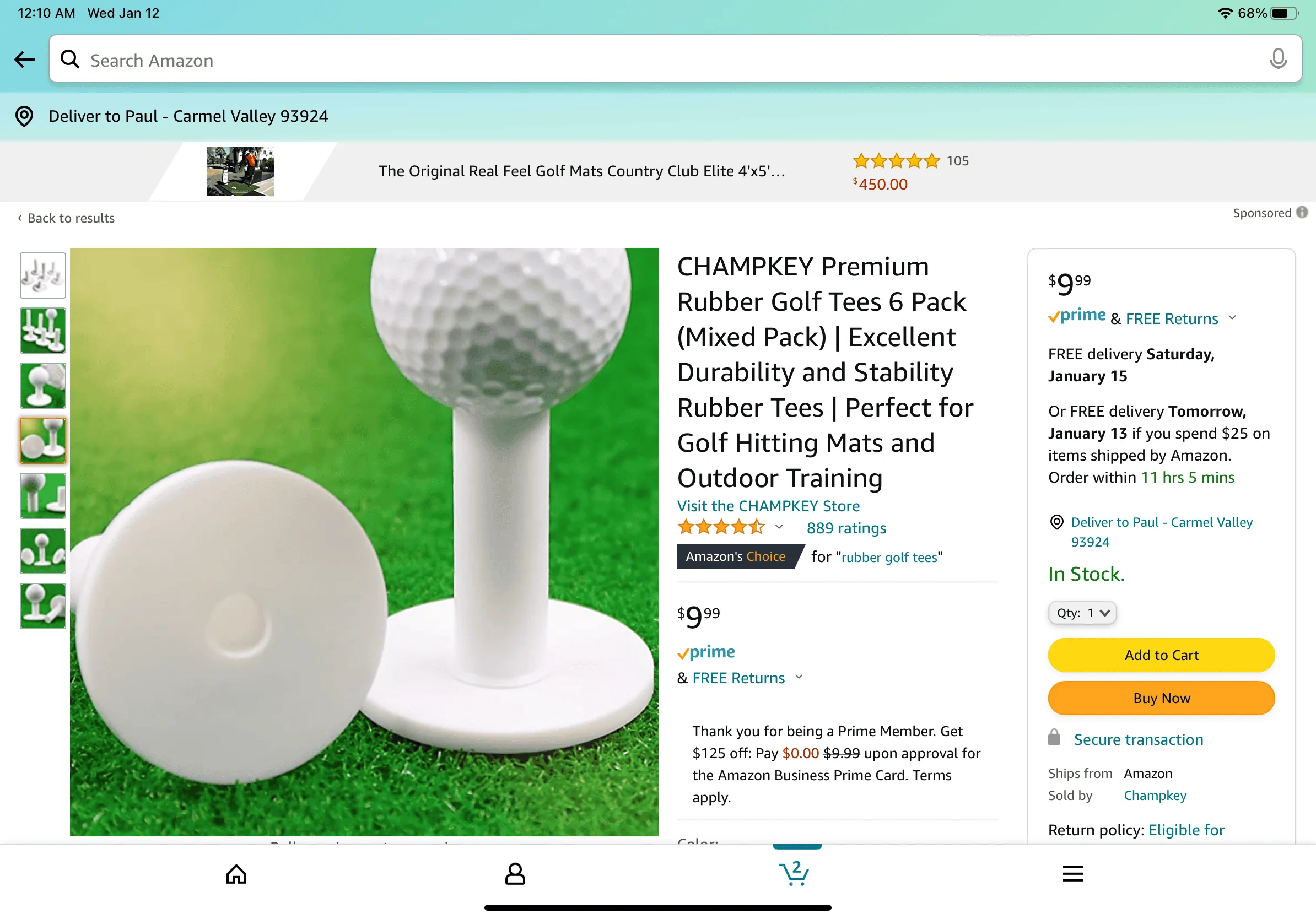

That just gave me another idea…what about those rubber golf tees for hitting off a mat? Like these. That would eliminate vibration whether it’s coming from the top, or inside the hole, and it could be cut down so it’s barely seen. Just a thought, I don’t know how much play there is between the stud and the hole.

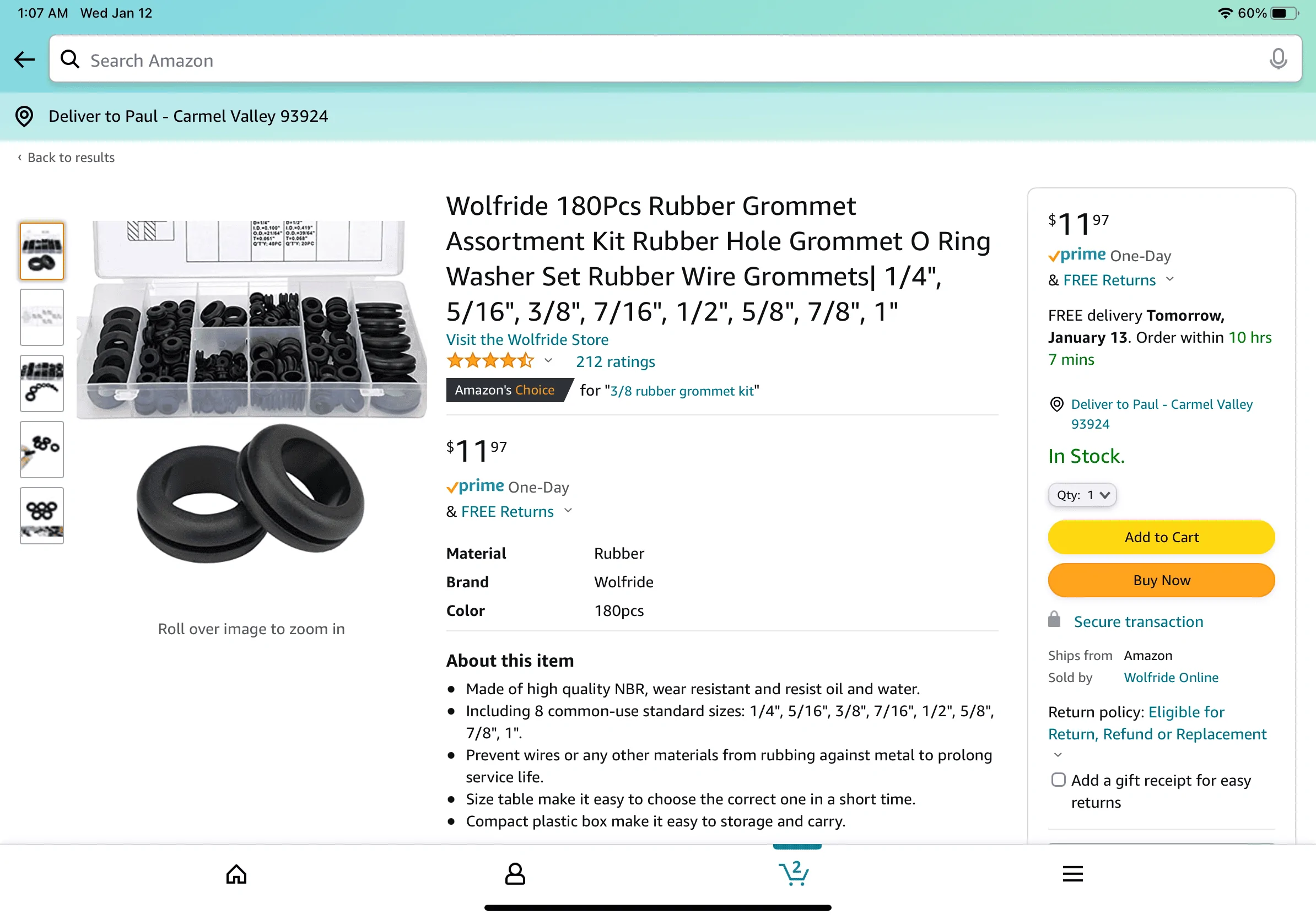

Anyone tried little o-ring grommets like this? Would they stay put?

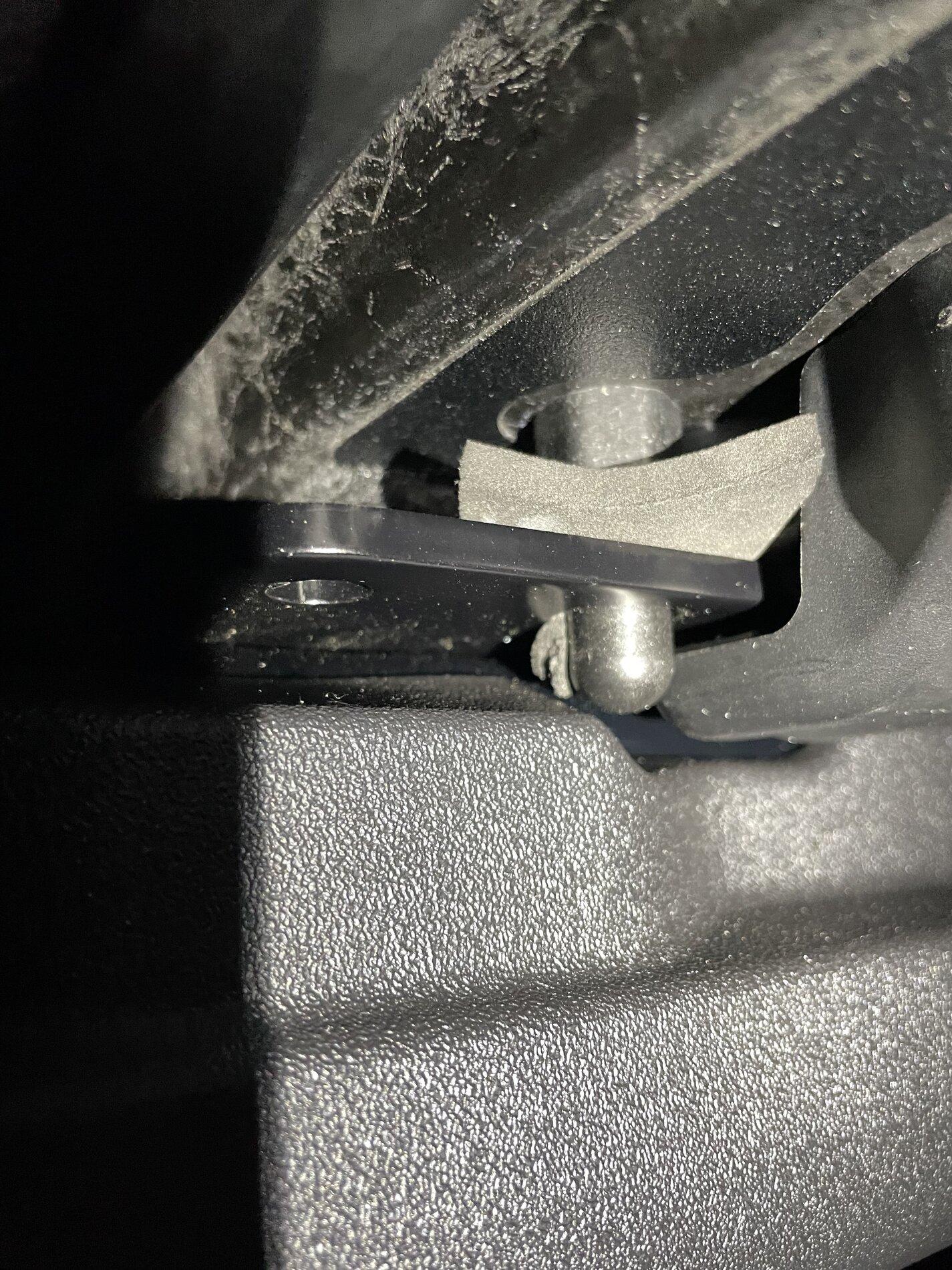

The two door loaner I’ve been driving with a MIC 1.0 top has an annoying popping/rattling sound coming from the latch area just above/behind the drivers head (also happens to a lesser degree on the passenger side as well.) Hard to know if this is the same bothersome sound experienced by others here, but I would imagine its not unique to only this vehicle.
I’ve narrowed down the source to the interface between the rounded off pin in the roof panel and the hole this fits into on the painted bracket attached to the frame. I took a one inch square piece of 1/8” thick EVA closed cell foam (aka craft foam) and after unlatching at all four points and lifting the section of the top, I placed it over the hole and under the pin. I then let the roof panel puncture the foam by latching the panel back down. The attached photo hopefully helps to explain. After doing this at both the driver and passenger side, the popping/rattling are completely gone. I’m not sure if the bit of foam protruding down into the hole is what fixed it, the portion of the foam that isn’t punctured, or a combination of the two. I will definitely be experimenting with this further.
Who knows how long this foam will hold up but I think it’s a good starting place for finding a permanent solution to this problem. I’d be interested to know if this is something that has been addressed with the MIC 2.0.
Hopefully someone finds this useful.
UPDATE: 11/20 I’ve utilized this method to eliminate the MIC noise in two different Broncos, including my own. I’ve removed the roof panels and re-installed the original foam pieces when re-installing five or six times now and still having no rattles or pops coming from the top. As easy as it is to just hold on to the foam pieces and re-install and as well as it works, I’m fine with this being the long term solution at this point. I may try experimenting with using some heavy duty 3M double sided tape to permanently attach the foam.

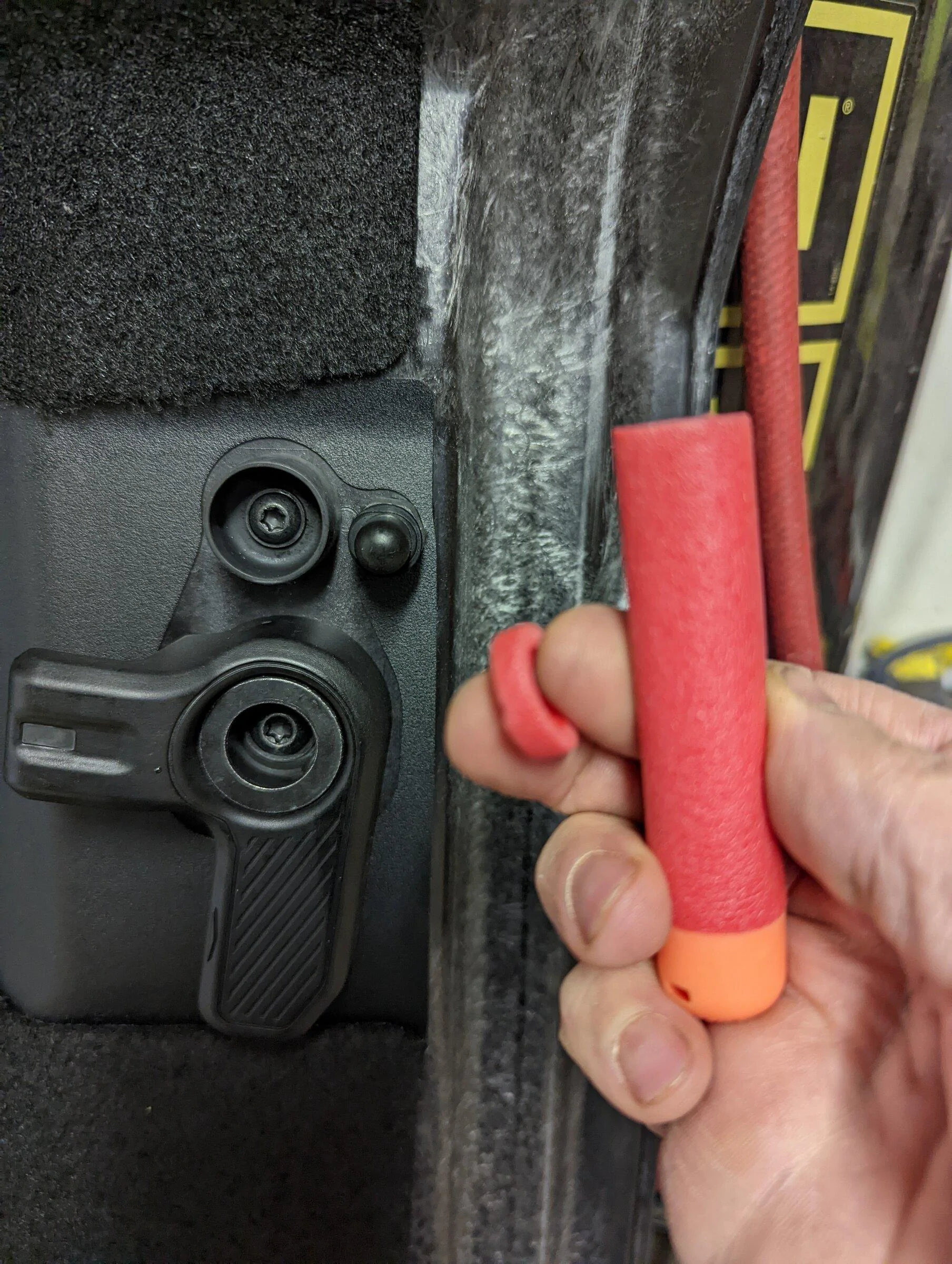

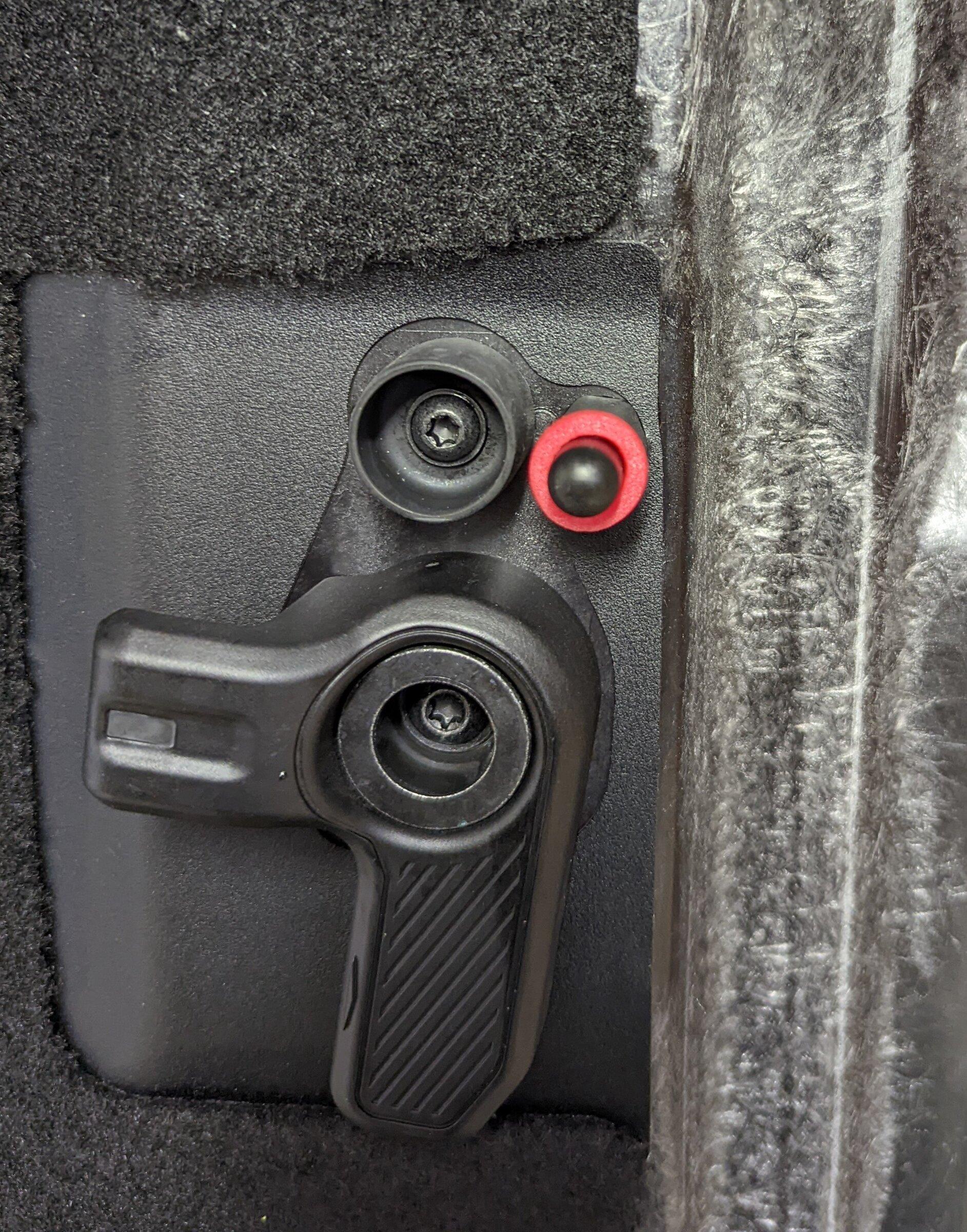

Thanks for posting OP. I simplified your idea a bit using a trimmed "Mega" Nerf dart and I've been happy with the results so far. Who knew having three young boys and a Nerf arsenal could pay off?
EDIT: 500 miles later and still quiet.
