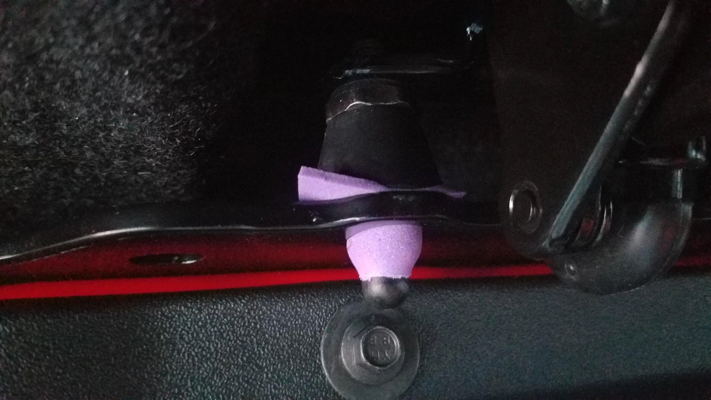

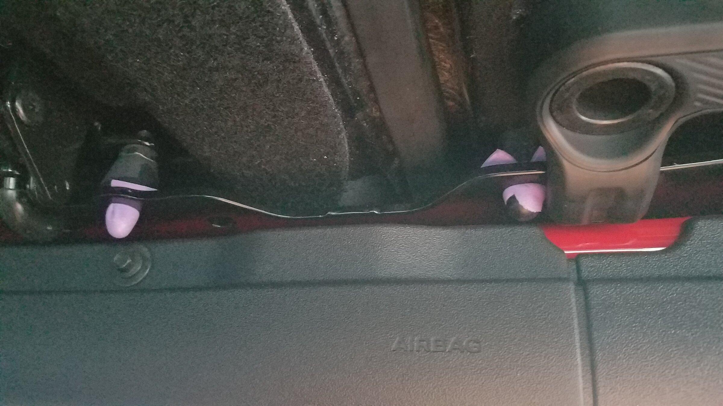

I bought a rainbow pack of 2mm thick craft foam. For $5, I have enough for a lifetime for this task. Other than filling the pin hole, it squishes down to nothing. I'm sure it wont have an impact on the seal, though I'll comment again if I see anything.
I used the purple foam to make it easier to see what the foam is doing.

Great idea with the contrasting foam color to show others how this works.
