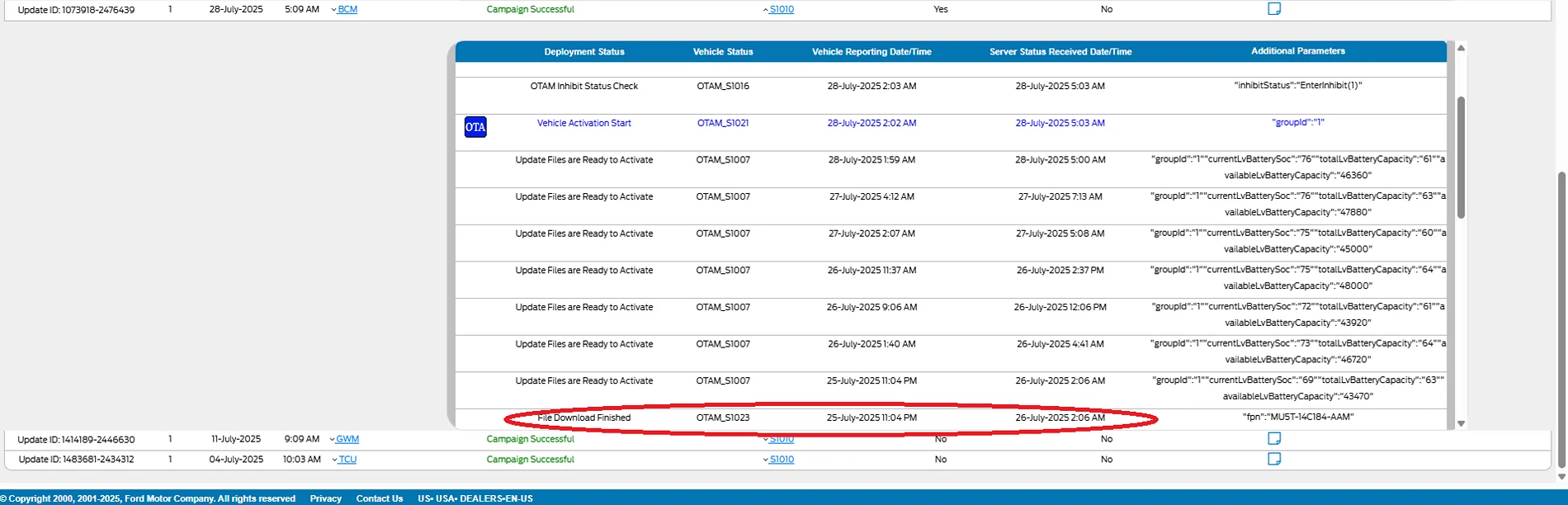

I can tell you that the servers OTA's work on and the FDRS servers are different. Also, auto-updates is only to install the update if it requires the vehicle to be inhibited after the files are downloaded. By the time auto-updates installs (or tries to install) the update, the files are already off the cloud.
See screenshot from a random vehicle's OTA dashboard below. In this case, the files were downloaded and ready 3 days before the OTA actually installed. You can see the vehicle reporting the battery data to the cloud over the course of a few days before eventually the OTA trigger puts the vehicle in inhibit mode to install it in the middle of the night.
