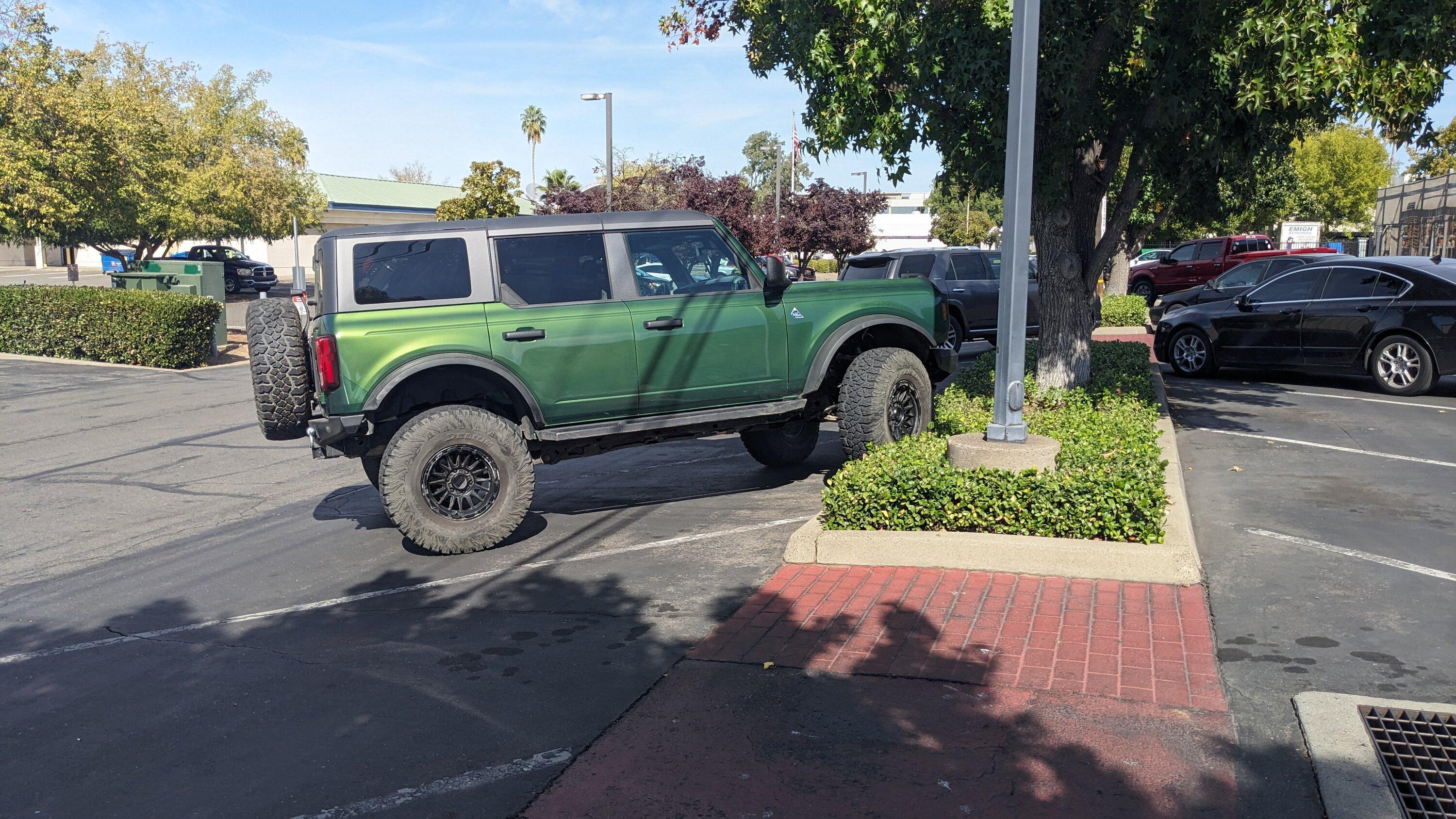

Pissing off the old guy at Ace Hardware. He runs the back of the store and always makes comments(he has a Wrangler). So I always park on a curb or back in the wrong way.

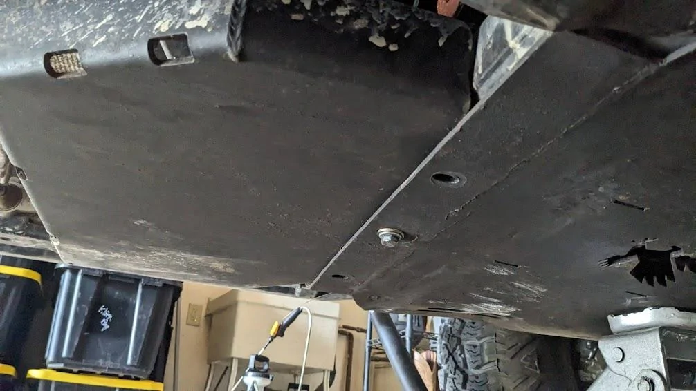

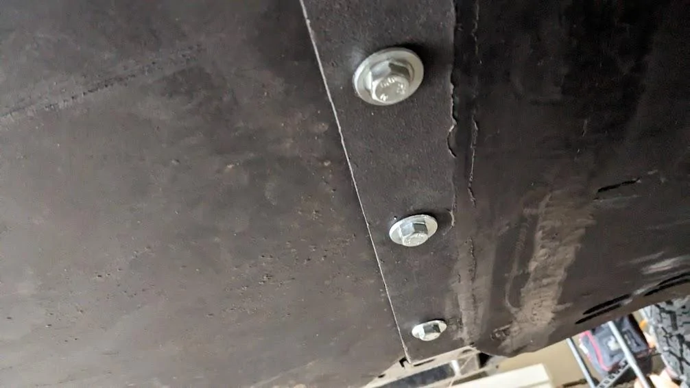

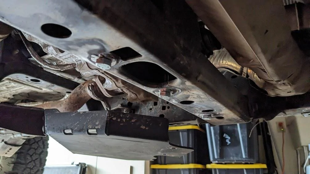

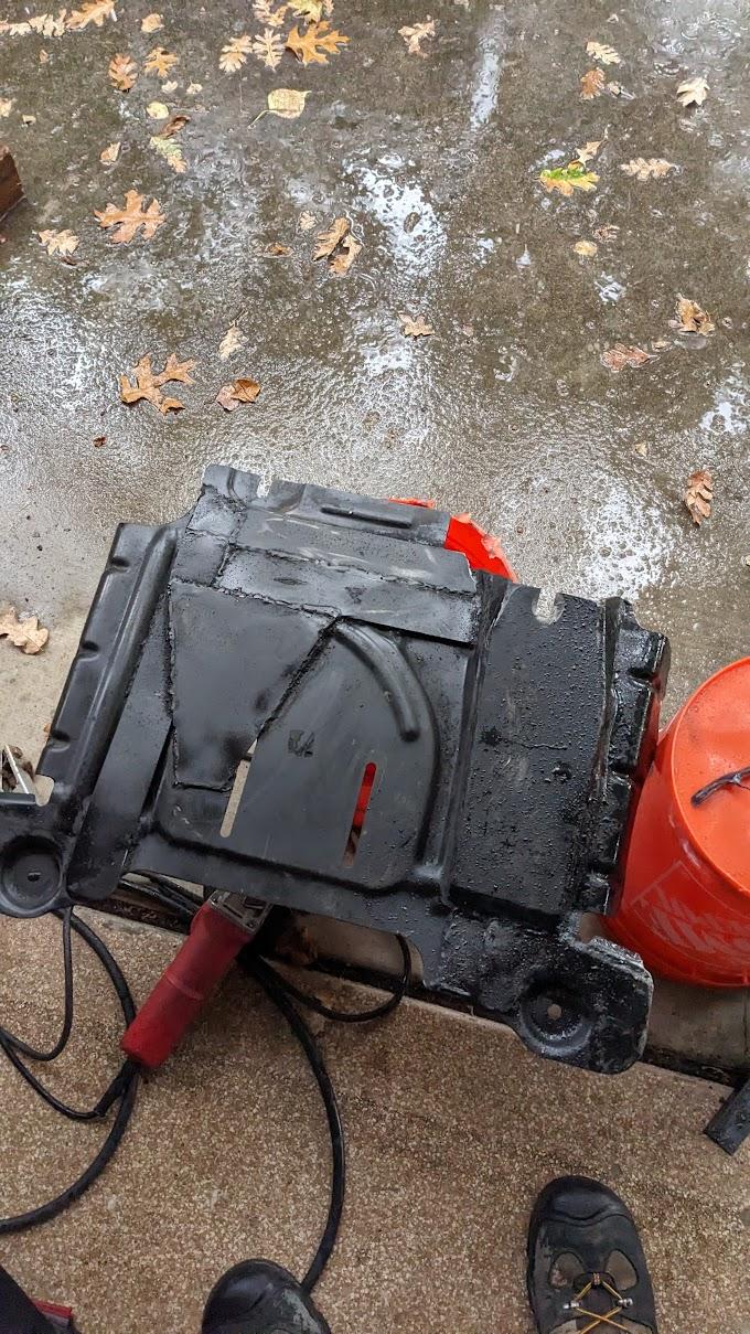

Today was fix all the broken/stripped skid plate mounting nuts. Took about 3 hours to drill out and weld in 5 new nuts. Then I spent an hour plating and booger welding my differential skid up. Took a bit of work to hammer it back into shape and add some steel.
Down to the last bolt lol.
Ford Bronco Snacktime's Broken Bronco Build PC7THdEveDwpUBgpsd10=w1006-h566-s-no-gm?authuser=0

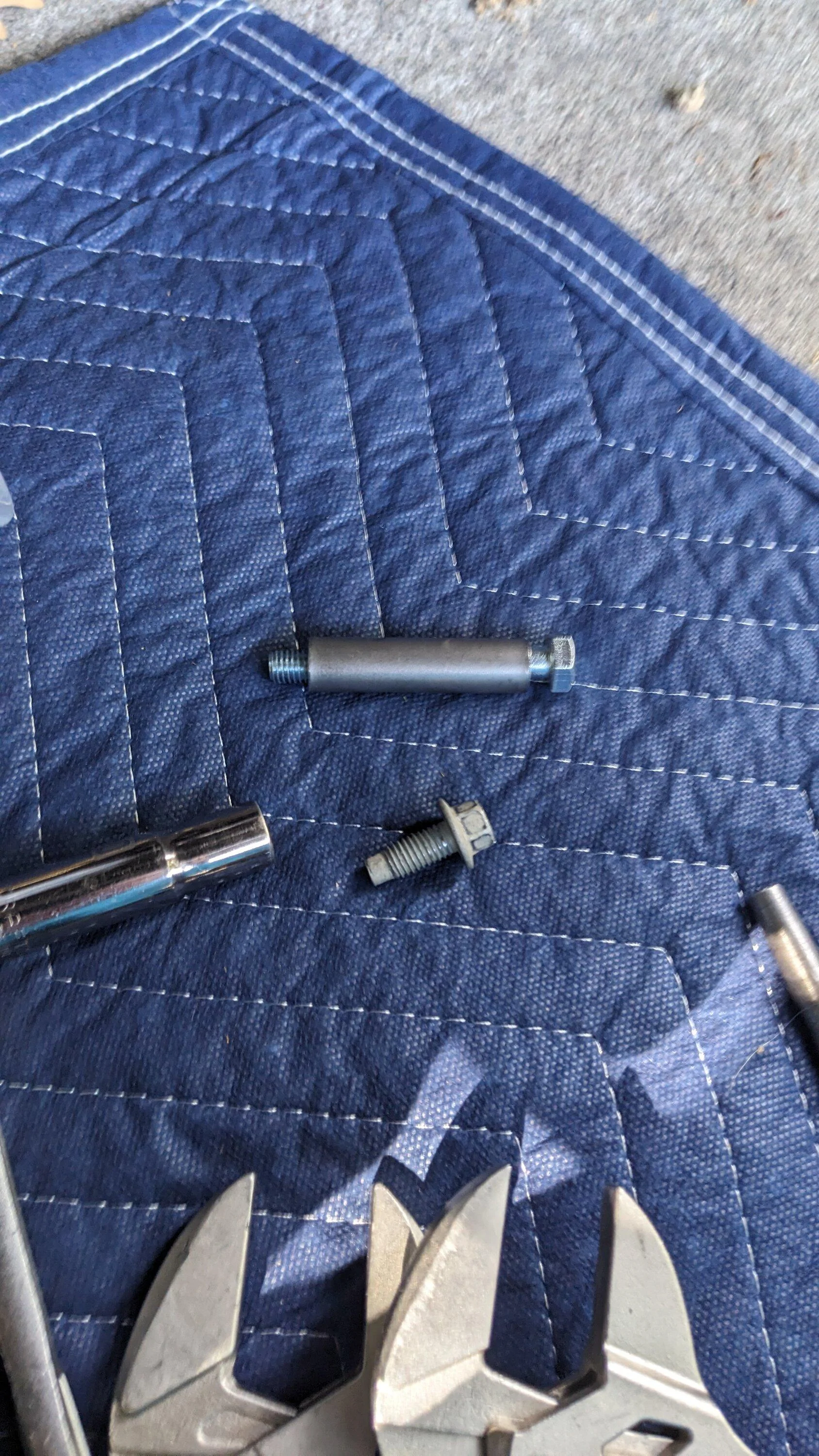

After drilling them out with a uni-bit.
Ford Bronco Snacktime's Broken Bronco Build NP9ZcWnKHCSHh3x11ucA=w1006-h566-s-no-gm?authuser=0

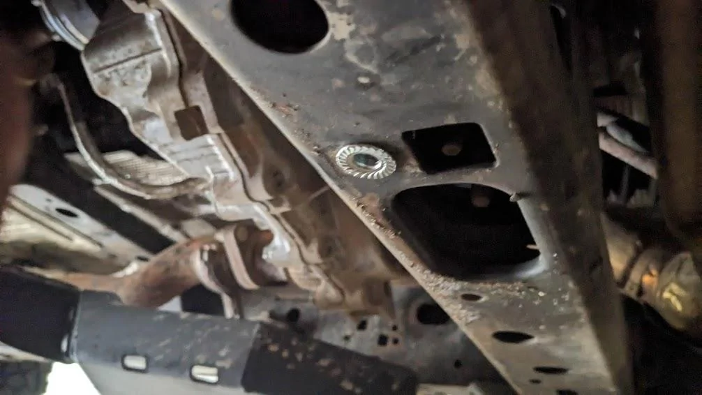

More booger welding
Ford Bronco Snacktime's Broken Bronco Build HC-c2f0R-1EEMrQxIHmw=w1006-h566-s-no-gm?authuser=0
Fixed
Ford Bronco Snacktime's Broken Bronco Build yD8u7wW05WQsbJC0BiRk=w1006-h566-s-no-gm?authuser=0

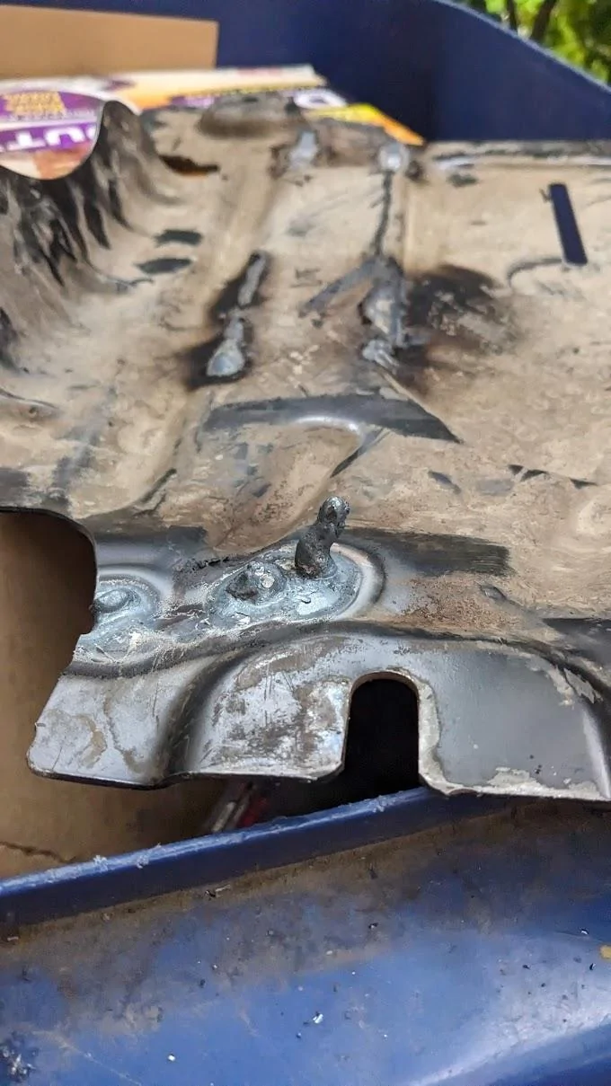

My best work of the day
Ford Bronco Snacktime's Broken Bronco Build qT1j1KAfPBmE-bH5z2Fg=w680-h1209-s-no-gm?authuser=0
Just welded some scrap on and weld up a few cracks that formed from playing patty cake with rocks.
Ford Bronco Snacktime's Broken Bronco Build dOzcfUzaLZEdwnSRMsC4=w680-h1209-s-no-gm?authuser=0
