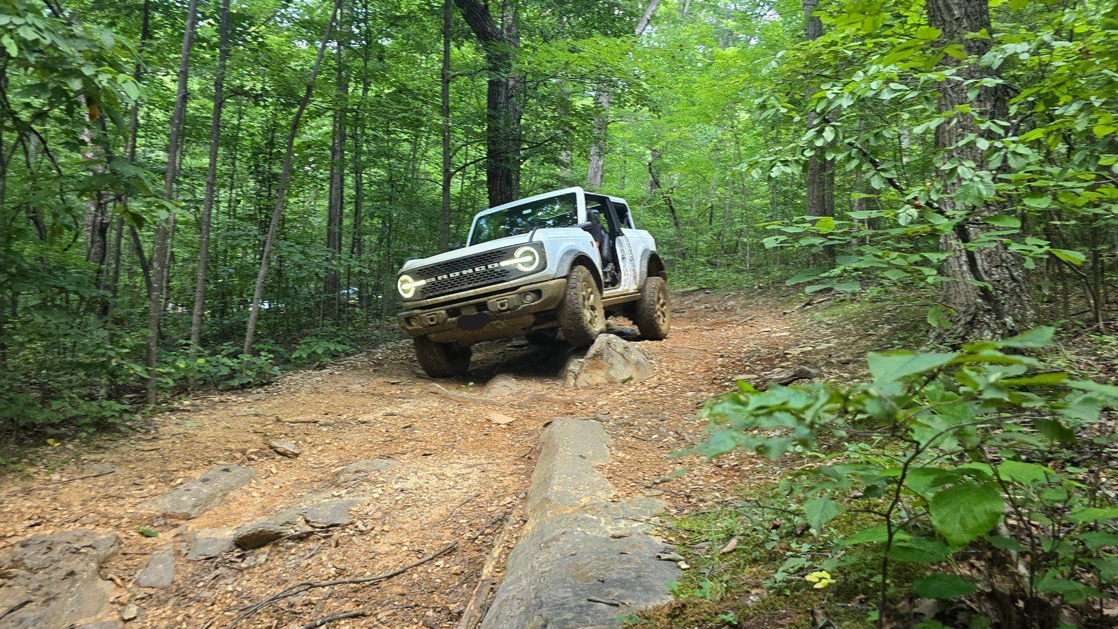

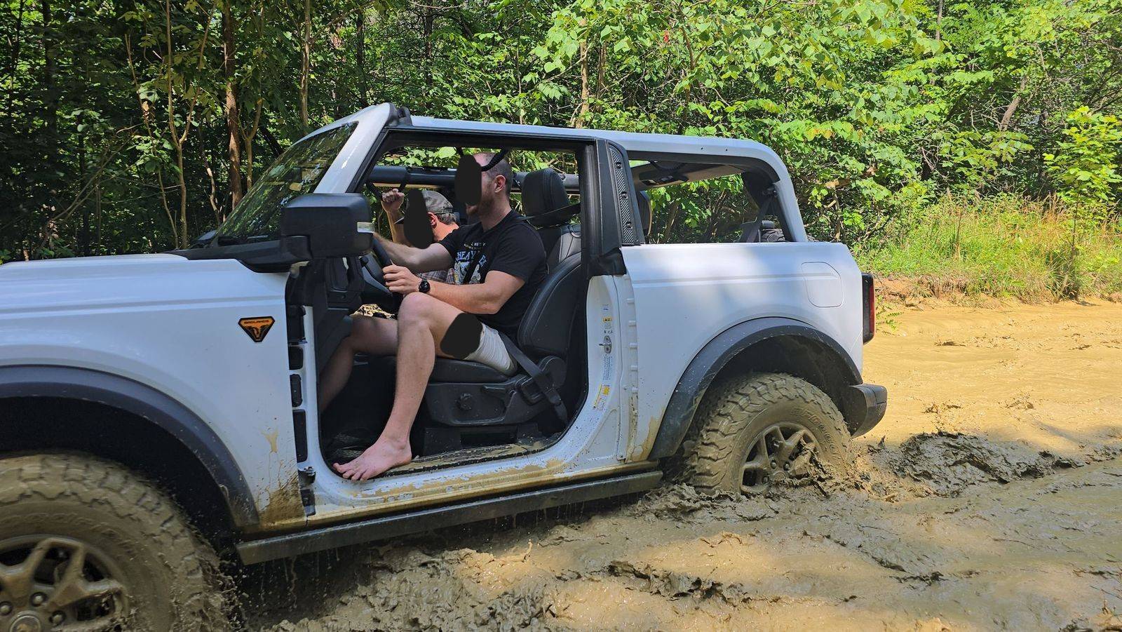

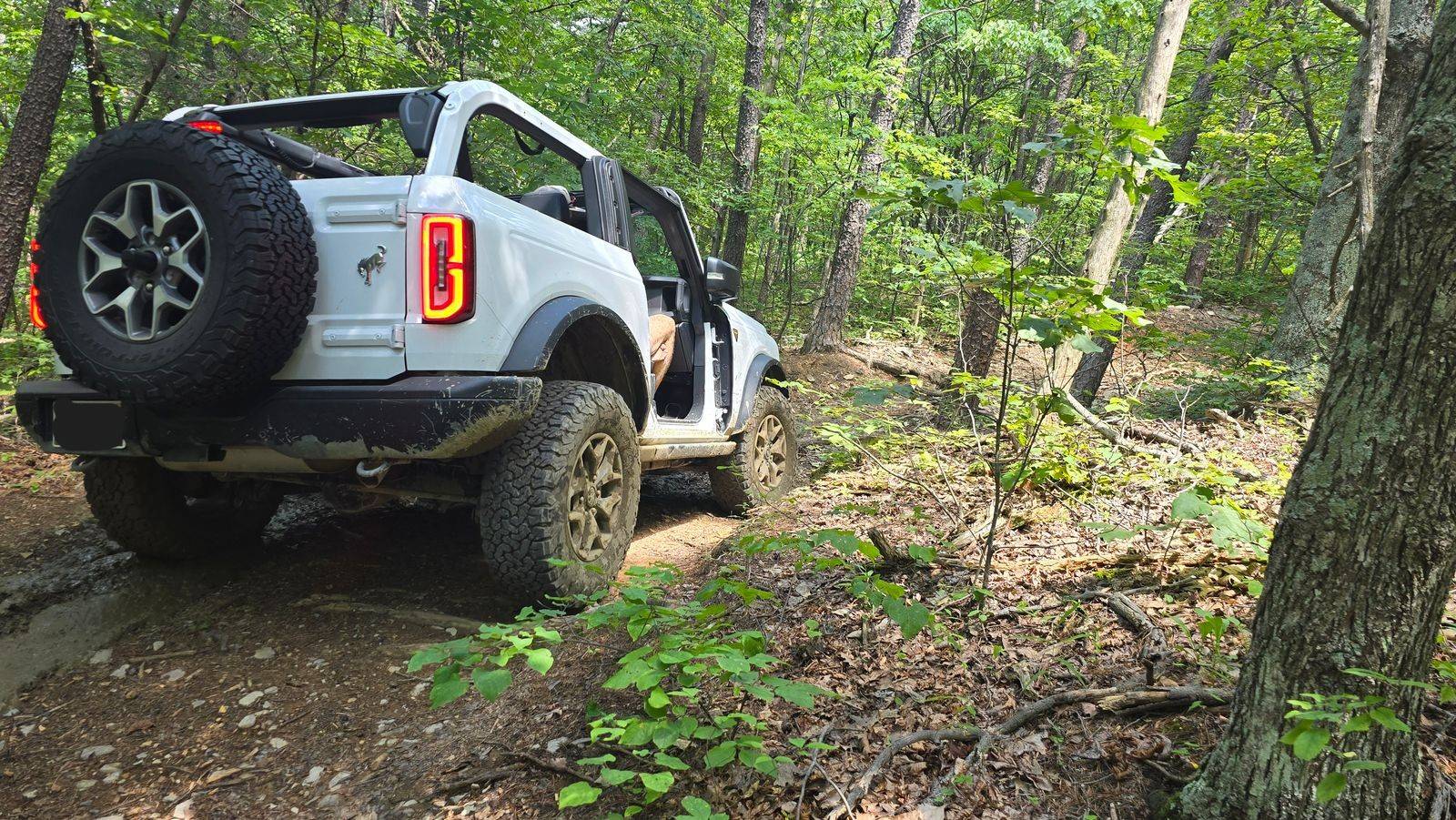

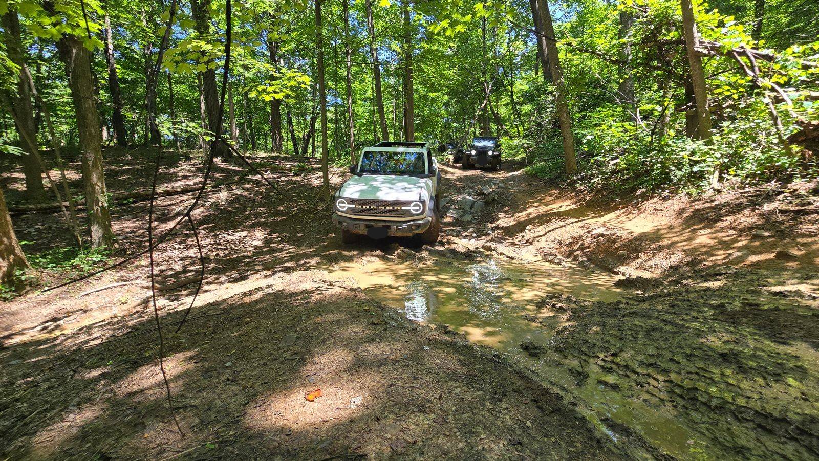

To sweeten the deal:
Here are some pictures from my first outing in the stock 2025 Badlands (non-Sasquatch). I was very impressed with the capabilities despite of the Bronco in stock form. Most features (save the Trail Turn Assist) proved extremely useful and worked flawlessly.
The deepest hole came over the hood and we experienced no issues from the vehicle until we hit an extremely steep climb after a washout / mud hole. The Bronco coughed out a cloud of white smoke after being fuel starved, then we were back to the races after the turbo kicked in and we got spooled up.
Cleanup wasn't too bad, either, due to the drain plugs and water resistance of the interior. Took a pressure washer on low settings to everything and it dried out in a jiffy! :D
Let me know if anyone has any questions regarding performance or off-road behaviors.
