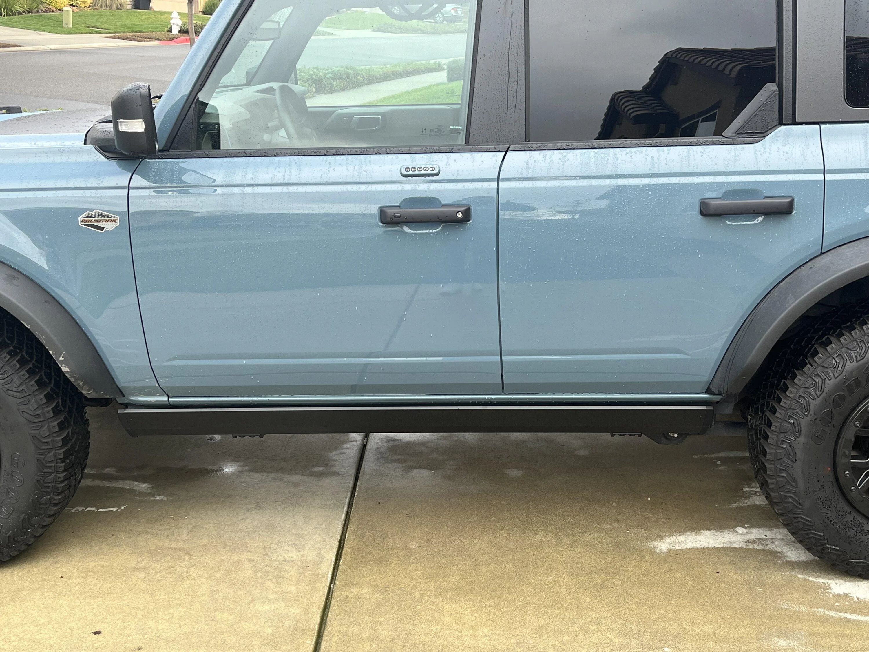

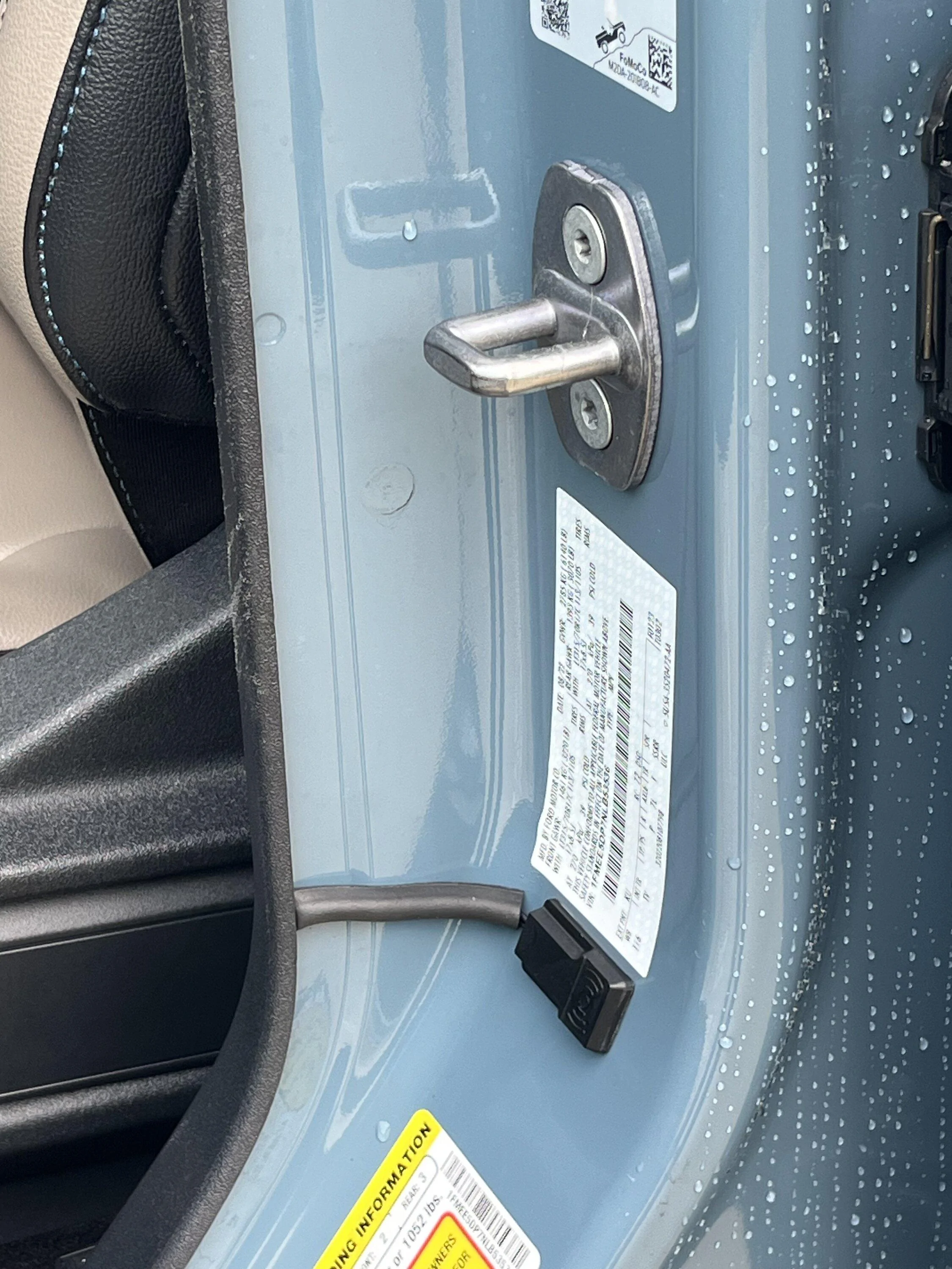

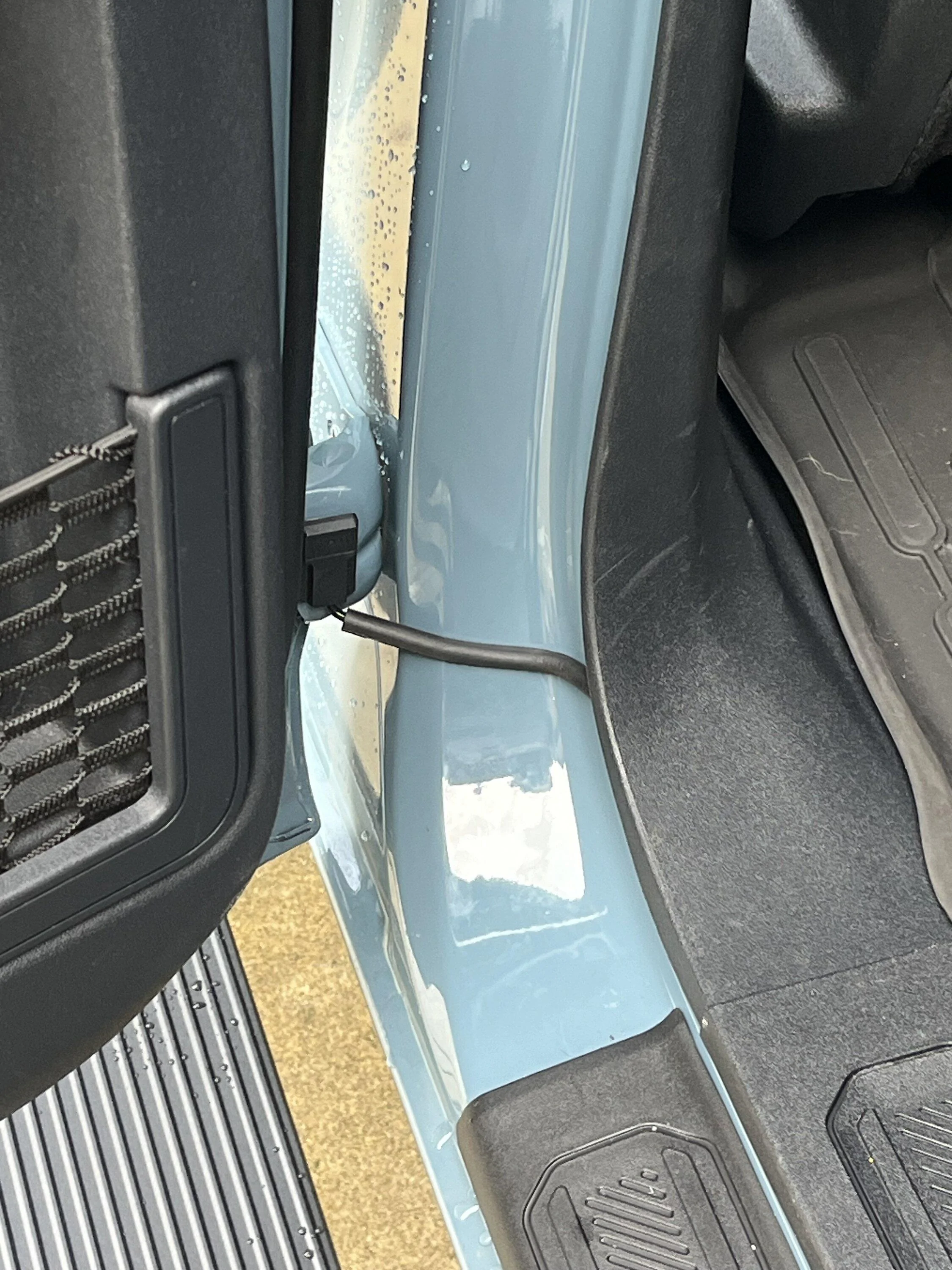

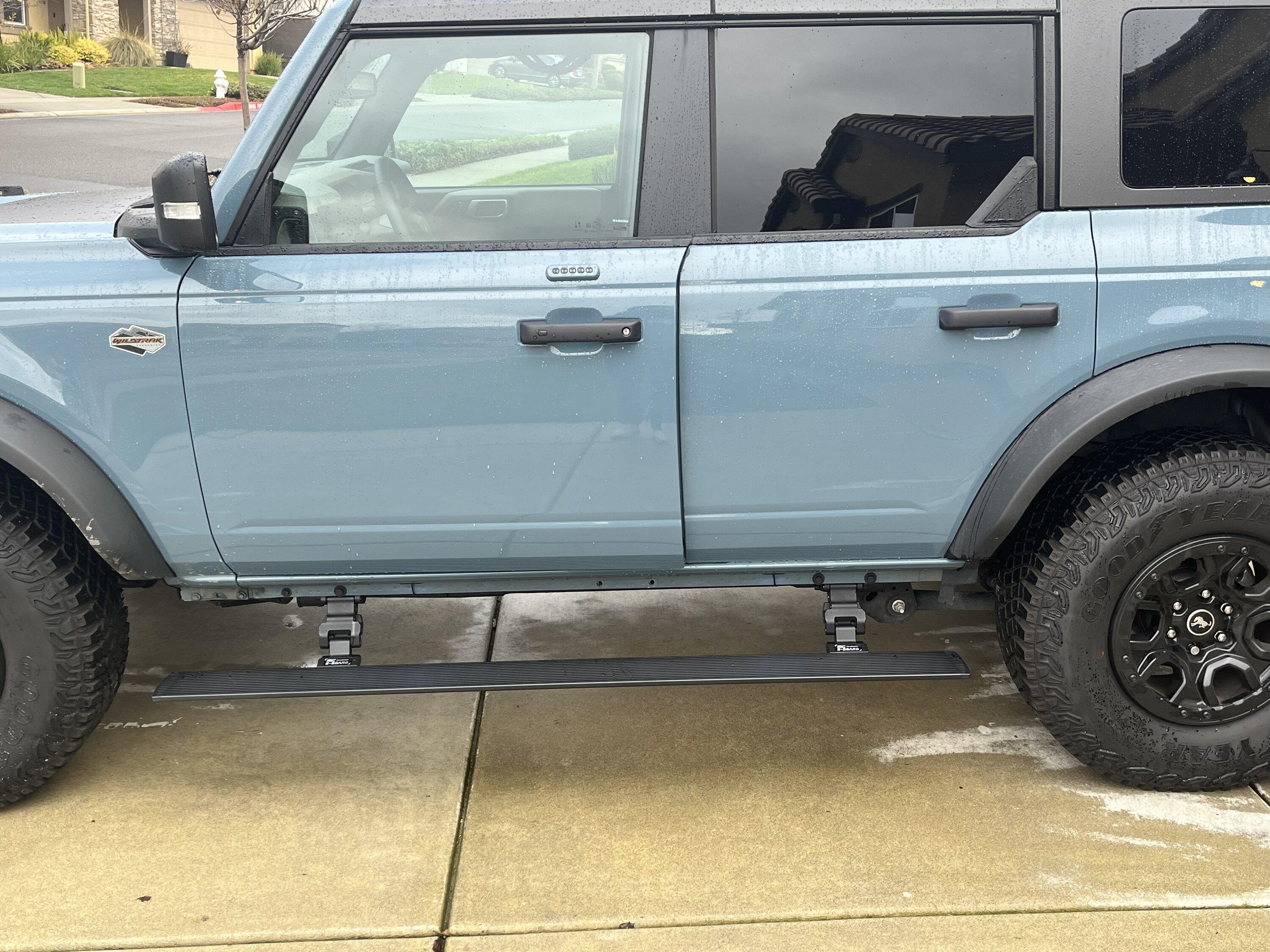

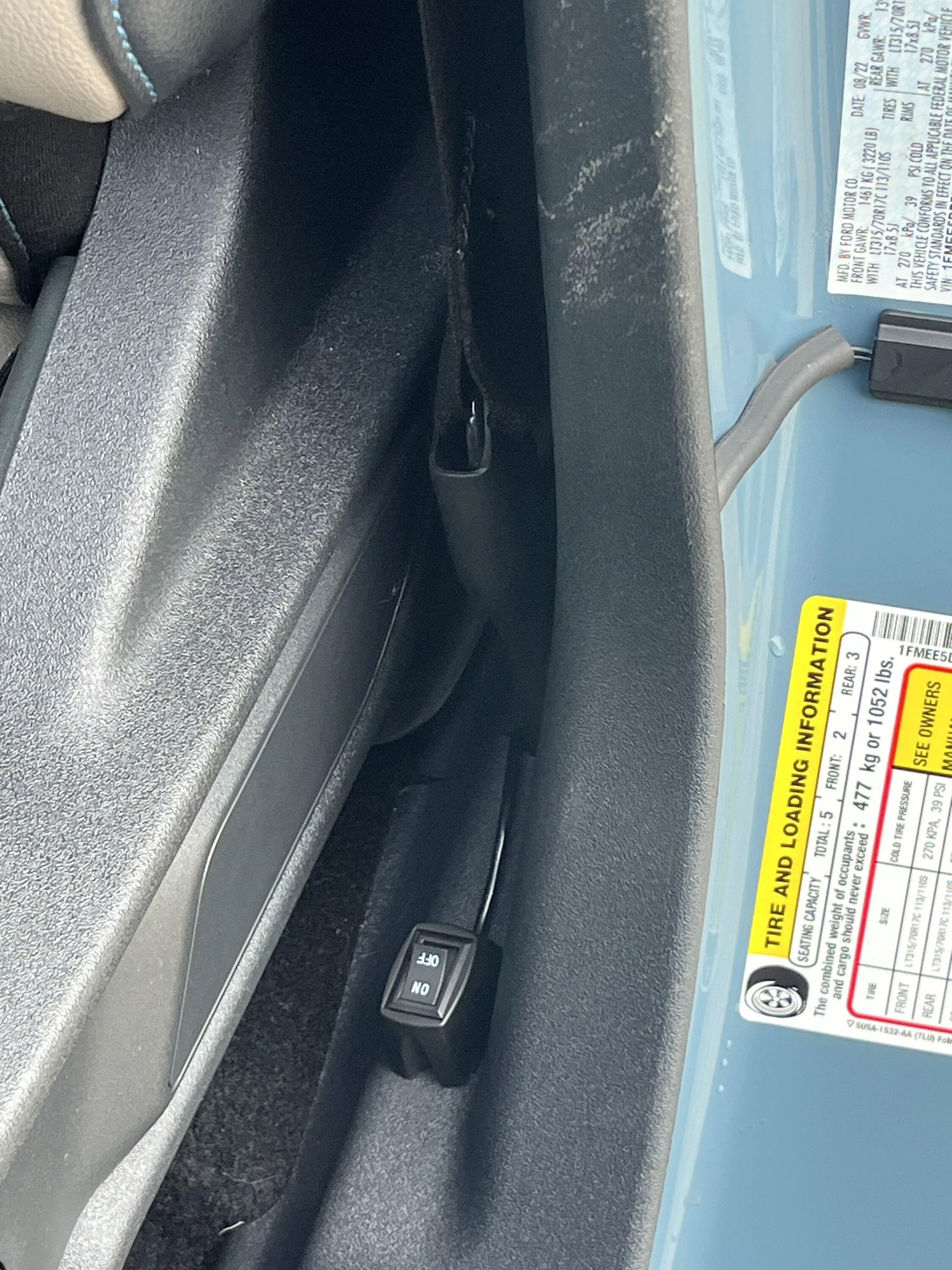

Installed the rough country power steps. Basically the "go rhino" ones re branded at just over $900 for set. I have gone with amp in the past on my trucks but decided to go this route this time. The install is very straight forward thanks to a YouTube video. The magnet alignment wasn't too bad and the exposed wiring doesn't bother me. I also like the included on/off switch if I ever take off my doors.

Did you put the sensors and magnets under the hinges or on the latch side like the fronts? I positioned them like the fronts because I saw someone in one of the video comments say there isn't enough clearance on his truck to do it the way the instructions say.

I installed the sensors for the rear door by the striker (similar to the front) and they have worked flawlessly for the past year+
