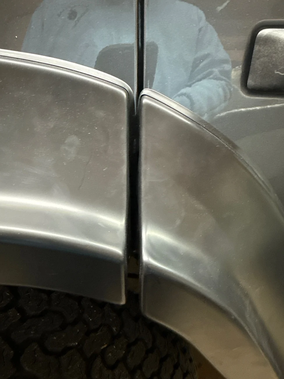

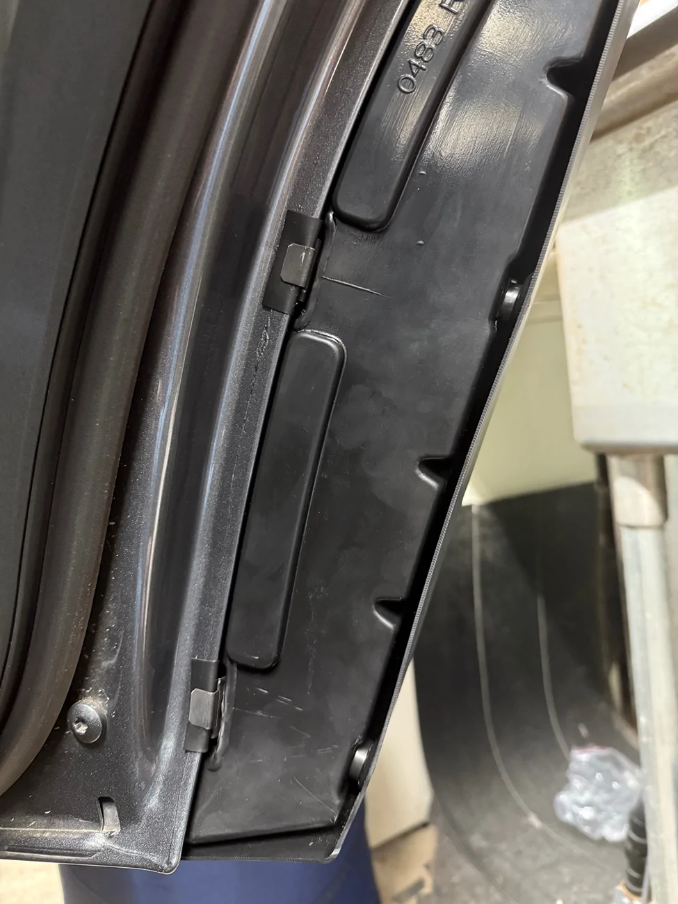

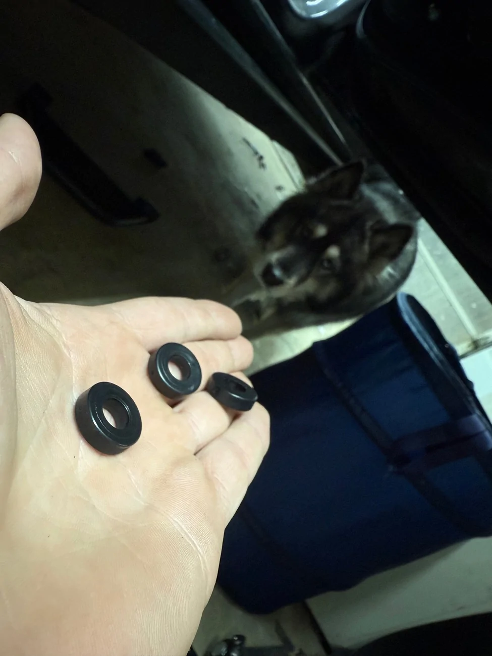

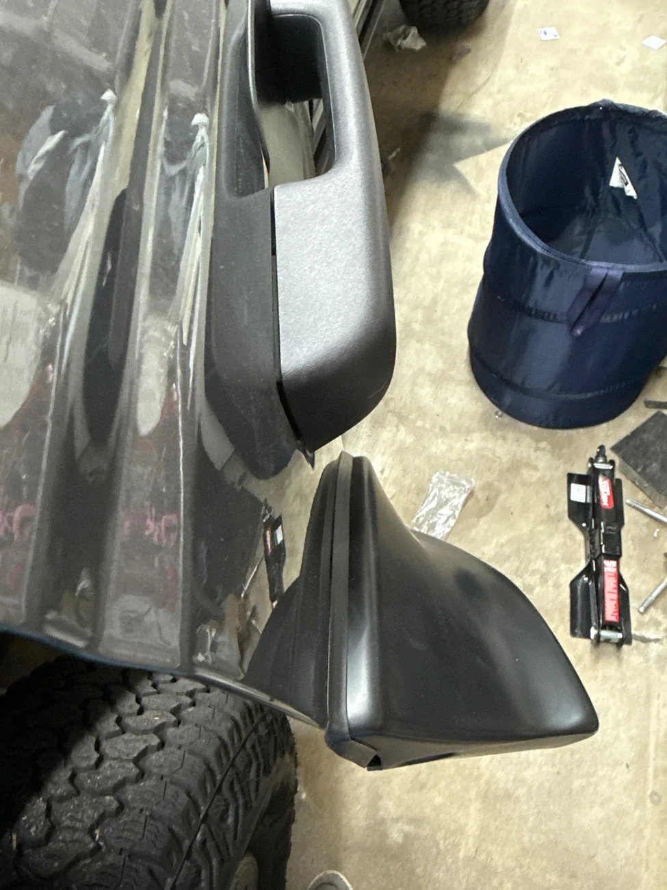

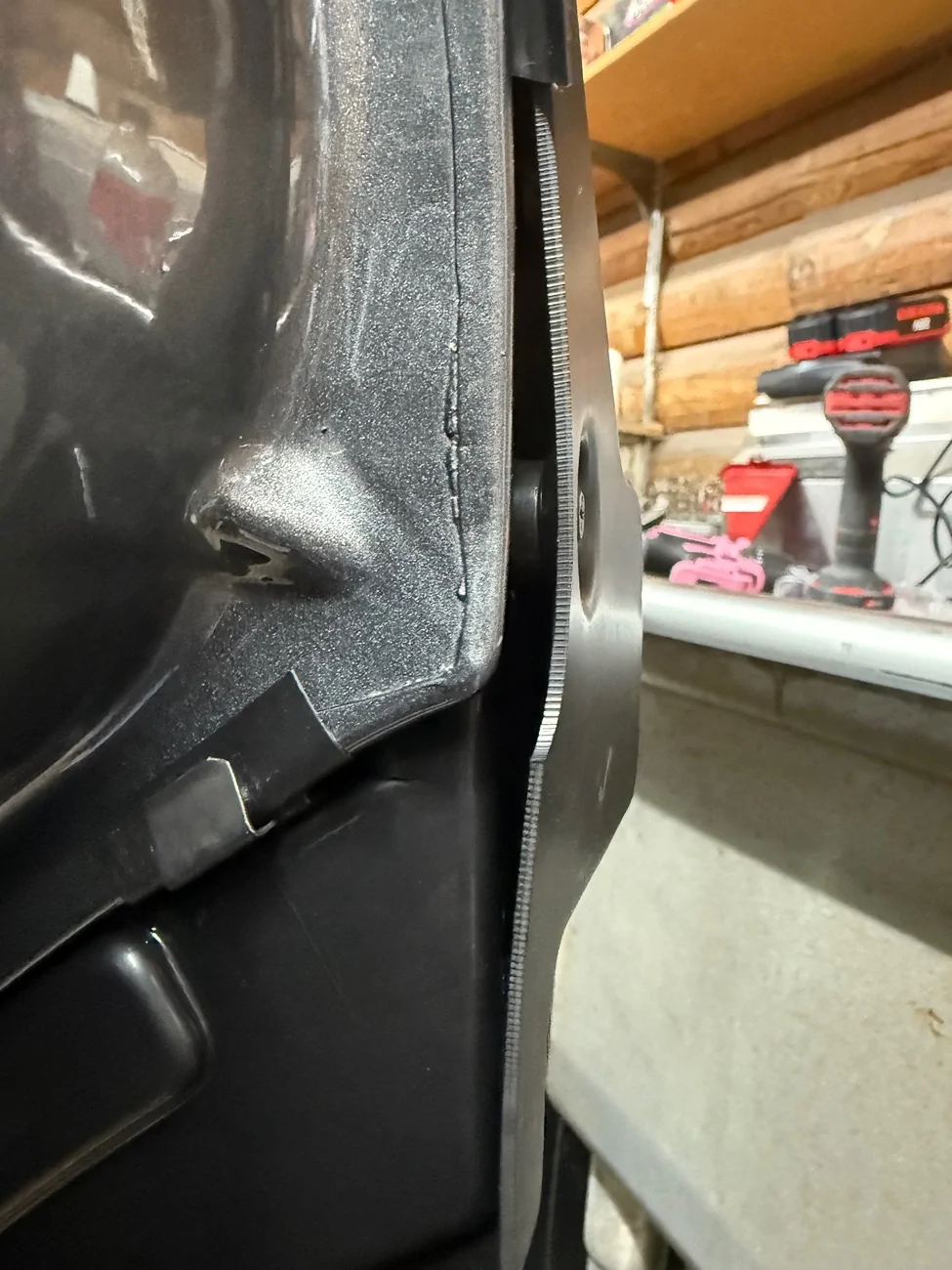

I dig it. I plan to keep em on til the wind rips em off, if not I’m gonna repaint the bumpers and fenders to match. The main complication is the rear door pieces. They heavily rely on the 3 pressure clips precise location for proper alignment. You can see in two of the pics. I got the left side done but I’m on day two of the right side alignment. If you got rock rails under you’re gonna have to remove em or cut em back sum. Also DO NOT LOSE ANY HARDWARE. its exact quantity.
To help mitigate the atrocious gap from the poor rear door fender design, I added spacers from extra tv mount hardware. You gotta install all them loosely and tuck the panel up on the door bracket and screw em all evenly with pressure on that lip. It miss aligns but ain’t noticeable from afar.

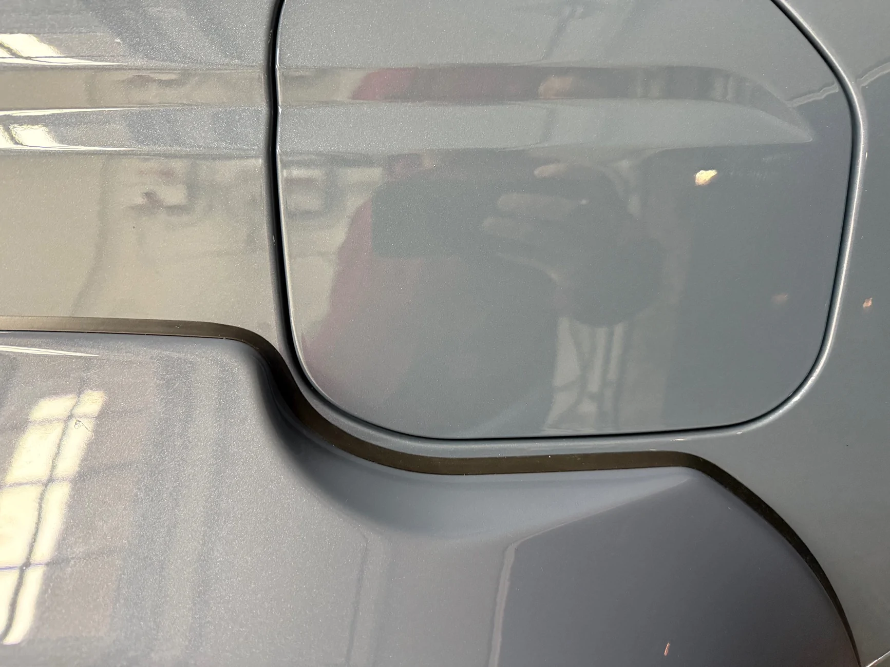

Here’s a picture in decent light. The paint match is even better in real life.

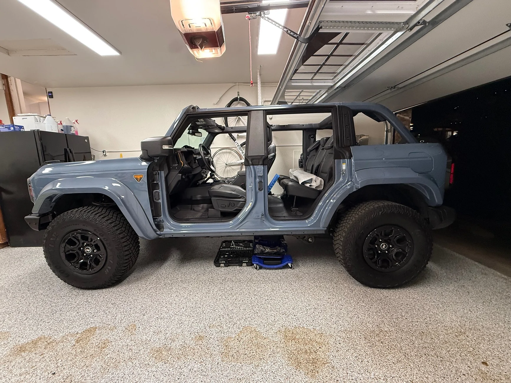

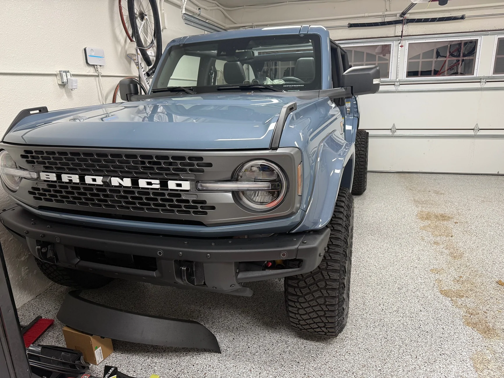

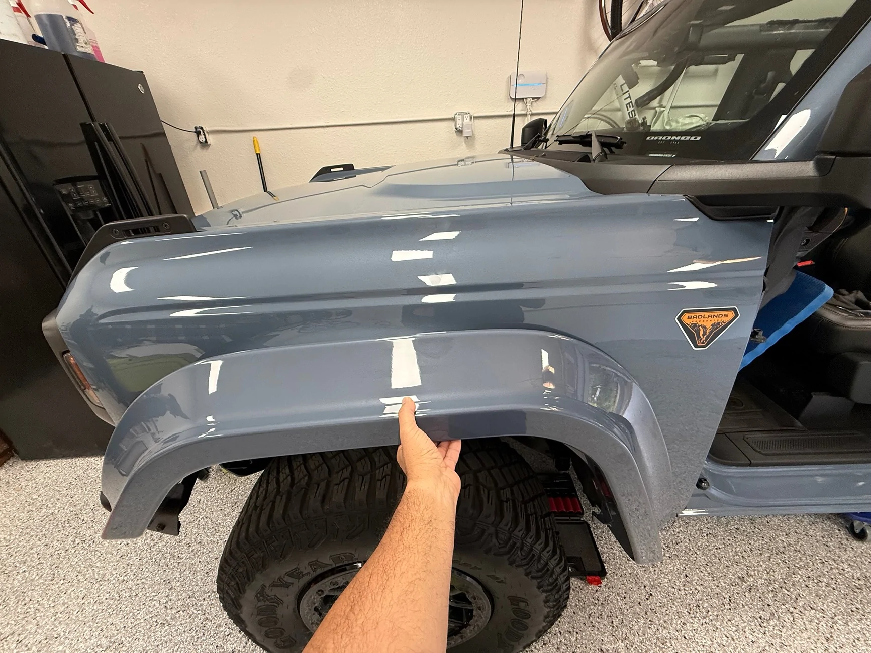

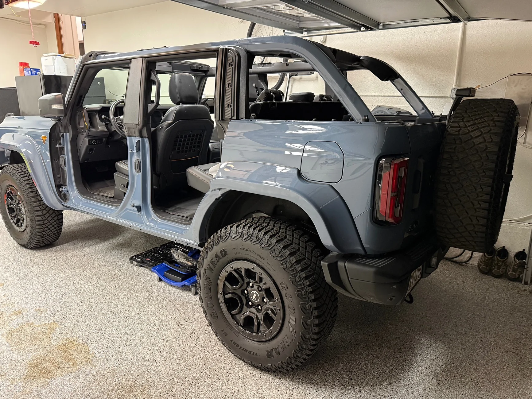

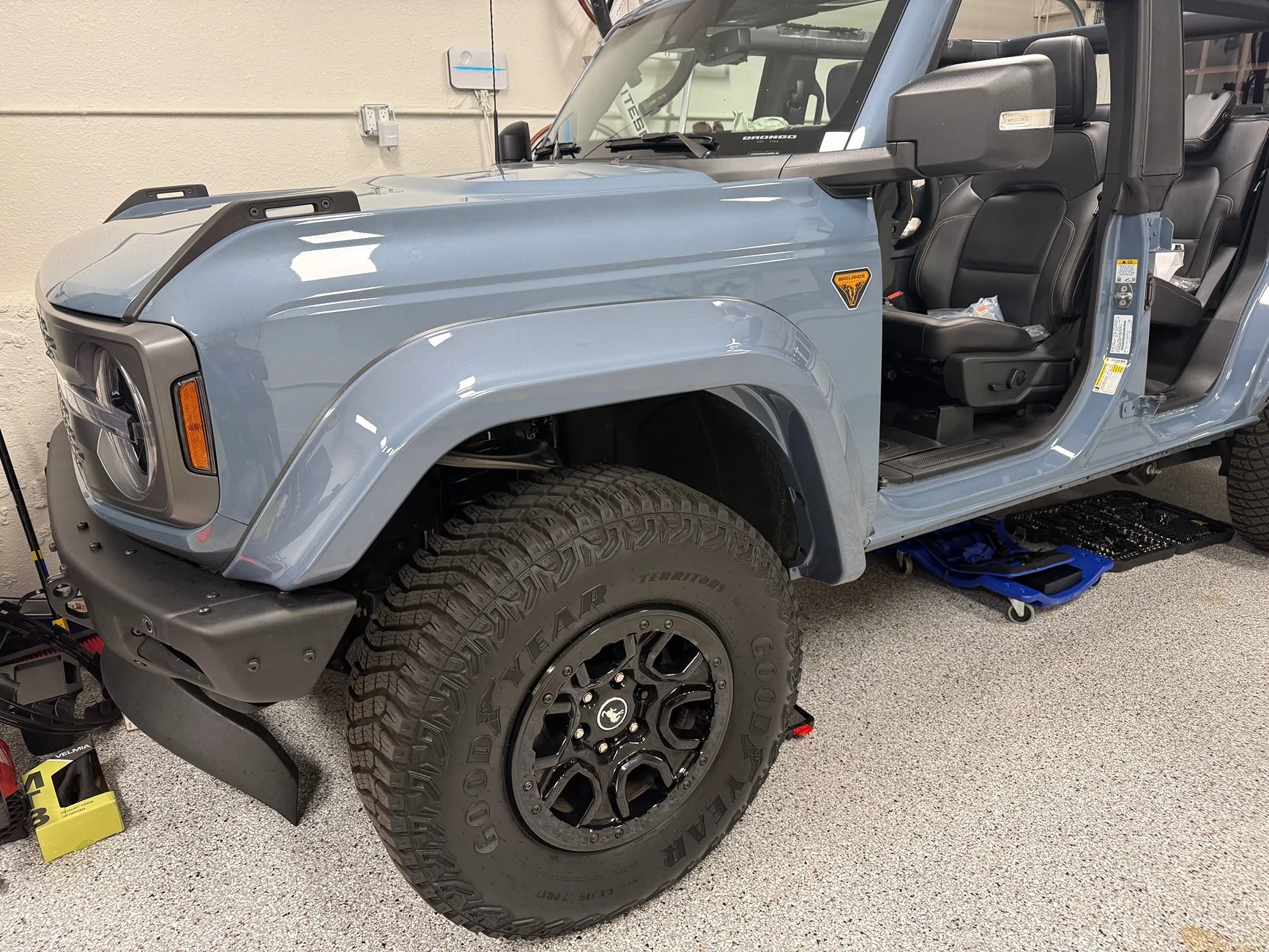

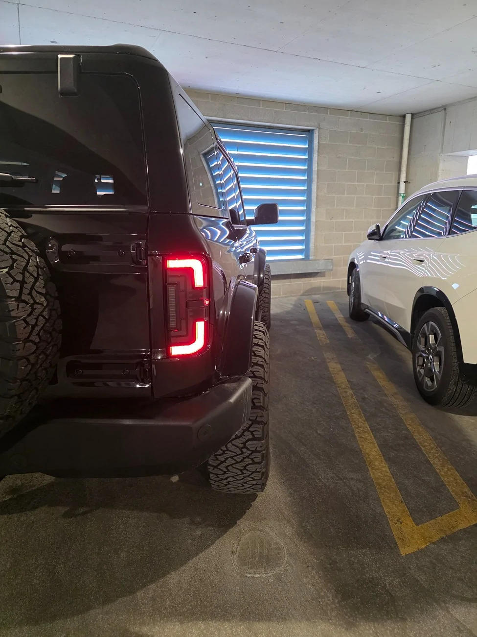

I installed LH front in about an hour going slow not to scratch or damage anything. The whole time I was thinking these are not going to be great, definitely returning them after a test fit in the garage. Now that I have the first one on I like it a lot.
The paint match is perfect. Better in real life than my pictures. I mean it doesn’t even cross your mind that these aren’t OEM except for the very front edge which I need to tweak a bit.
I also put on black trim rings today and installed a muffler delete. The wife is not happy with me this evening.
Ford Bronco Rough Country flares IMG_4494
Ford Bronco Rough Country flares IMG_4493

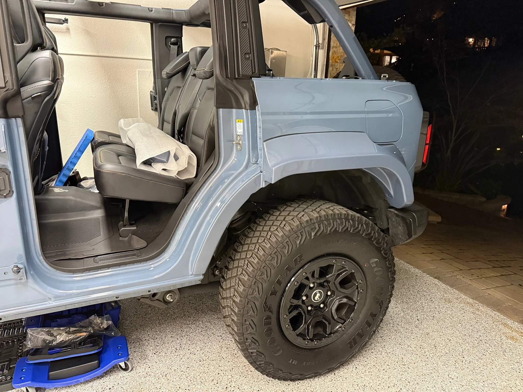

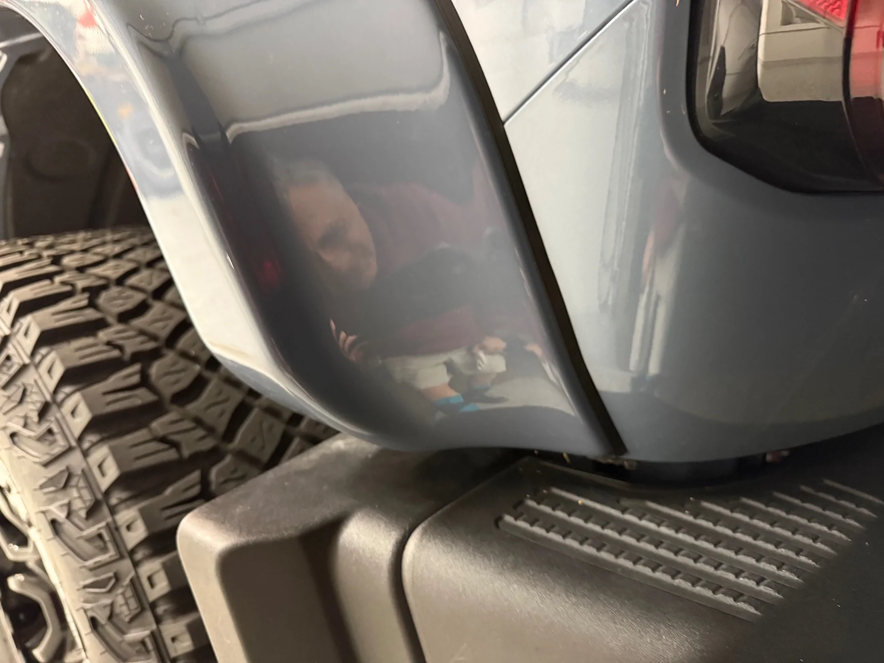

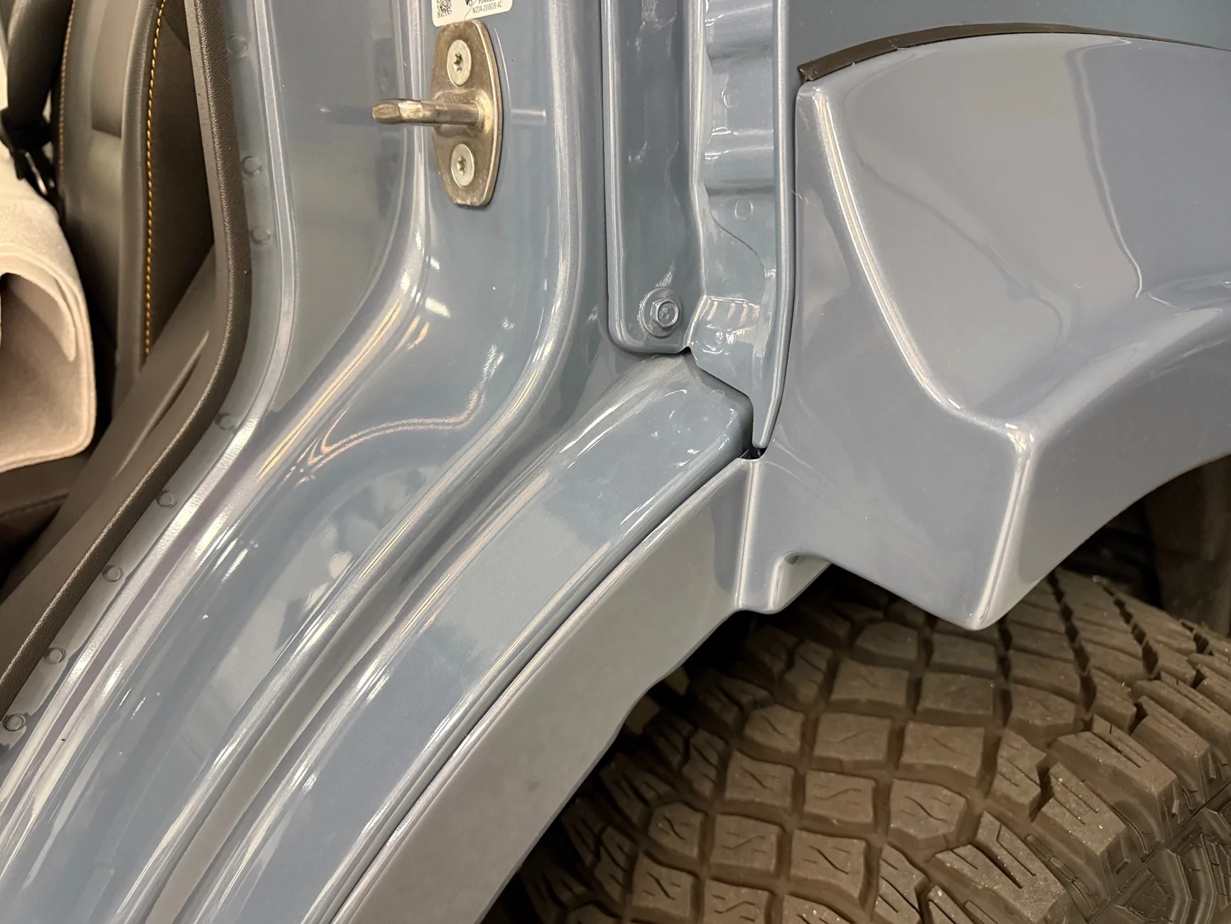

I got the rear fenders on. Happy with the easy install and they look pretty great in my opinion. Last step is to pull my doors out of their bags and get them on for winter. Then do the part that sticks on the door.
Ford Bronco Rough Country flares IMG_4508
Ford Bronco Rough Country flares IMG_4504
Ford Bronco Rough Country flares IMG_4503

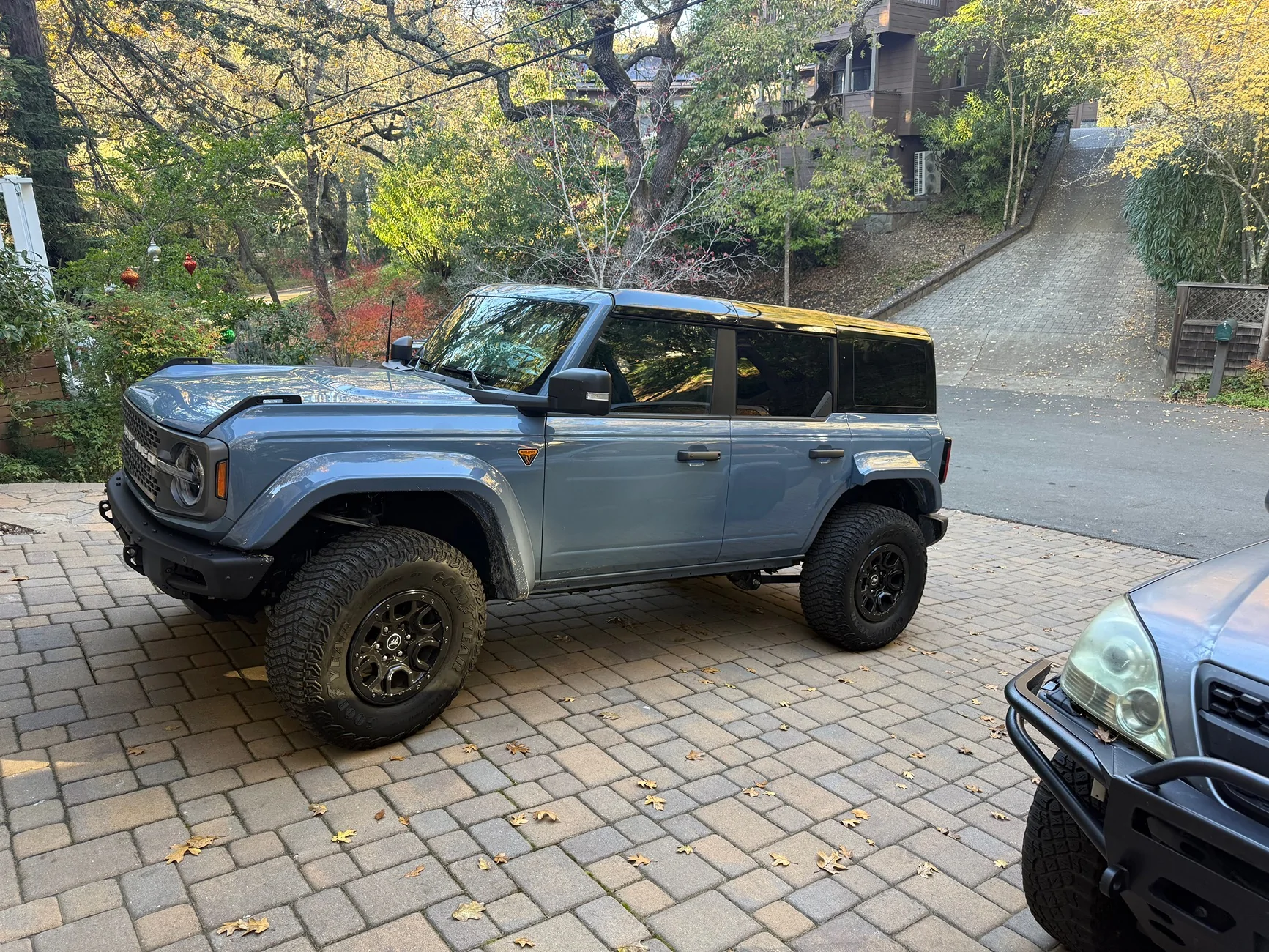

I just need to get the rear door pieces on to finish up. The instructions say to apply the tape that holds those parts in place and let it cure for 24 hours at 65F+. For the past month it has been much cooler than that here in NorCal.
