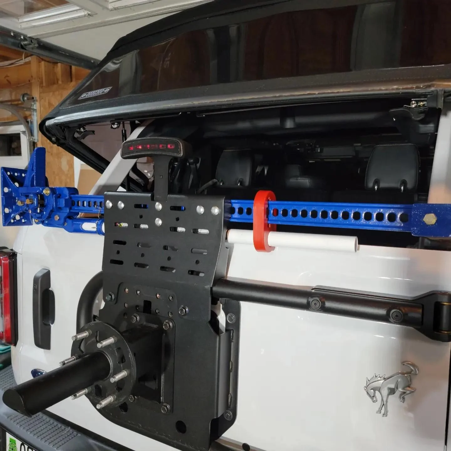

By any chance would you happen to know the size of the rear tailgate hinge bolts? I'm trying to fabricate a Hi-lift Jack for the rear mount and will need to get a similar bolt but just longer. Appreciate your help.
Thanks
Per the instructions they are: 8MMx45MM
