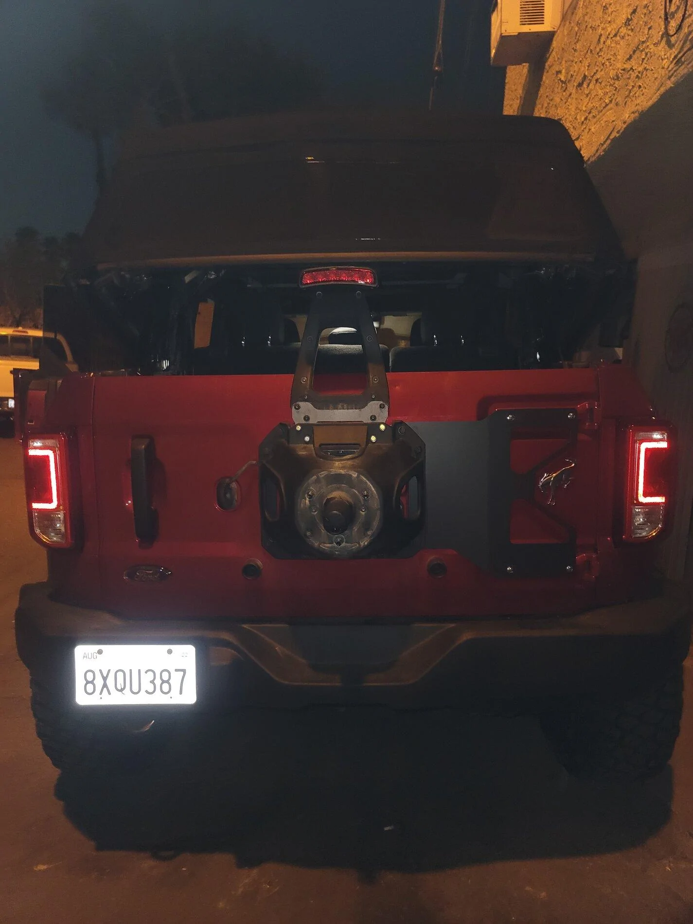

I recently purchased and received the Rough Country Tailgate Reinforcement and got to installing it last night. The installation is very simple and straight forward.
However, I do want to point out a few things to note if you chose to install. First you'll need something to use as spacers to support the tailgate when you're removing the exterior hinge bolts. I had to make do with a few random tools.

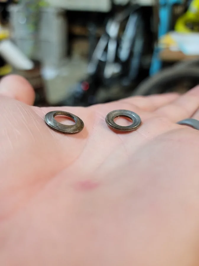

The main concern I have with this install is the supplied bolts and washers that are to be used when reinstalling the carrier. The factory bolts are 8x30mm flange head bolts and the supplied are 8x35mm standard bolts with washers. The problem is the the supplied washers are about half the size of the flange head bolts. My concern is that they will eventually pull through the plastic of the carrier.
As you can see in the picture above there is quite the size difference between the stock flange head bolts and the supplied bolt and washer.

Pictures below of the installation process.
Make-shift spacer and tape for alignment purposes. Also, it should be noted that the reinforcment will be making direct contact with the body at the spare tire carrier mounting points. I had some left over vinyl that I used as a protective layer between the reinforcment and the paint.
Hinge bolts require a T47 torx bit, unfortunately I did not have one. But a 6mm allen got the job done.
Installed and test fitting the hardware.
Final look
Park "Multi-Tools" for the win!

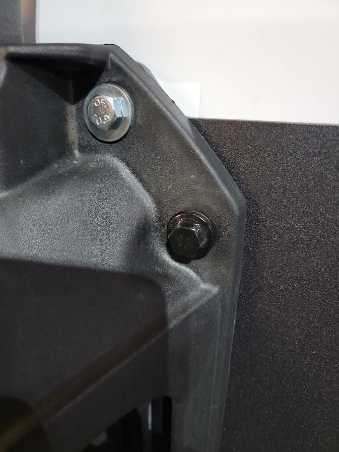

Here it is compared to the factory flange head bolt:
Ford Bronco Rough Country Tailgate Reinforcement - Installed - fastener issue rc7kPnXYqSXQdzGA3BLc0V0dS_=w673-h897-no?authuser=0

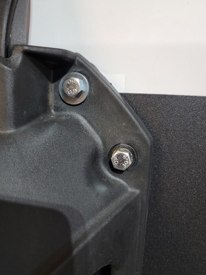

I'm much more confident in it holding now:

And this picture shows exactly why I was concerned and why having the right sized washers matters.
Ford Bronco Rough Country Tailgate Reinforcement - Installed - fastener issue sErmpW4aKEl92XNcwpK4PWt3wl=w673-h897-no?authuser=0

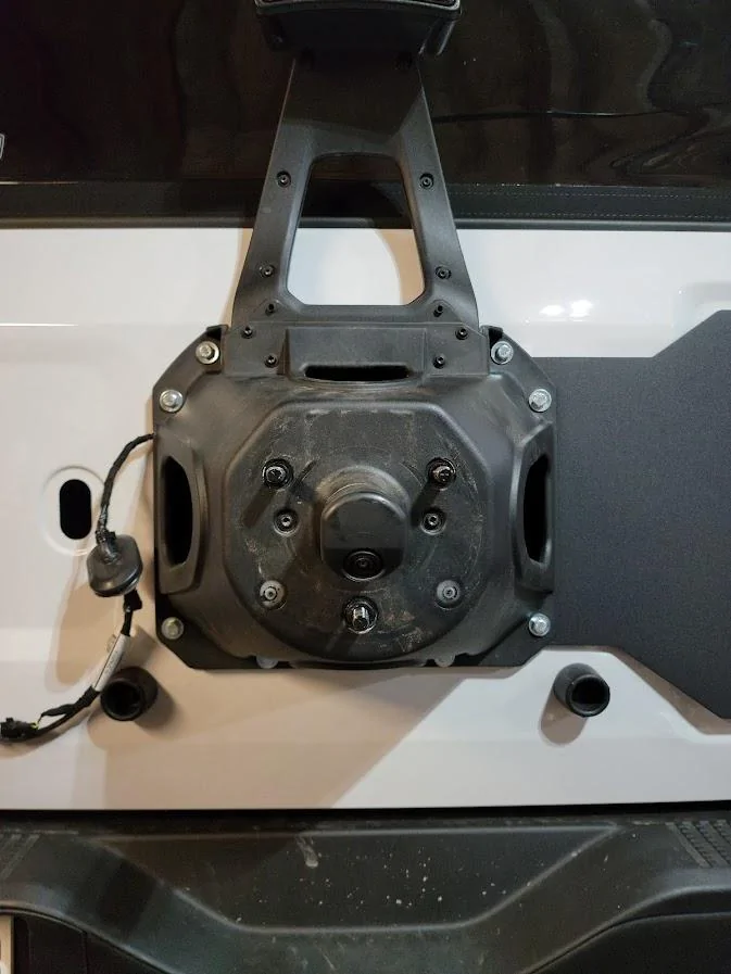

Is this hardware just to hold on the plastic cover? Or does it hold the cover and mount thru to the re-enforcement?
This hardware is what ties the tire carrier into the tailgate. It supports the entire weight of the spare.
