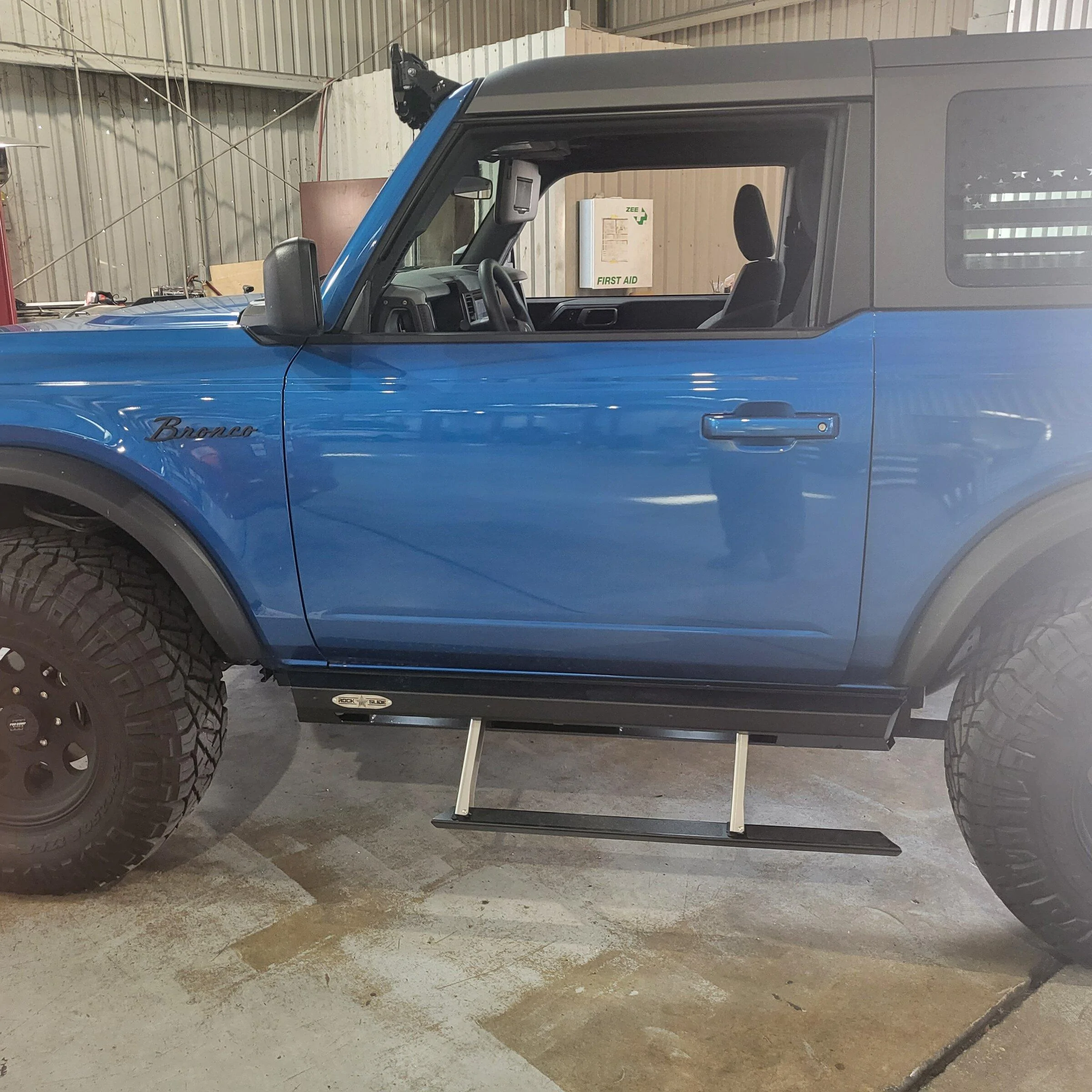

Did anyone keep the rough country steps and how bad was it to take them off to go off roading?
I got them on and now I want to go off roading and am dreading taking them off and on again.

I like them, they look cool, but I think taking them off and putting them back on will be a chore.
