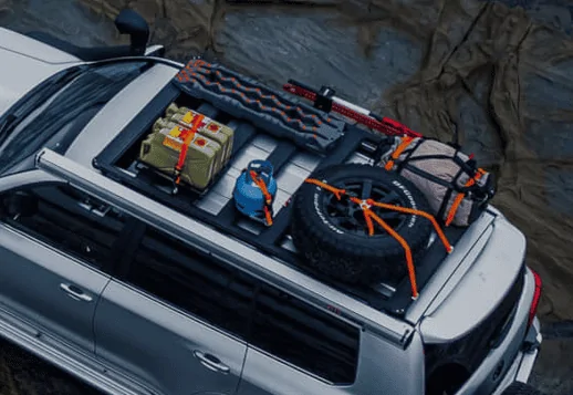

Just an FYI, you will never be able to load out a roof rack this on the Bronco... 110 lbs. dynamic load (so while in motion). The pic below is way over that. 30-50 lbs for the rack, so you have 60-80 lbs. for cargo. I see 85 lbs just in water/fuel.
My point is, what are you going to be putting on your rack and stay within load limits?

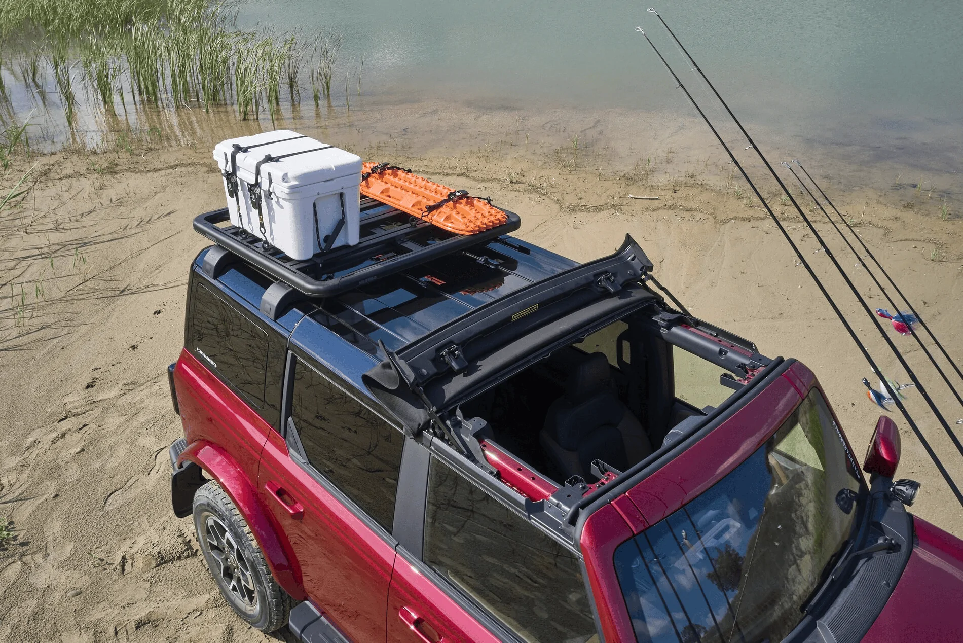

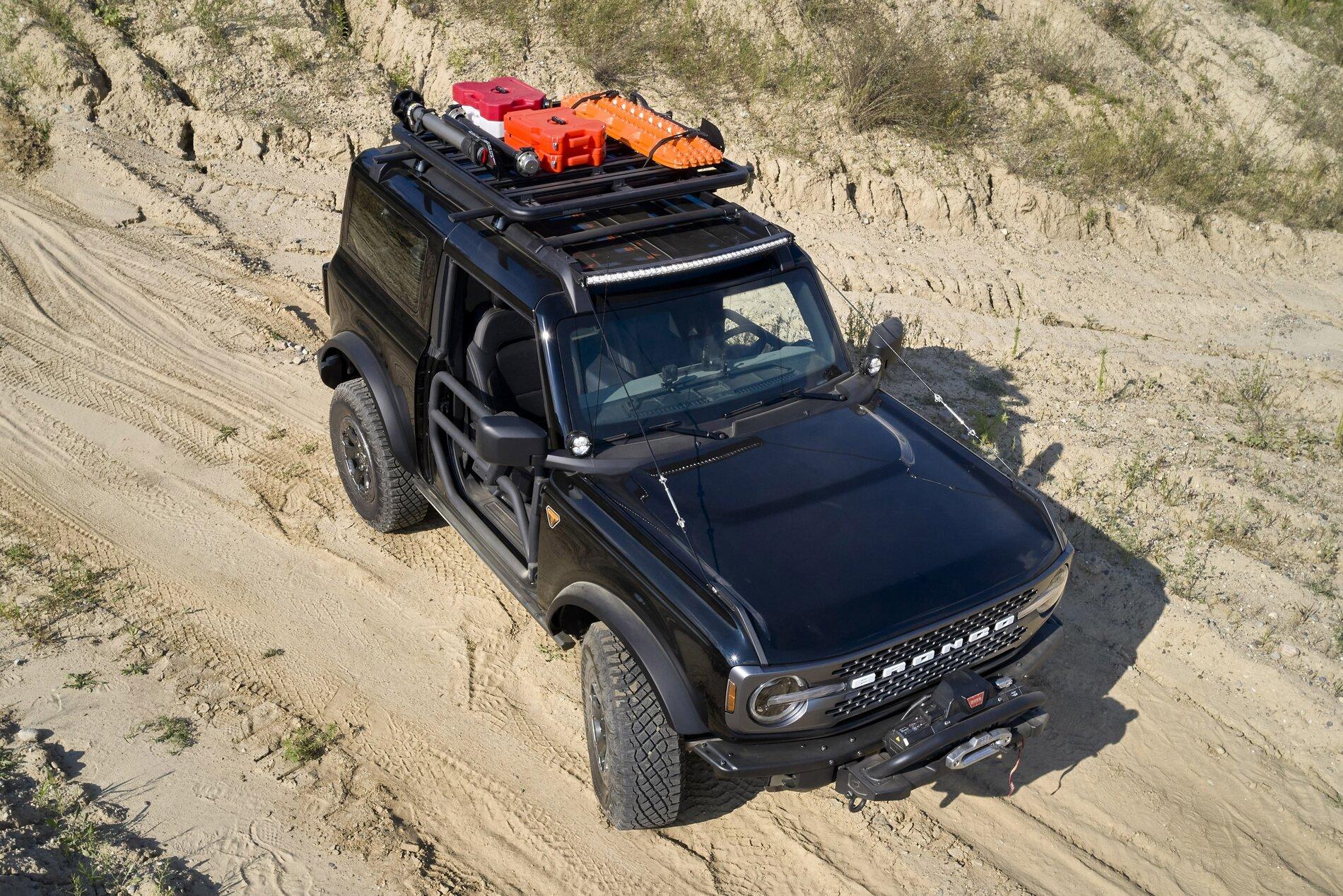

The smallest yakima platform weighs 55lbs. Nearly every official Ford media photo is over The 100lbs limit. Kind of a joke. I really wish they figured out a way to tie into the cage.
If everything in these photos was empty (cooler, rotopaks), I think they would be within limits.
I also really love the rack on that fishing outerbanks concept. IF I do a rack at all, it will be this. I do wonder what the load limit will be with only using the back shell to attach too...
