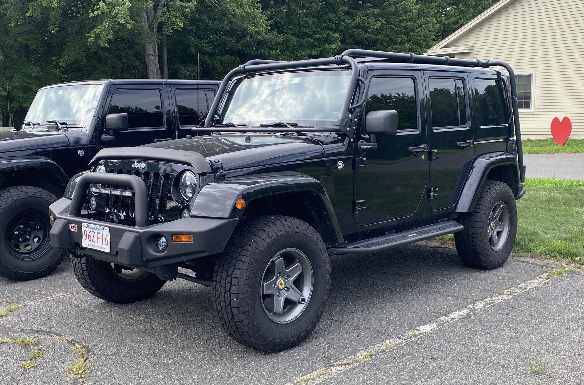

I have this on my Jeep. Originally a Kargo Master product.... now branded Adventure Rack Systems.
https://adventureracksystems.com
850lb static, 375lb dynamic....
Ford Bronco Roof Rack ideas IMG_6119
Thank you! I know I'd seen this rack before and could not for the life of me remember who it was made by. This and the Gobi are at the top of my list if I decide to pass on a trailer.
