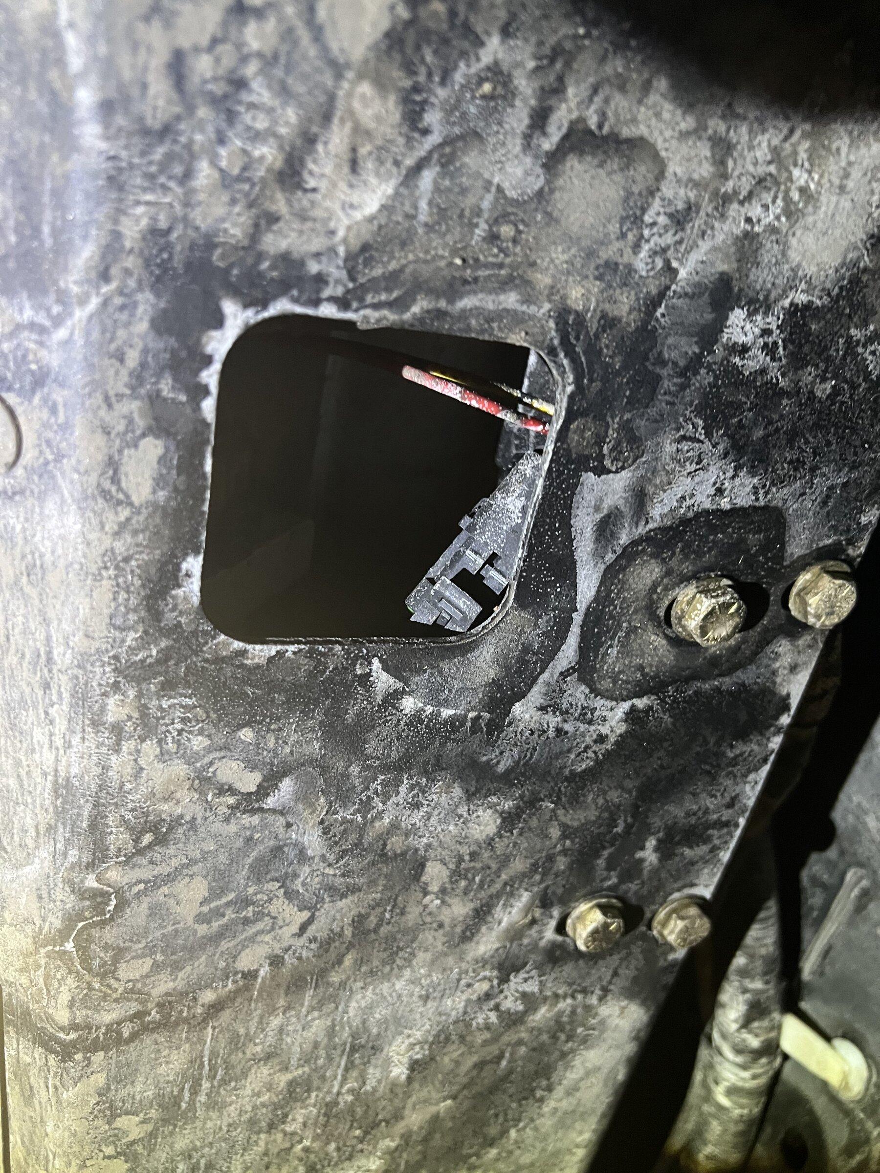

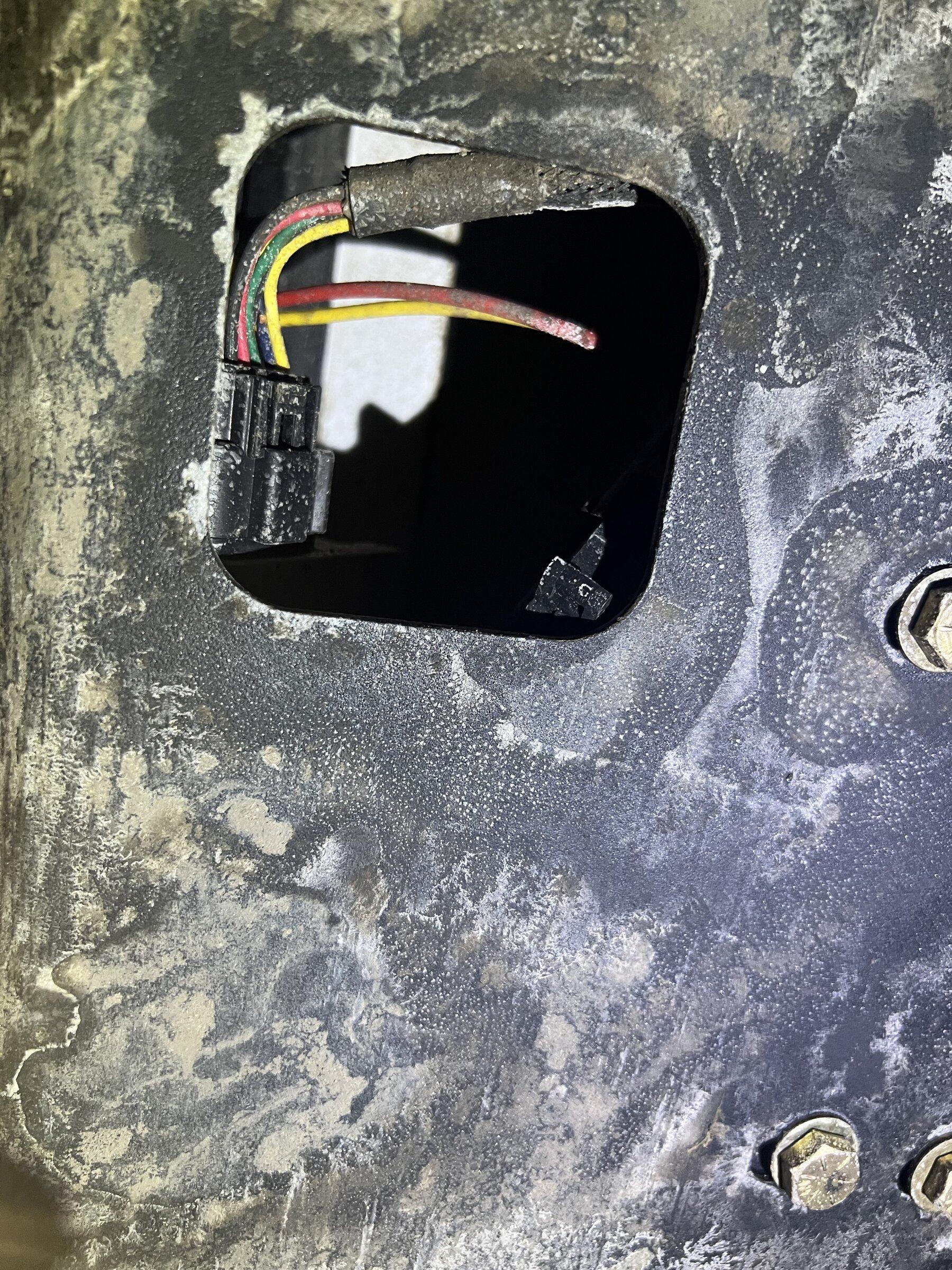

Send a under side pic if you can
Exact same on both sides. That is the mag chloride treatment CO puts on their roads during winters covering the underside of the bronco after 1 day of driving in winter conditions.
Gorilla tape it.

for $2k I shouldn't have to use gorilla tape. If they wanted people to have easy access to the wiring connecting, how hard would it have been to make an access panel with 2 threaded bolt holes?
Or could of made a removable cap, haven’t got mine yet, but I might do that

Why does anyone need access there?
That seems a bad design. Once mine get here I don;t think I could leave it standing open.
Gorilla tape was mentioned. They make a waterproof exterior grade tape. It is tough and rubbery. It won't stand up to being repeatedly scraped by rocks but would take a few years of road salt.

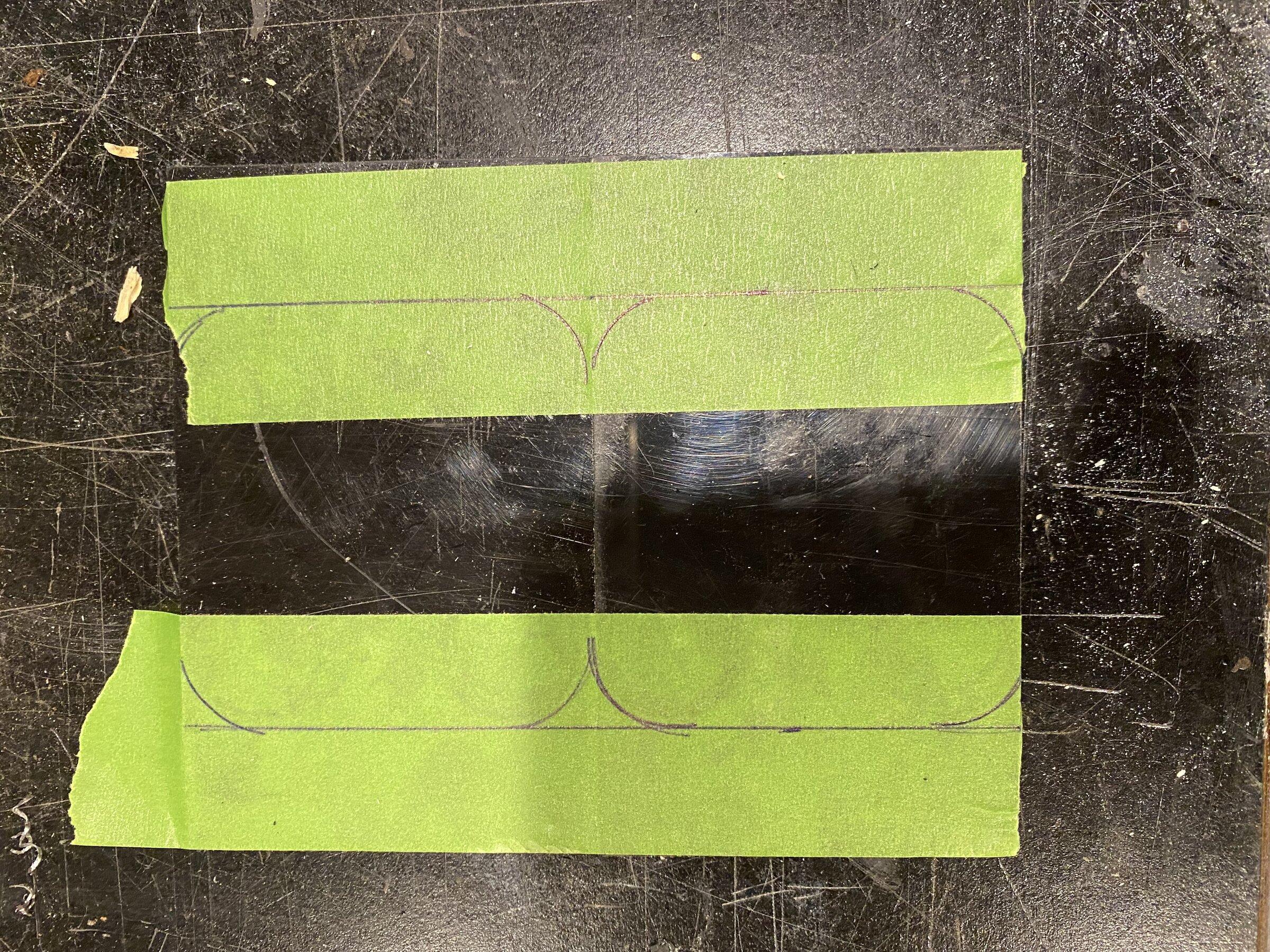

@2Jeeps&PatriotX1 Thanks for reminding me about those holes - kind of forgot about that after I had installed.
Problem solved...took some smoked plexiglass that I had and cut two "covers" for the holes. They are 2.5" square, with rounded corners, so I cut the stock to 2.5" one direction, and 4" the other way to give me 3/4" overhangs on each end for attaching.

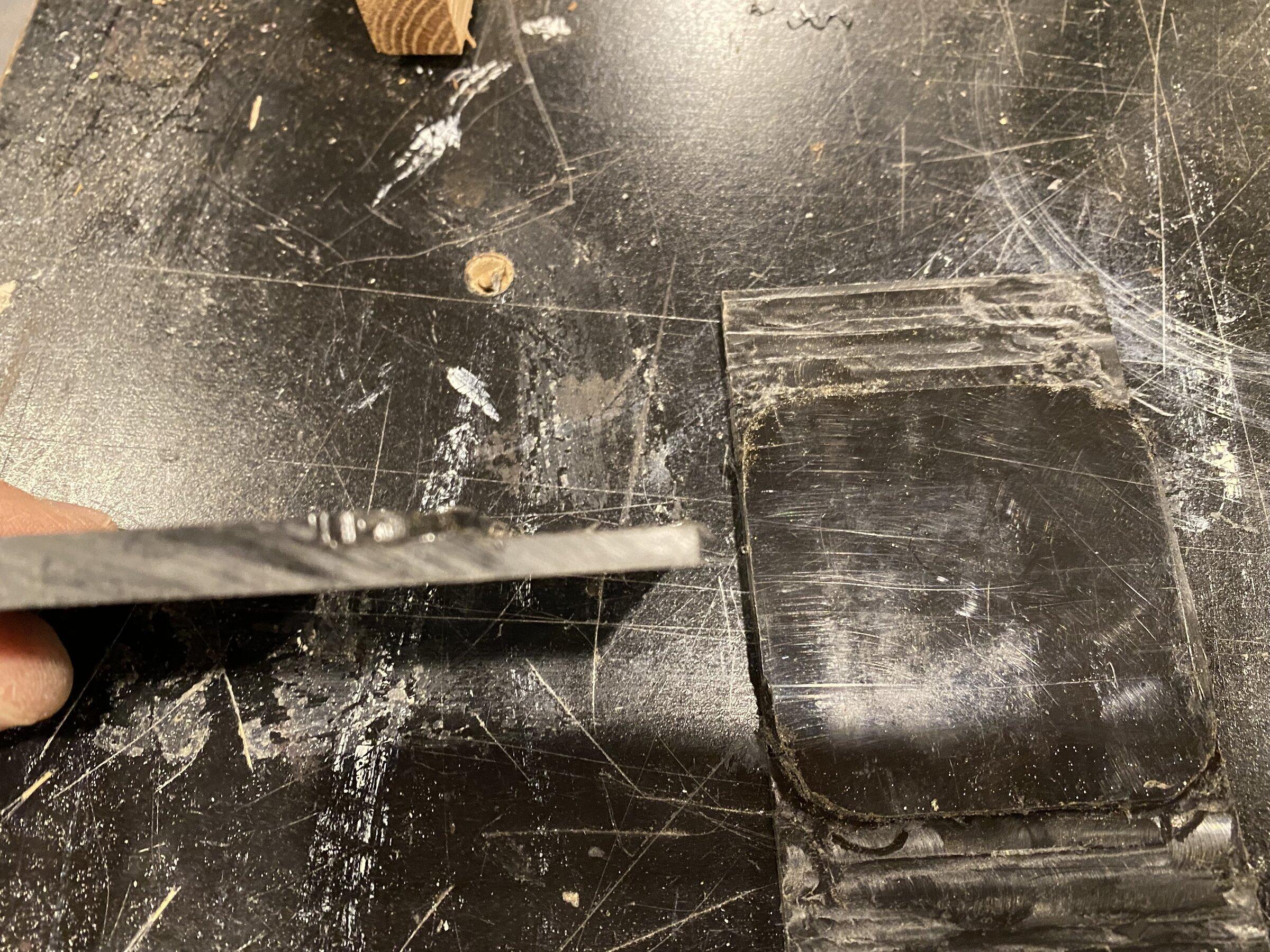

Then I routed the thickness down so that they would sit flush with the outside. Used my router table for the ends, and then just used a Dremel bit to round the corners down.

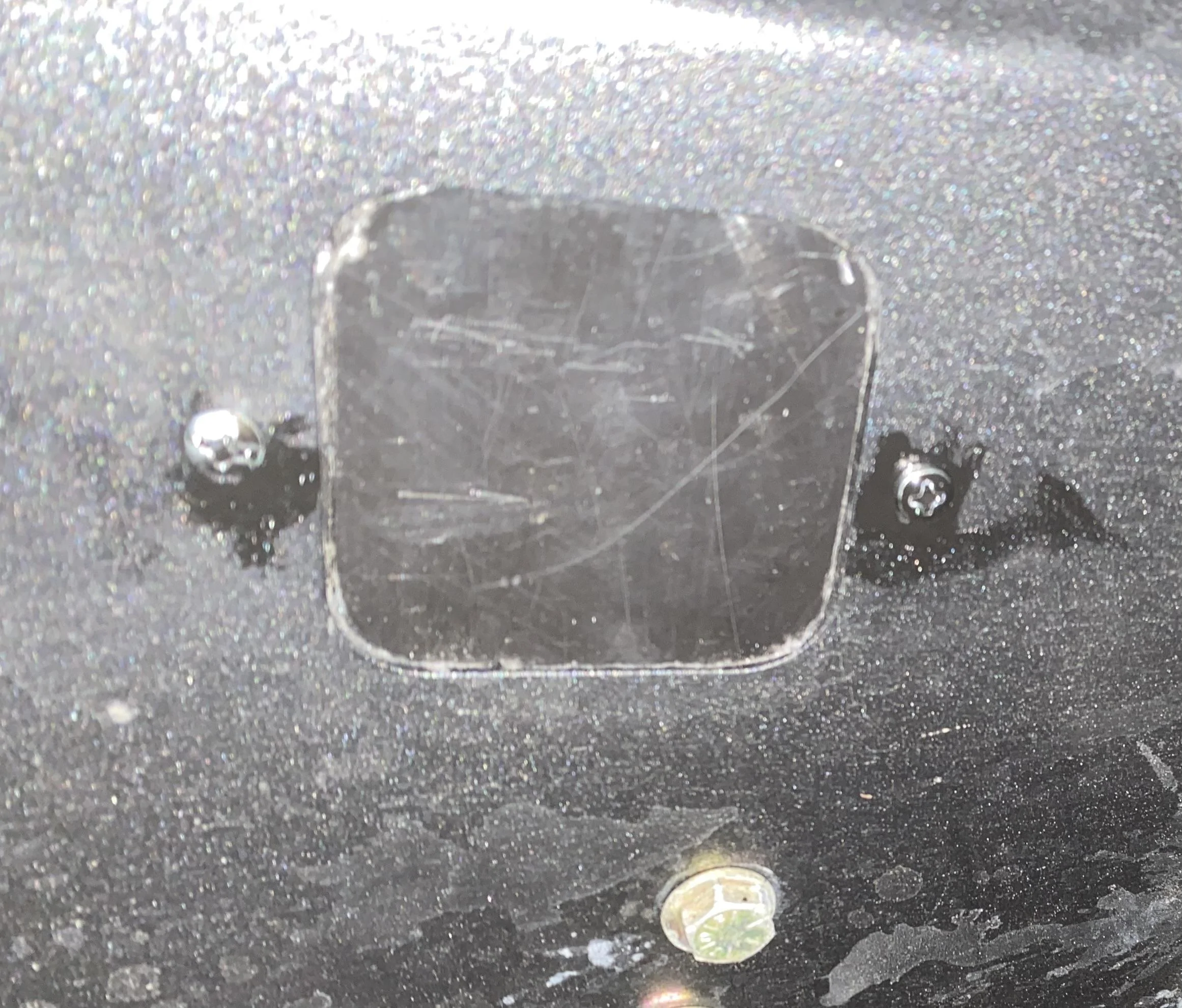

Tested the fit, left them in while I drilled (so I would not catch any wires inadvertently) and screwed them in. (Also painted the holes with rustoleum for a little extra protection. didn't clean off terribly well, but not really concerned under there)
Man, I appreciate the effort you put in here, but I gotta say I agree with a previous post - for the price, there should at least be a rubber grommet insert or something for these holes.
I’m not saying there shouldn’t be, but there isn’t, so I fixed my problem with stuff I had around in an hour or so.
Honestly, I really needed a project anyway. Was bored, so it was something fun to try.
Just a bit of levity sir. I have the same steps. Not quite sure what the reasoning was to the design other than the access you mentioned as well as maybe to allow adequate drainage.
If you get the additional slider portion, does that cover it up maybe? I’m a little annoyed we have to buy the slider portion separately as the whole reason I really bought these was I thought the were slider/steps in one.
