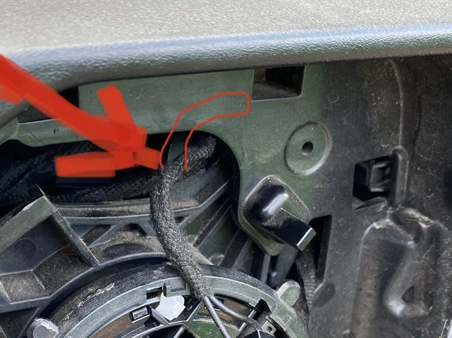

Agreed on the logo. For the wire, follow my instruction on page 3, there’s plenty of length in the wire, you just need to unhook it toward the back corner of the cap.
Mine were passing thru a hole. I did back them out of that hoping for more length. It didn’t seem to help. Are you saying there is another clip way in the back?
Not sure if it’s another clip, but it’s like a long ear tab that several wires are wrapped around. I’ve outlined the tab that is in the back. Grabbing the free end of the wire and pushing it into that cavity got it around the ear tab and allowed the extra wire length to come out.
Yeah, that's what I did. It didn't seems to much more length for me. @Sumaperformance I am order 9862 so you can get those wire extensions sent out.

1. the logo is personal. To each there own. FWIW it is small, but there
2. I was able to move the heating wire to get more length, but it seems maybe the length of the wire is different for everyone? I made it work but barely!
3. I used electrical tape to hold in place until we get the replacemenrt
