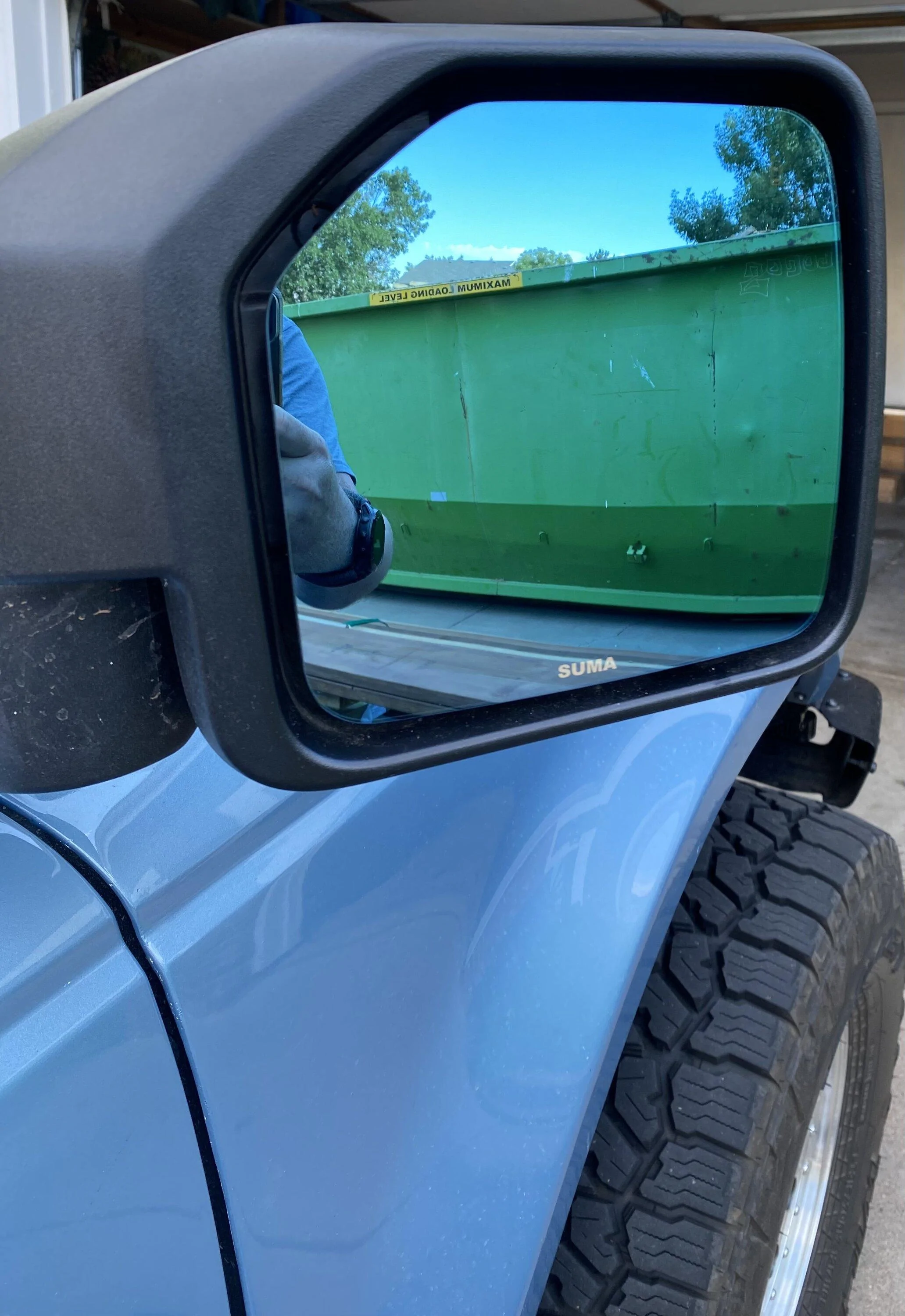

I just tried to put my mirror on, and I too am a little disappointed with their logo on the mirror. This will be a deal breaker for me, as well as the terminals on the mirror are not the same thickness as the original. Im currently awaiting a response from them about next steps. Im not keeping these mirrors with the logo printed on the mirrors. Im pretty sure in none of their videos or pictures on their website, did I see a logo at the bottom of the mirror. That would of been a hard no for me.
Yeah, same. Waiting on an email response from them too. So far it’s crickets @Suma Performance

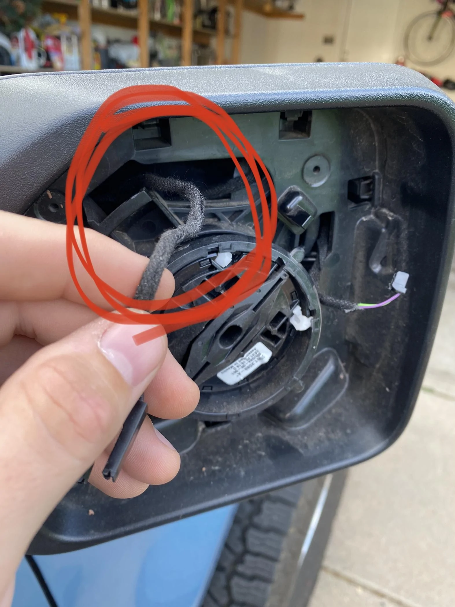

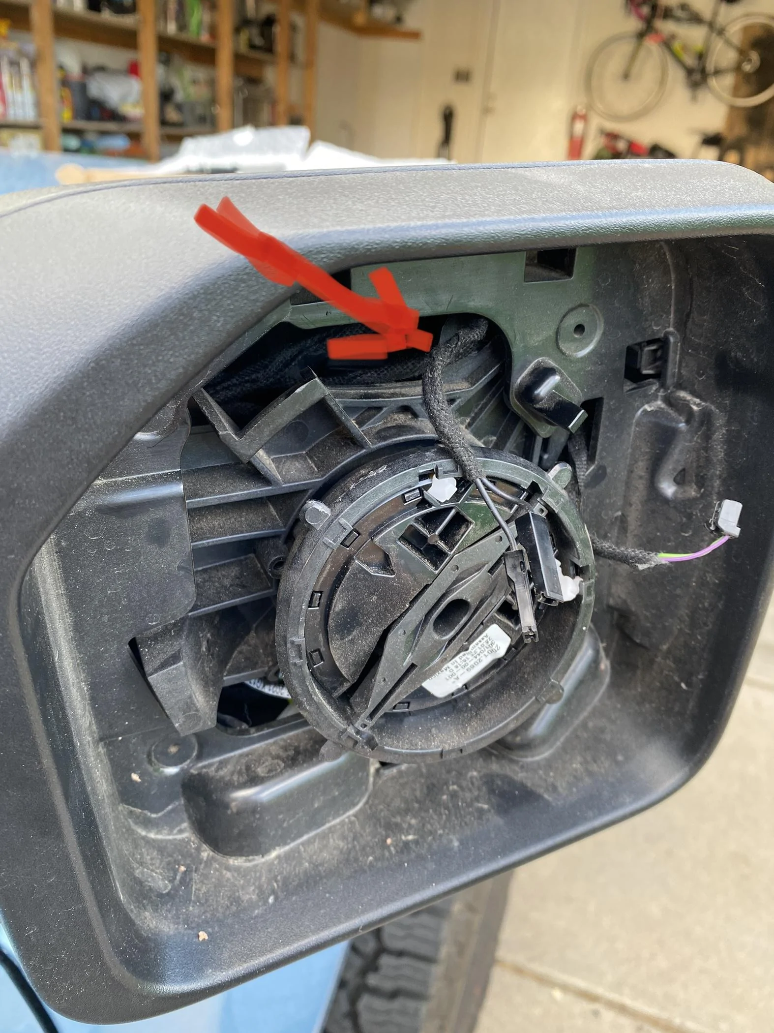

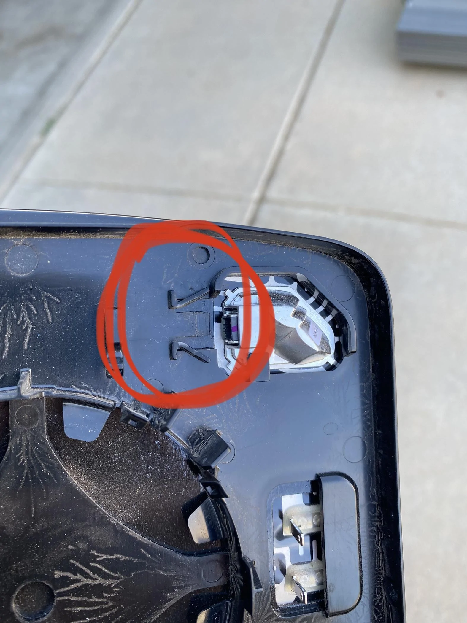

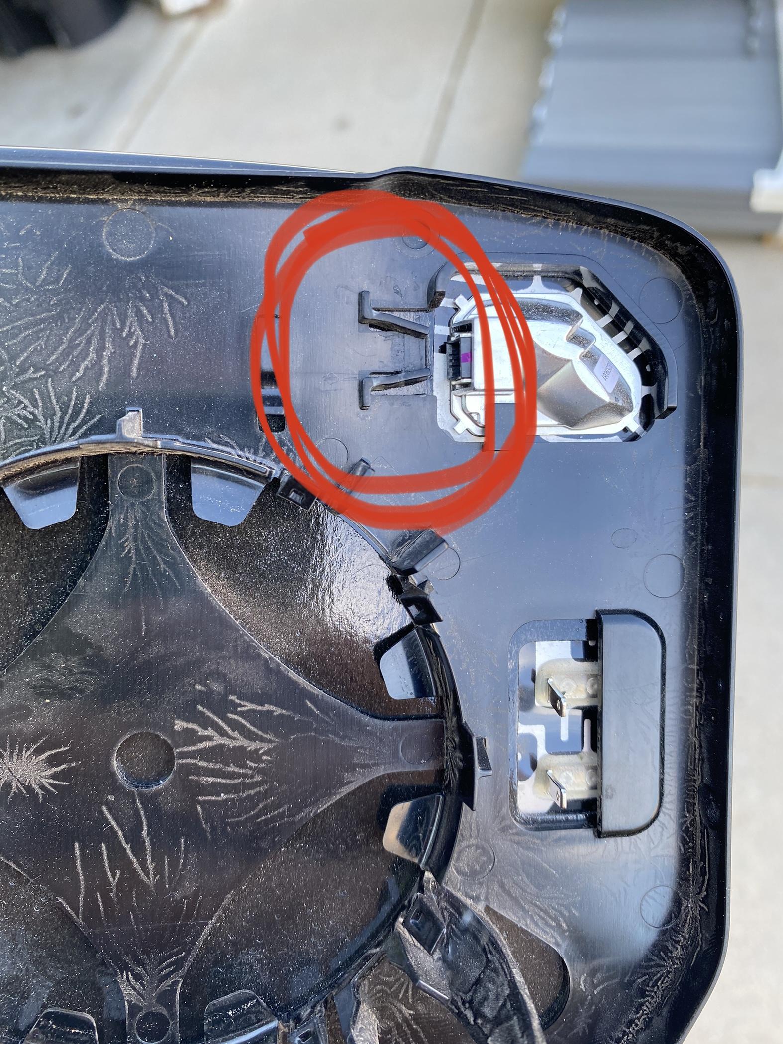

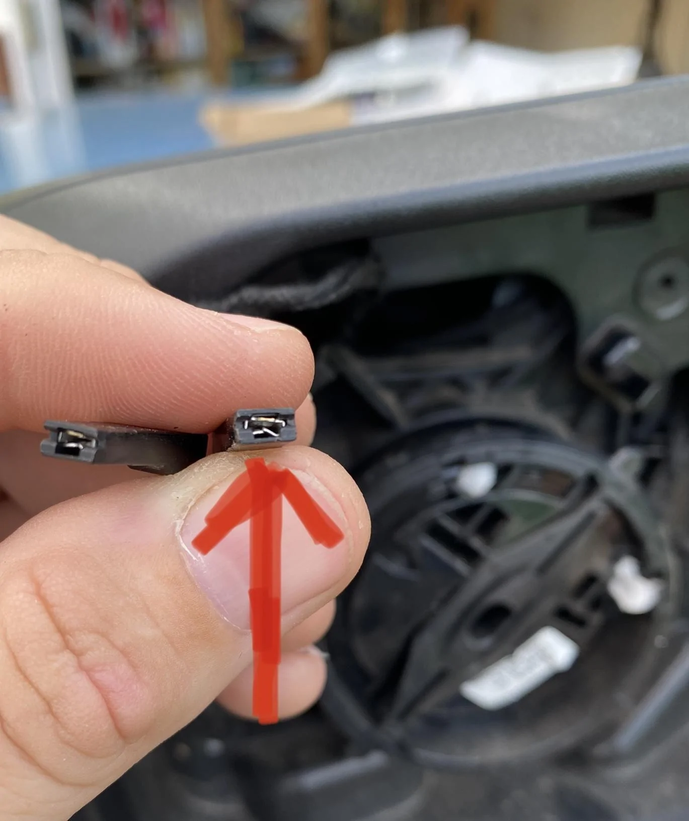

Ok, so I agree that you shouldn’t have to do these thing to make a 3rd party product fit, but I live by “improvise, adapt, overcome.” Here are some tips for a successful install:
1 - The thin black defrost wire connections pull right off the OEM posts. The block harness BLIS connection, however, needs you to take a pair of needle nose pliers and bend out the retention tabs holding the harness in place, then you can depress the small tab on the harness with your thumb and pull it out.
2 - The OEM Defrost connections wire is tucked into a support hook in the back corner of the mirror. Take your needle nose pliers, grip the wire near that hook and push the wire into the mirror cap and out and around the hook. Then you’ll have plenty of wire length to the new defrost wire connections.
3 -The OEM defrost connections are a bit bigger than the posts on the SUMA mirror. Take your needle nose pliers and squeeze the ends of the connectors a bit so the internal metal tabs bend in a bit. Then the connectors will have enough friction to stay on the SUMA posts nicely.

Regarding the Logo, sorry that the rendering didn't have it. The reason we've decided to put it on is that we've found copycats offer products of inferior quality (at least for the car platforms). To protect the customers and our brand, we've decided to put the logo in an area we thought was inconspicuous.

At this point, I will have to return this item, as the LOGO being put on the mirror is a non-starter for me. I would be OK if you put it on the back of the plastic or on the side, but not on the mirror itself. I loved the concept, but I feel like you need to put what the finished product would look like. I waited several months, and am a little disappointed, and really its the LOGO. You should probably do a POLL on this. Just say'in
