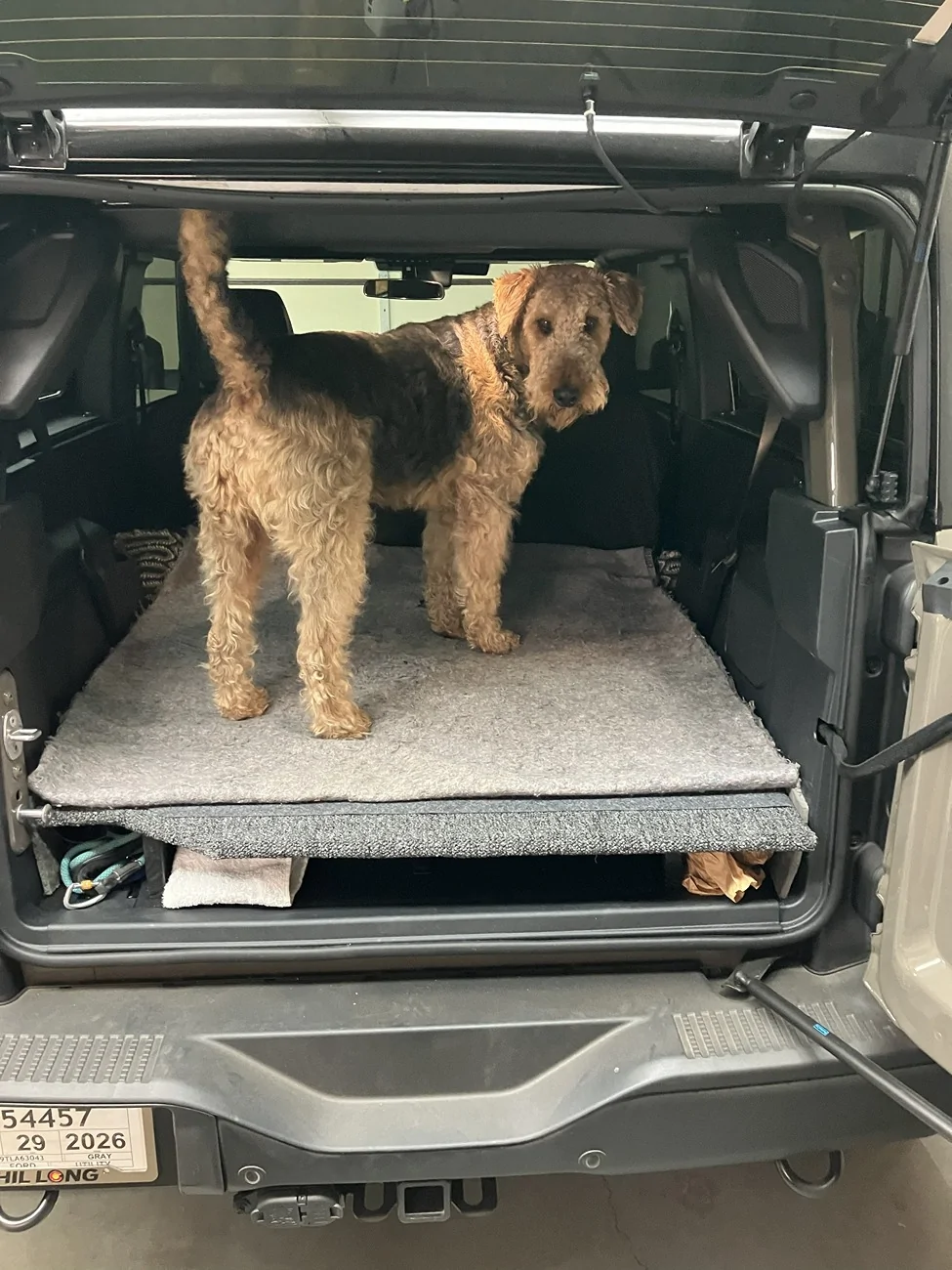

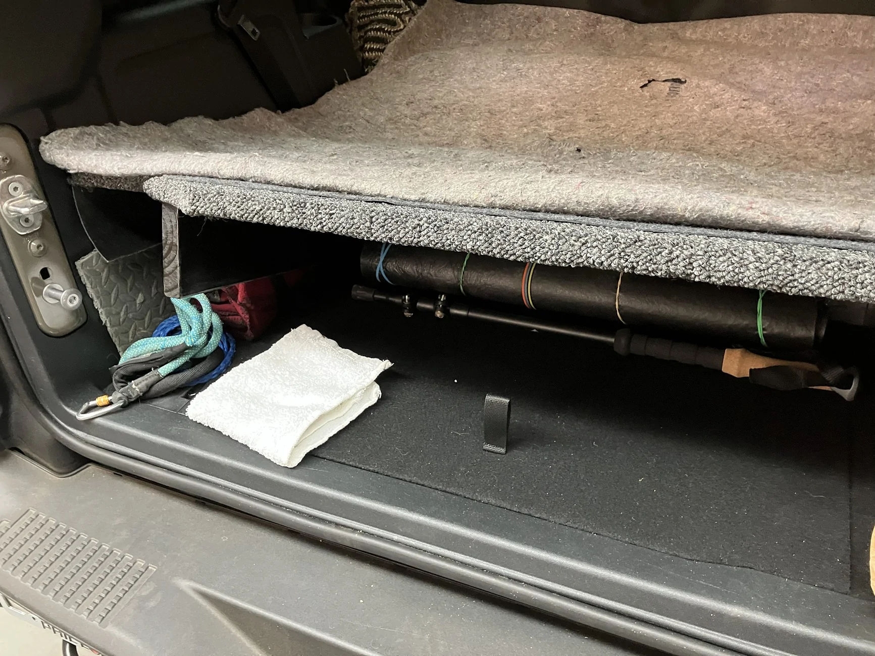

If you don't mind a little handwork it might be easier to make what works for you than buy something. My dog Olli does well loose in back. I understand a non-crate is no-go for some. Total cost was less than $200 including a K-9 blanket to keep him from crawling in front. Home Depot purchase of 4x4 1/2" plywood, an 8' - 1x6, some outdoor carpet and adhesive and piano hinge. I found a 5/4 8' piece of redwood in discard pile with rounded corners which was nice find. Ripped 1x6 to 4.5" and made a U-shaped frame making sure frame rests on either side of storage lid so it can be opened. I cut for snug fit (not overly tight so pieces can be lifted) then wrapped carpet around platform and stapled underneath. Plywood piece over folded down seats could be anywhere form 12-18" and same width as platform, and attached with piano hinge. This allows seats to be raised and section on hinge raises behind rear seats. It also allows rear portion to also be raised for access to tool storage bin lid. Since rear portion lifts up for access, I added some rubber foam in back corners to snug it up. Additional storage underneath platform is helpful for misc. stuff. Rear cut out on left is angled to accommodate shape of tailgate. Its plenty sturdy when I crawl in side - no sagging, tilting or movement. I ended up throwing some moving blankets on top for easy shaking and cleaning.

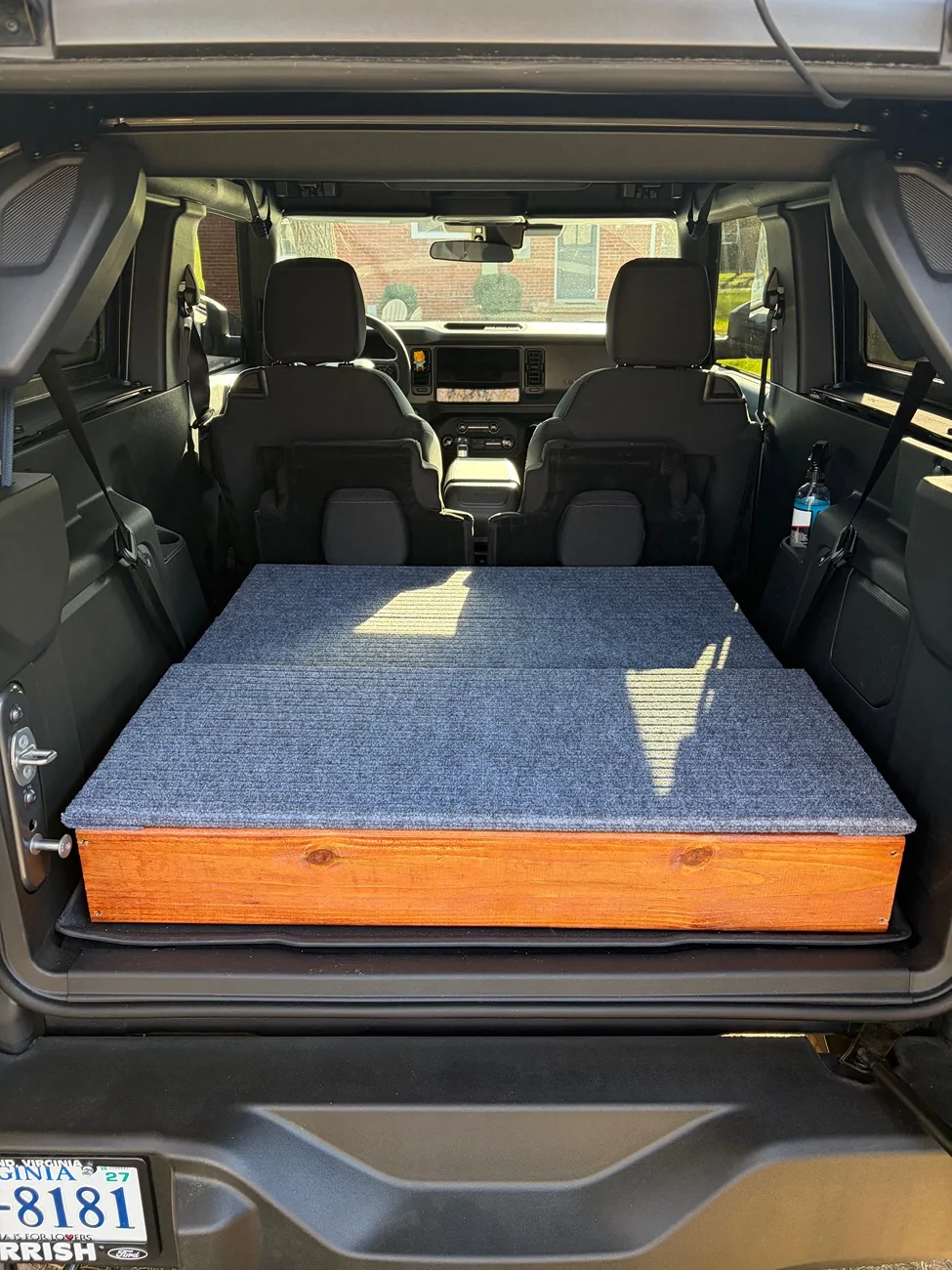

I built this using a few 1x6’s and Plywood for my dogs and car camping. It’s worked well so far

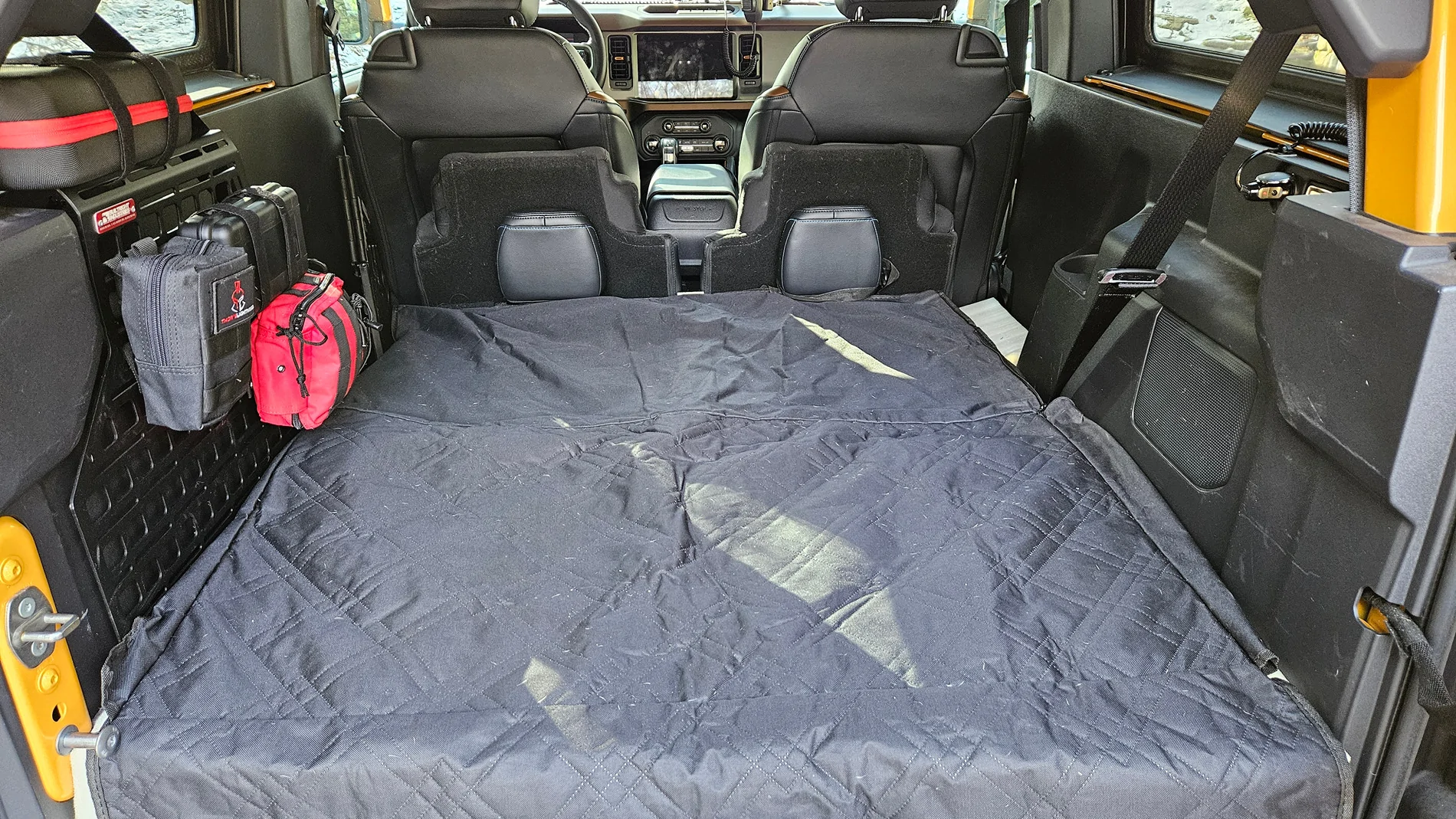

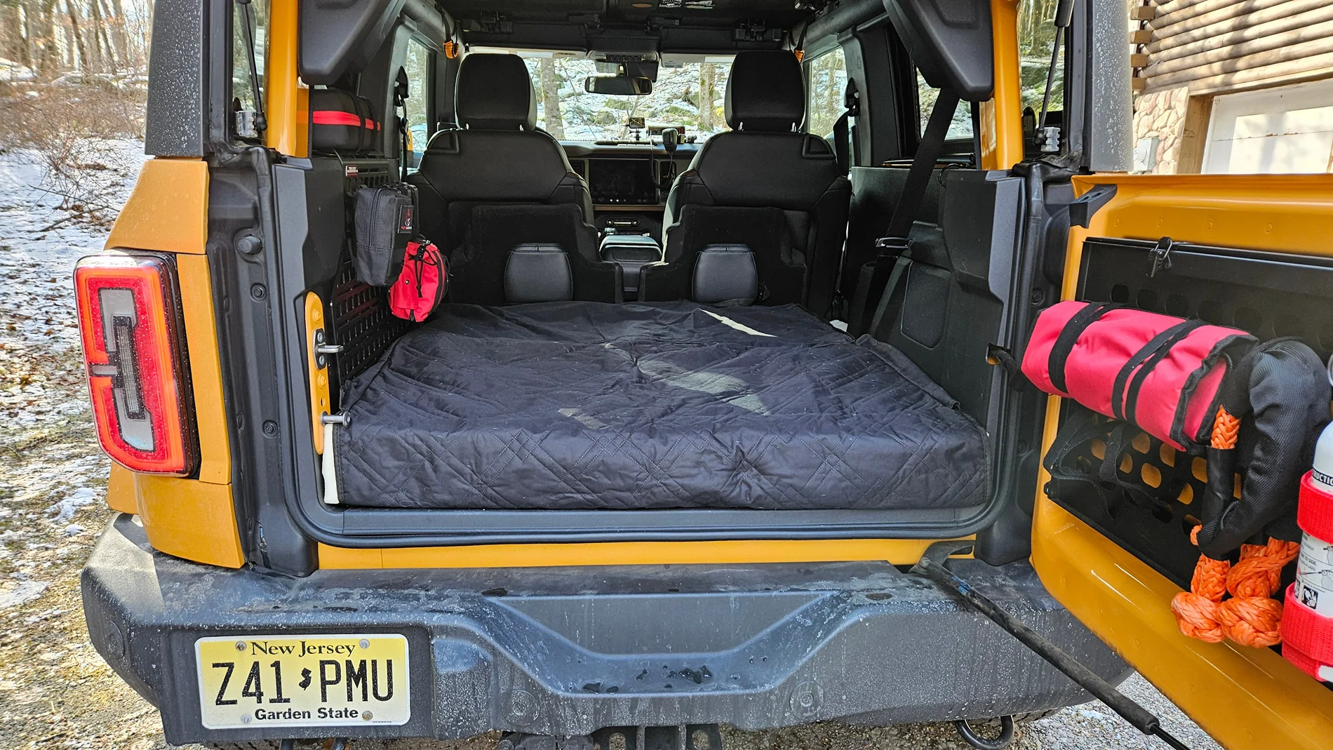

I got some thick memory foam and cut it to fit against the folded down bump. Then I put the Mabett dog protecting blanket over that. Works pretty good for my old man.
