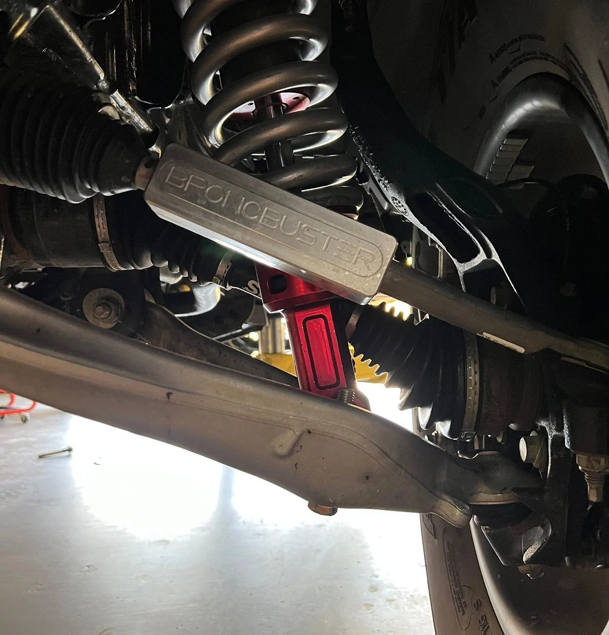

Acutune would you be willing to post pictures of cv angles at full droop with the Ride Shocks installed? Just curious what kind of angle they are at. I’ve seen some aftermarket shocks really mess up cvs.
Thanks!
Well, I had a chance to snap a quick photo. This is at full droop. Both tires spin freely with no binding what so ever.

There uh, seems to be a huge pile of shit there in front of your shock šŸ˜‚šŸ˜‚šŸ˜‚

I am personally not a fan either. Would much rather have the correct upgraded parts. This is on my wishlist at least, so until Santa visits me, its going to stay like that. Unless someone wants to sponsor us!
To be fair, this is how it came when we purchased from a good friend of ours. 😬

Just need to keep the extended length less than the danger zone. I am sure they have that figured out. My X-ray vision can’t tell if the CV is binding in this pic. šŸ˜‚
We like to live life dangerously, but when it comes shocks & performance we tend to be extremely detailed.
Our extended lengths vs other brands:
RIDE: 24.30"
Fox: 24.26"
King: 24.60" <-- danger zone, which is why we strongly recommend a .30" shaft spacer to be added.

If you take them off I’ll send you a factory 2.0 inner to keep as a spare. You’ll be the second rig I’ve sponsored. šŸ˜‰šŸ˜‰
If nothing else remove them to preserve your credibility (and get an actual pic of CV angle)

Thanks for the offer! I'd rather run upgraded parts that will last vs carry spares. Plenty of experience with that on my personal rig. I've wanted to ditch these for a while now, so maybe with enough encouragement I can make that happen.
