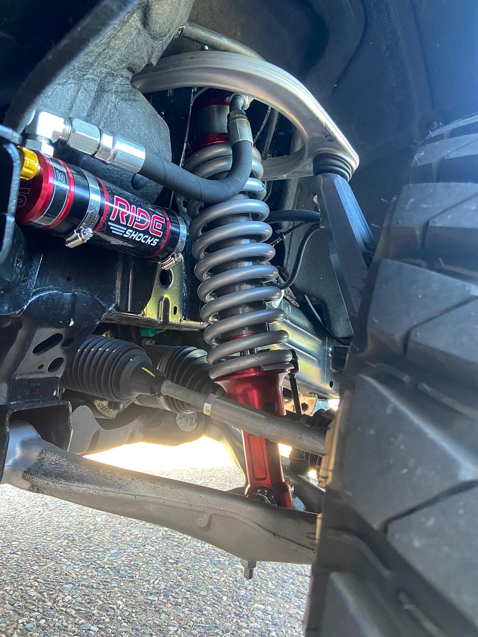

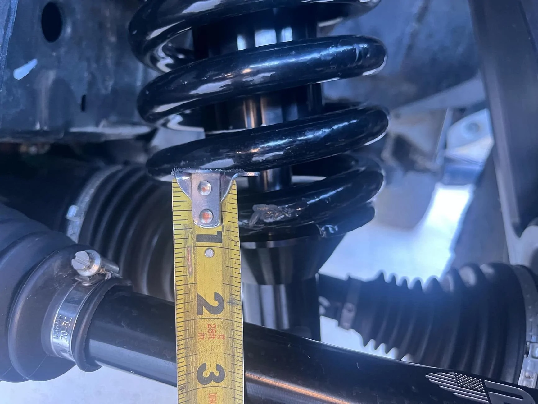

Rides very tight. I haven’t been off road yet. I have portals on a Badlands with no lift. Gained about 3”. Just squeaks into my garage. Gratuitous action photo.
Looks good. Might be an optical illusion in photo but it only looks like you have less than 1 inch of travel judging from the exposed shock shaft in the front? Sag at right height seems like the shock is almost bottomed out.
Excuse my ignorance if I didn’t say all the right terms.

Up travel does seem limited based on the picture. We ran into the same problem with the Rock Krawler coilovers as we ran about a third of the recommended preload trying to get it to sit lower. Tested it out and we bottomed too easily. Had to bump up the preload to RK recommendations. Uptravel is about perfect now for our use (rocks) but the rig sits a couple inches higher. Just one of those things that happens with longer struts if you don’t change your shock towers out. (Attached picture is our original preload)

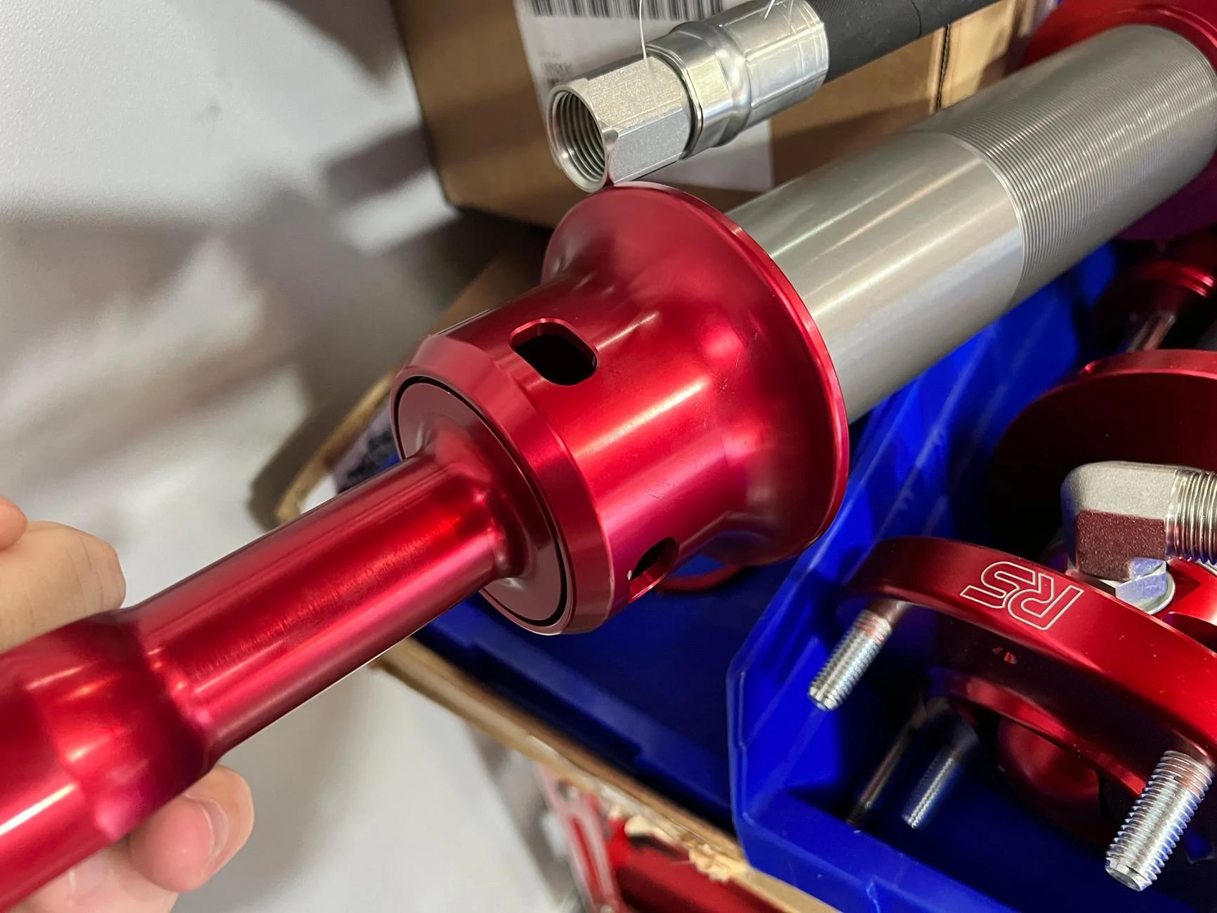

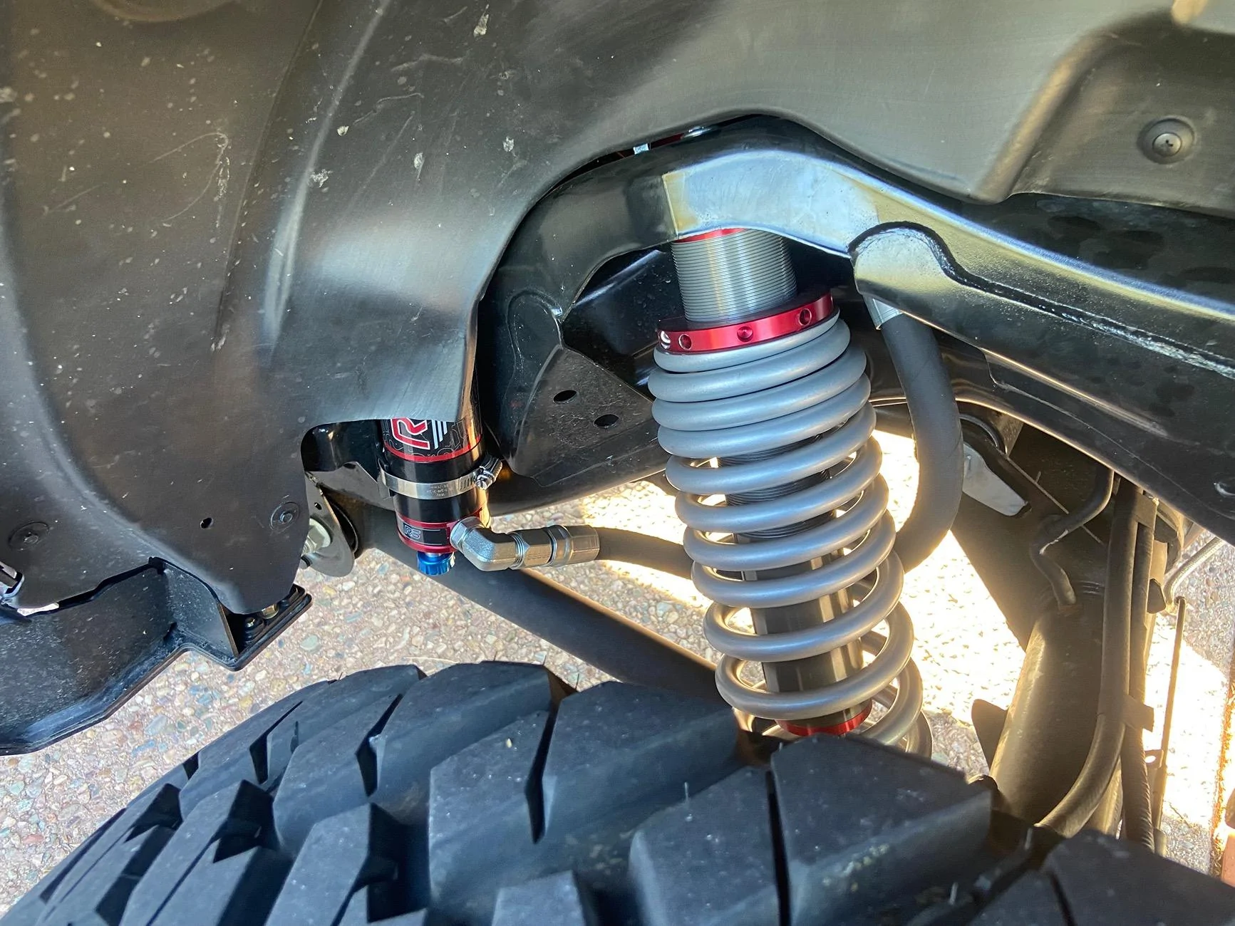

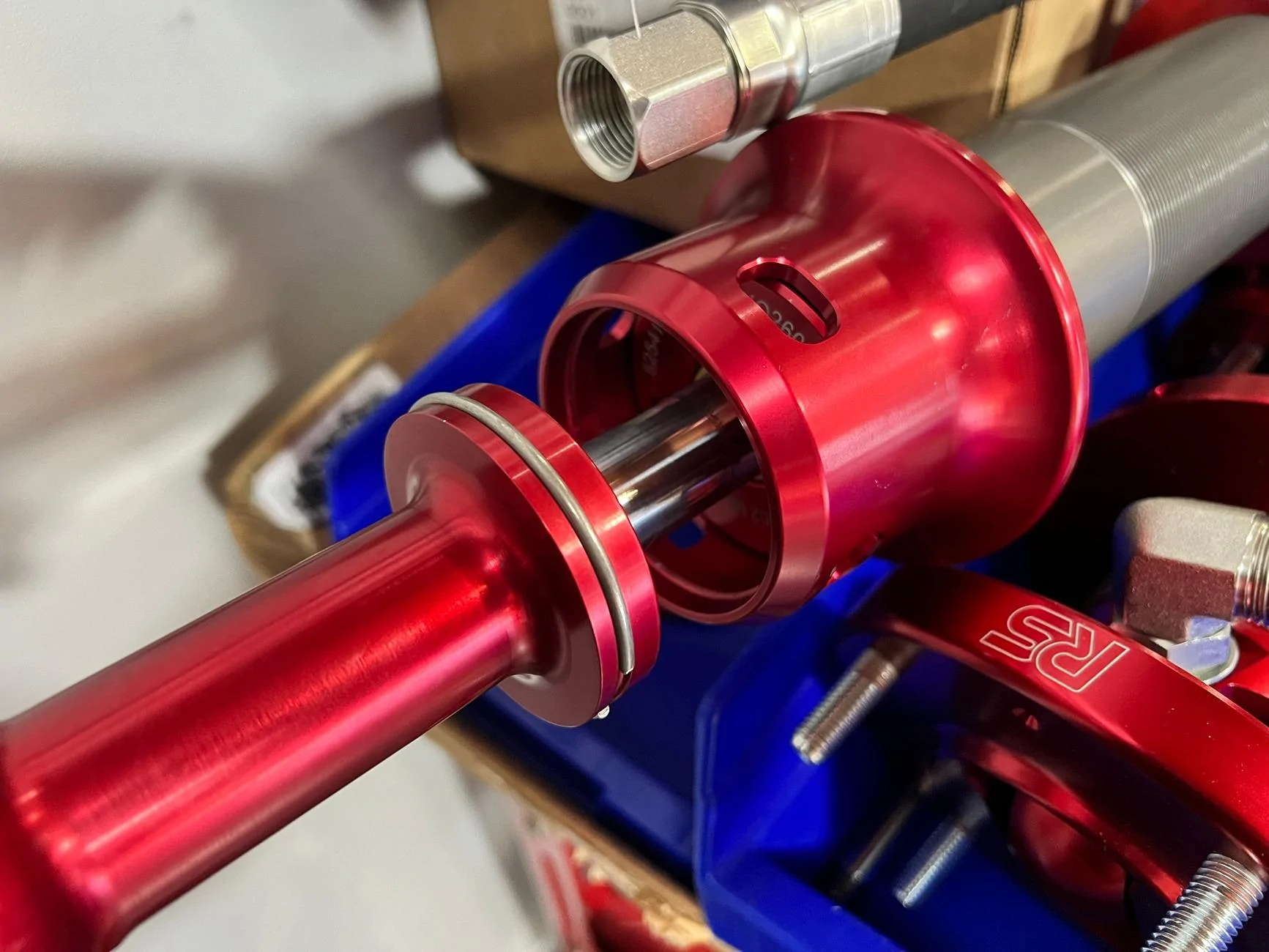

This is an optical illusion for most OEM fit coilovers. The lower spring perch is designed to have space on inside of it to allow the shock body to continue compressing. For Bronco's, a lot of these shocks will have shaft bumpers as well, so you may not be able to see the shock shaft through the drain holes in the lower spring perch.

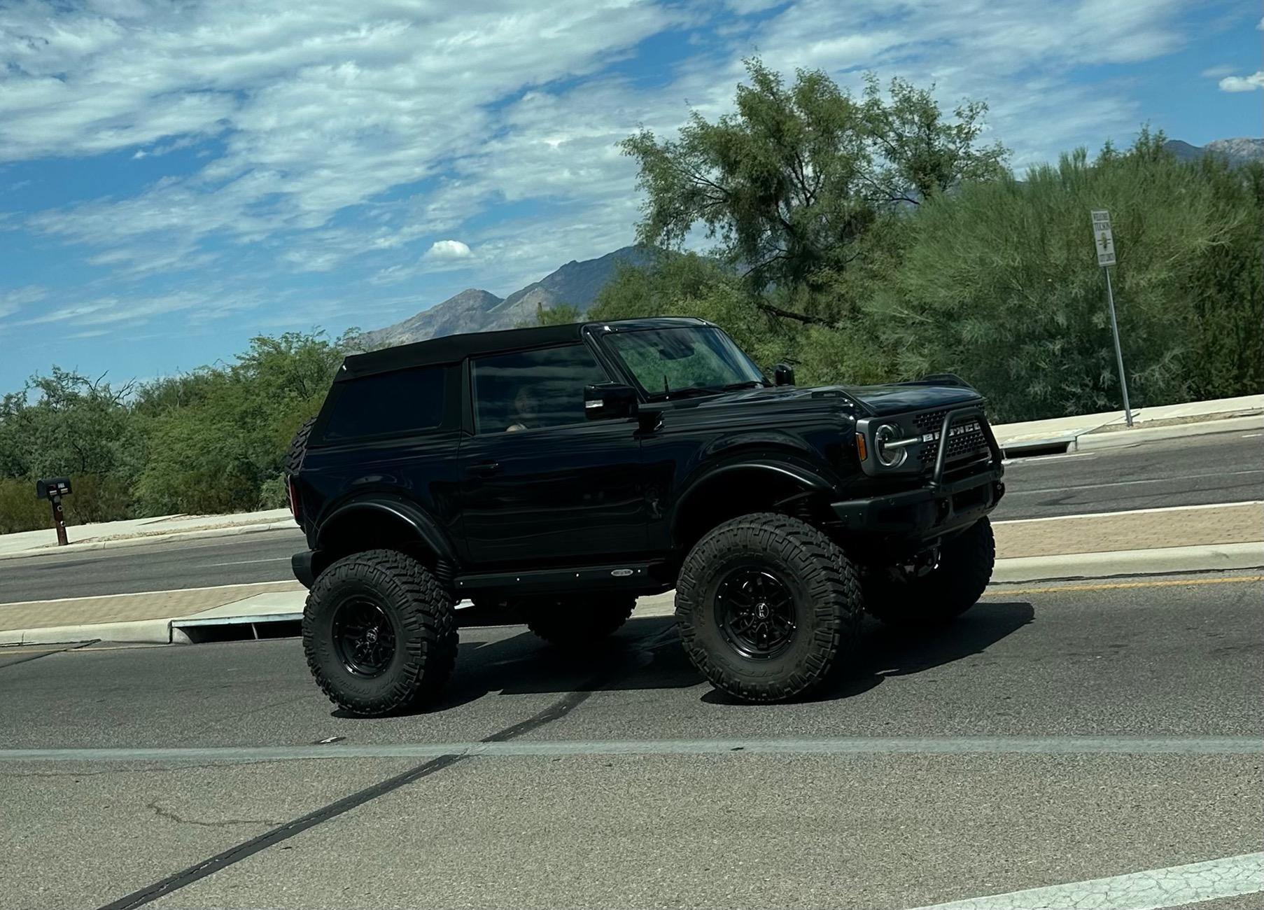

Oh yeah, 4x4 Lincoln Town Car amiright? lol

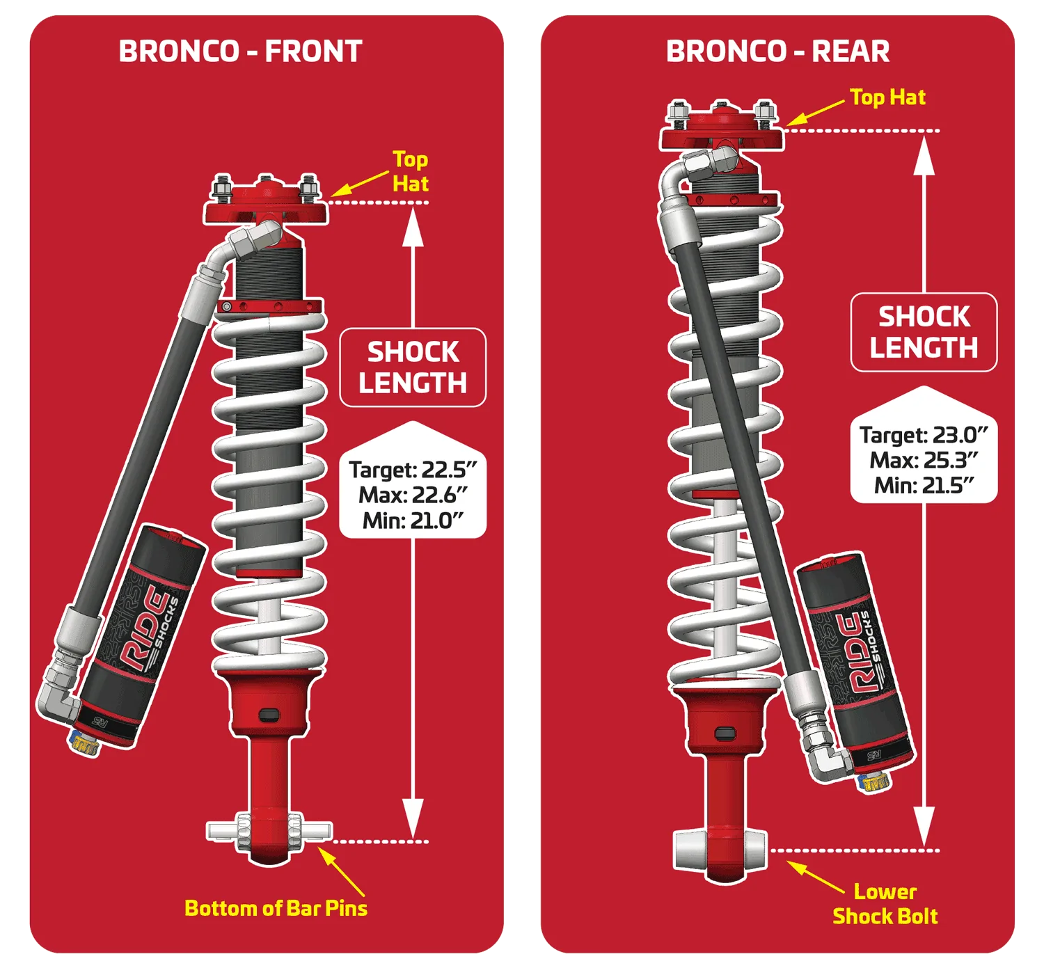

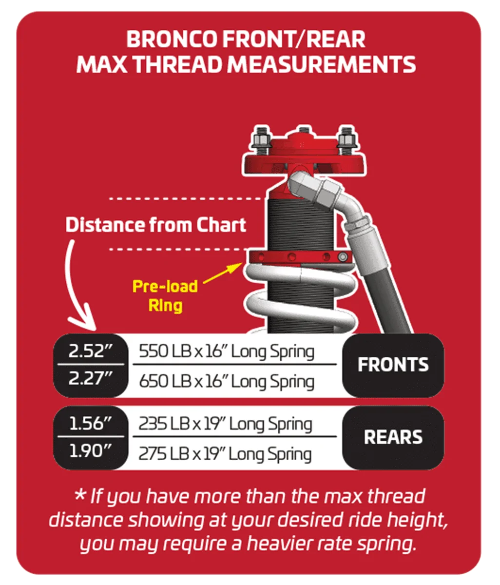

Raising or lowering ride height, within reason, is not going to have a big affect on ride quality. Our Bronco is mostly stock, so I believe no adjustments were made from how they come out of the box.
We have target numbers to hit in our setup guide depending on which springs/shocks you get.
For example, the diagrams below show our target, min and max lengths we recommend for the coilovers, when they are installed, on level ground and settled.
