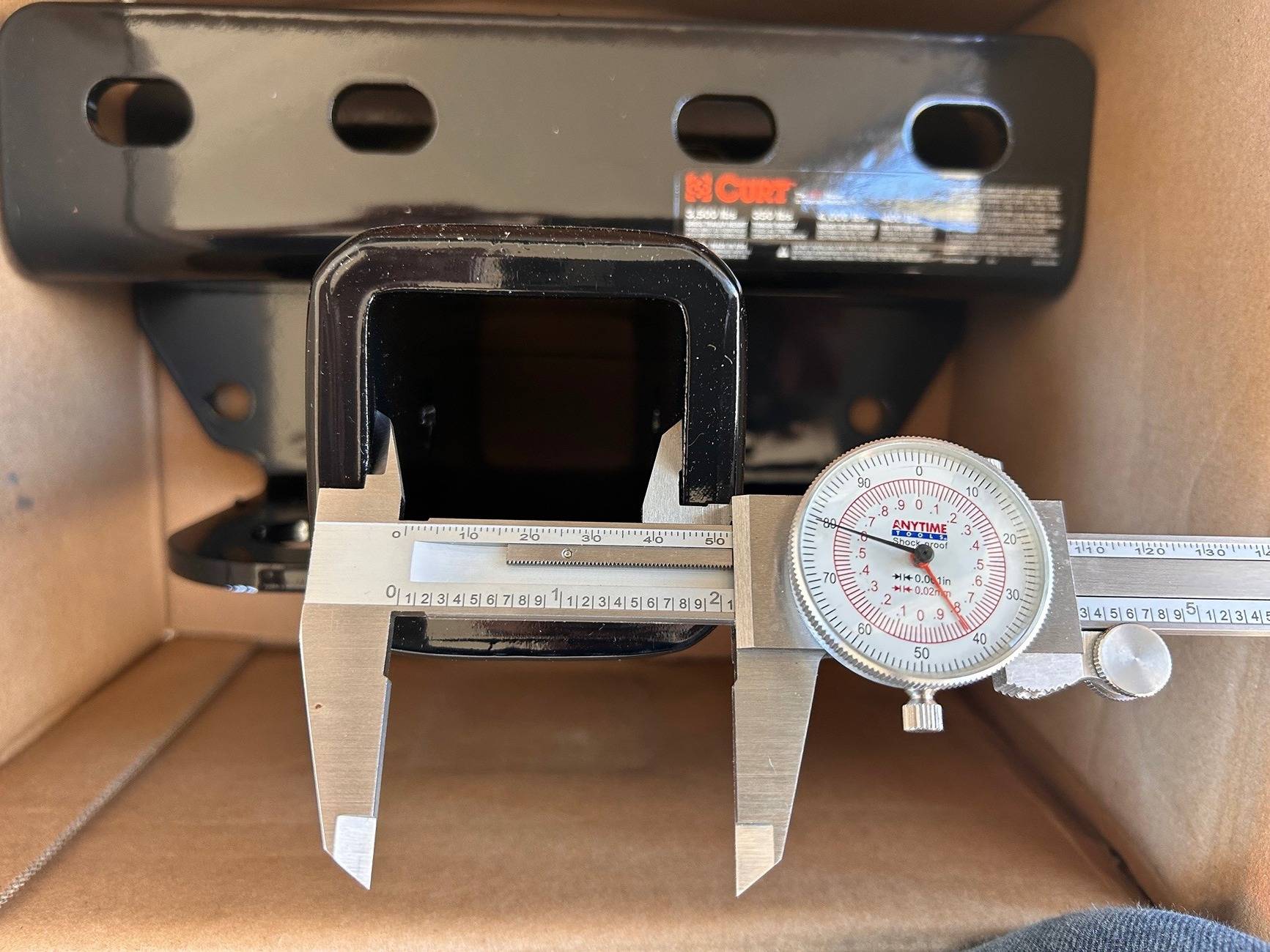

I have the Kuat Pivot 2 with the factory tow receiver. It is very secure after tightening.
In your video it looks like the receiver is significantly larger than the factory hitch.
I measured my Kuat and receiver with a caliper. The Kuat is exactly 2 inches, and the receiver is 2.07 inches.

I also have a Curt hitch I never used because my Bronco has the factory. It is slightly larger than the factory receiver at 2.079 inches.
Factory on my '23 measured 2.070.

Replacing it with a Curt version was on my short list of solutions, this is what I get for going with convenience. What’s the measurement at the rear of the receiver? I suspect that’s the main issue here, it’s not square all the way through

Rear of factory hitch 2.051 inches.
Rear of Curt hitch 2.084 inches.
I installed the Kuat Pivot 2 into the Curt hitch. It tightens and is very secure.
