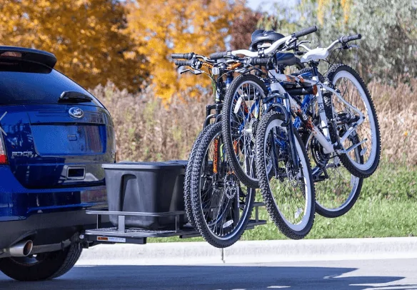

Looking for Basket Cargo Carrier with Receiver and 4 bike ability. Looking for something like this that will work with Braptor. Thanks in advance. Needs to have room for at least a couple coolers and two adult bikes and two kids bike - 4 total.

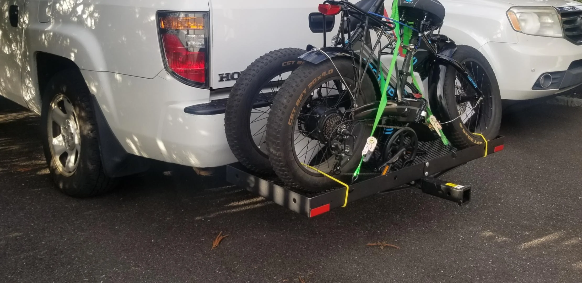

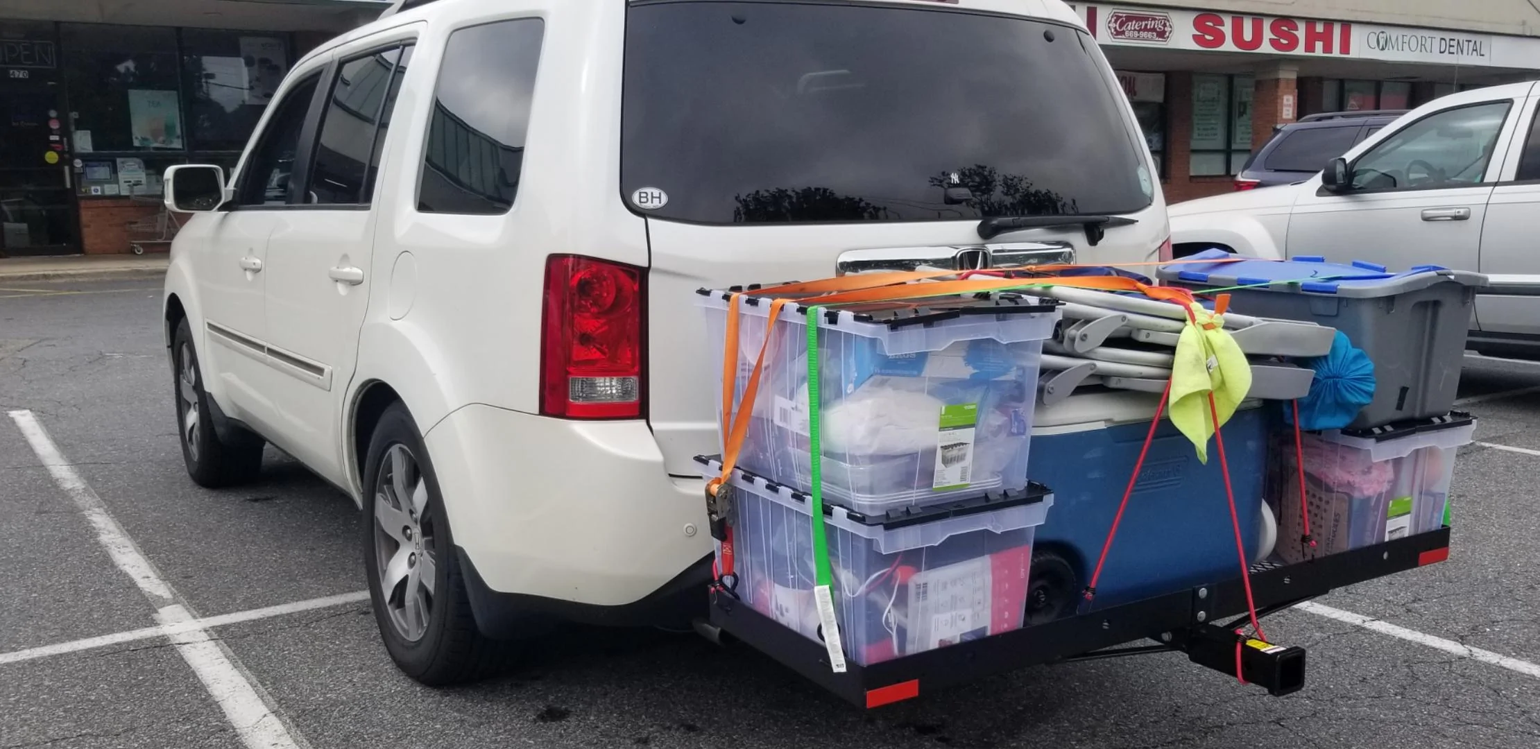

B-Dawg BD-60203-TO Towing Dreadnaught Cargo Carrier
*the dreadnaught is bigger and stronger than the drone. Also, make sure it ends with "-TO" so you know it's the towing version.
Can find for $300ish... again, just make sure it's the "towing" version so it has the 2" female receiver at the end.
Then I use a Thule Parkway 4 bike carrier (~$250). The combo works great and is very strong. I've carried 2 ebikes on the carrier and 4 more bikes on the Thule. I've also had 2 full coolers and 4 bikes. No problems.
*Attached the only pics I had before I got the bronco and without the bike rack but you get the idea.

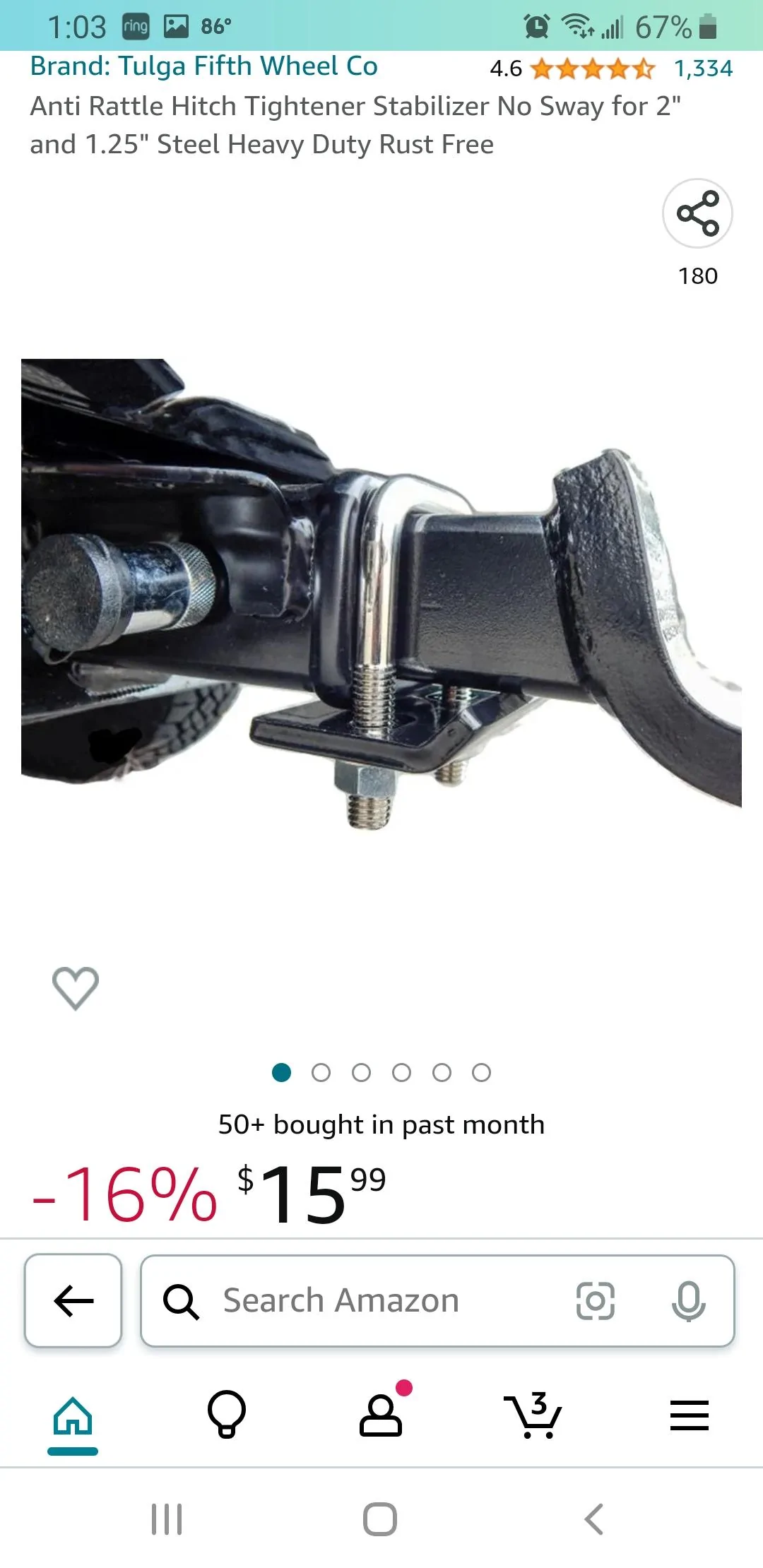

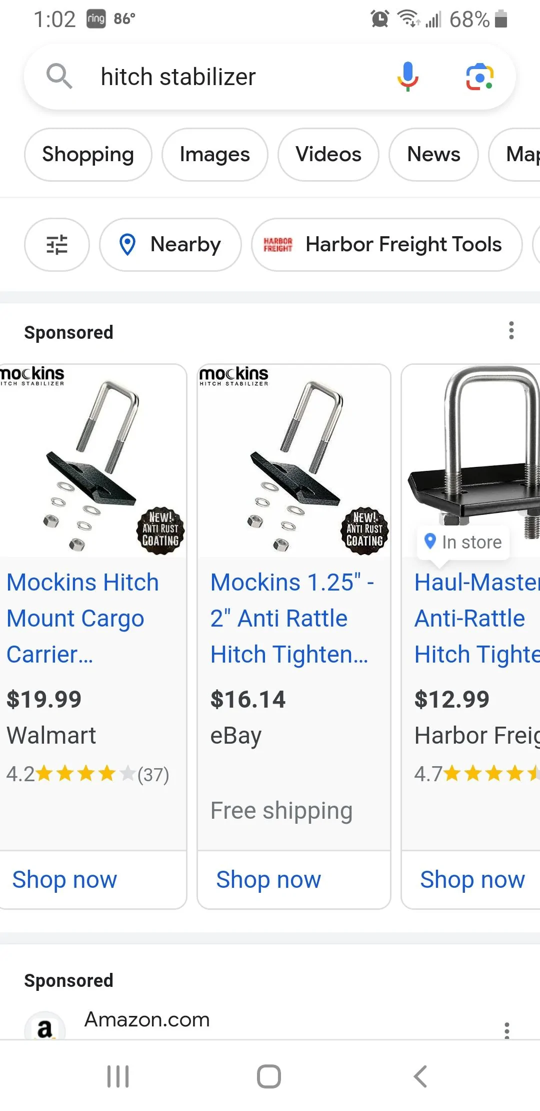

I forgot to say I highly recommend you invest in 1 of these. (The carrier comes with one but you would need another one for the bike rack) They tighten everything up so nothing bounces around. It feels way more secure while driving.
