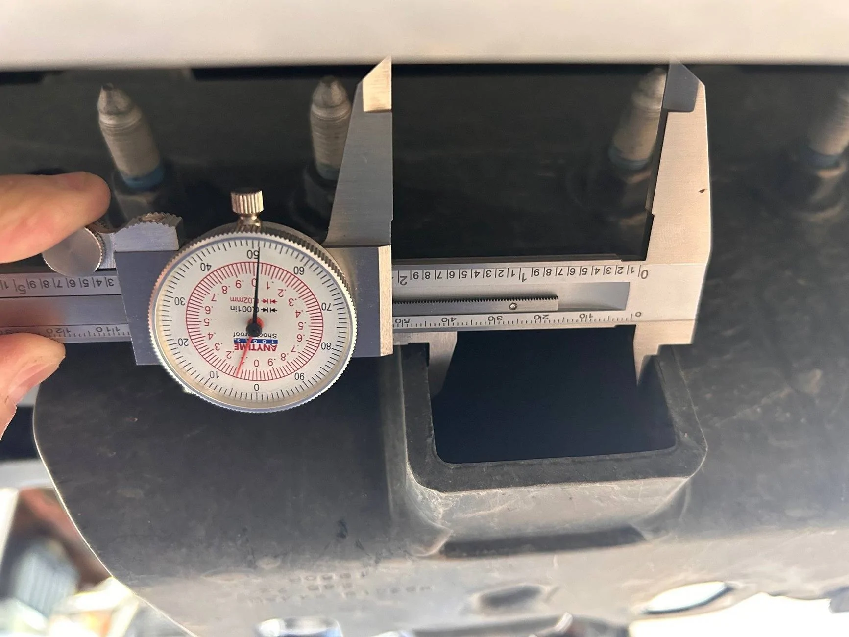

Rear of factory hitch 2.051 inches.

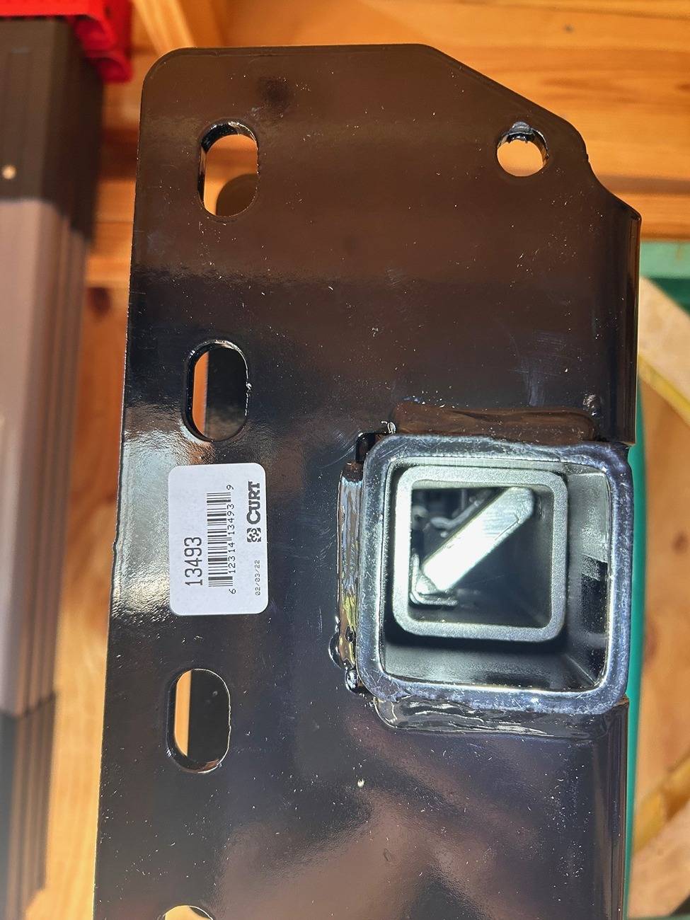

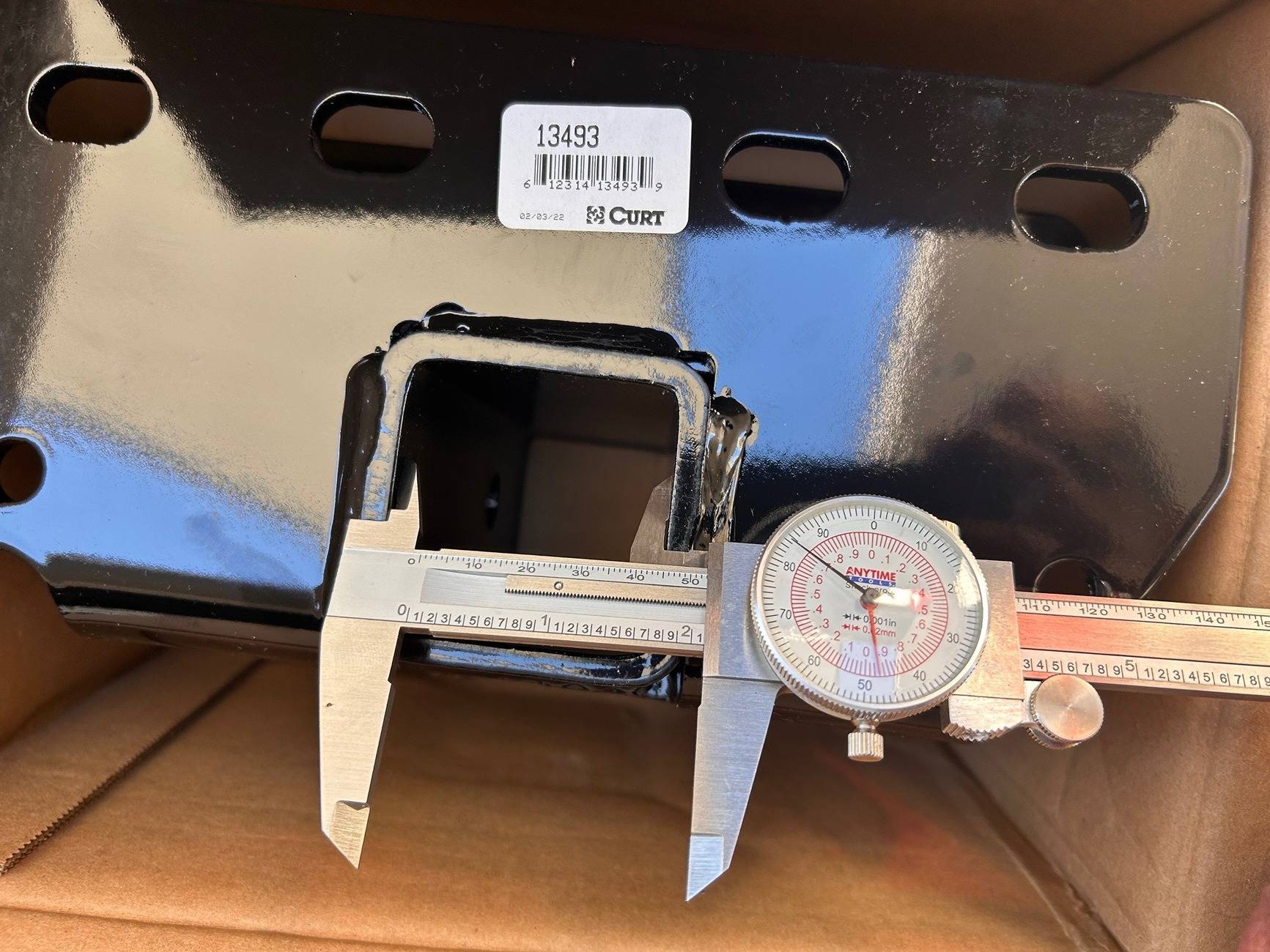

Rear of Curt hitch 2.084 inches.
I installed the Kuat Pivot 2 into the Curt hitch. It tightens and is very secure.

Thanks so much, that is a huge help. Appreciate you taking those measurements, I’ll probably have to replace my hitch with a Curt one

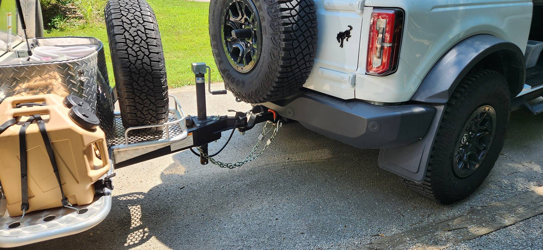

Put a extended ball mount in my factory hitch so my trailer jack would clear the spare. Installed an anti-rattle from Amazon. Rattle and slop in reciever solved. Even with the extended ball mount I am still well within specs for my load.
