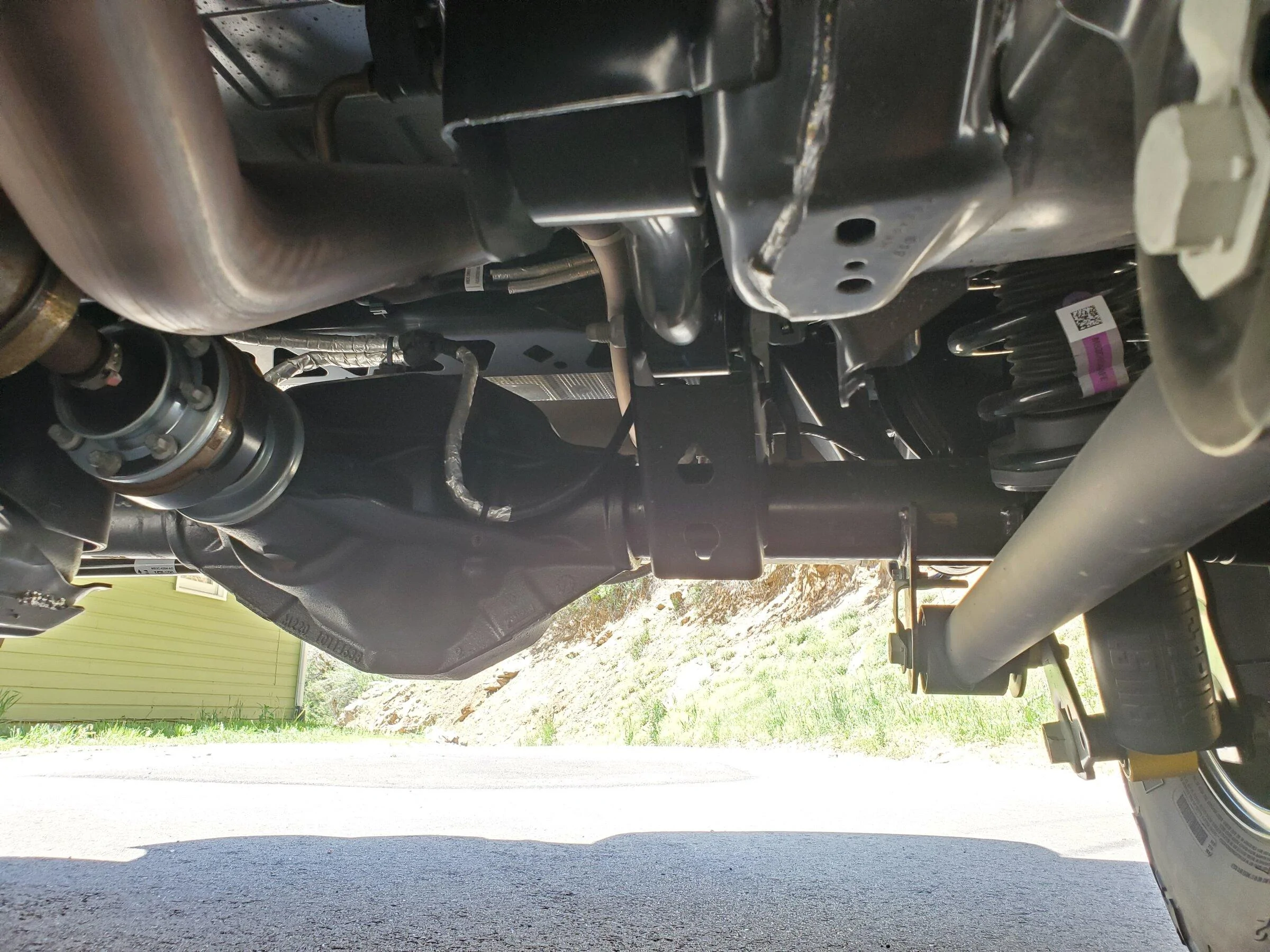

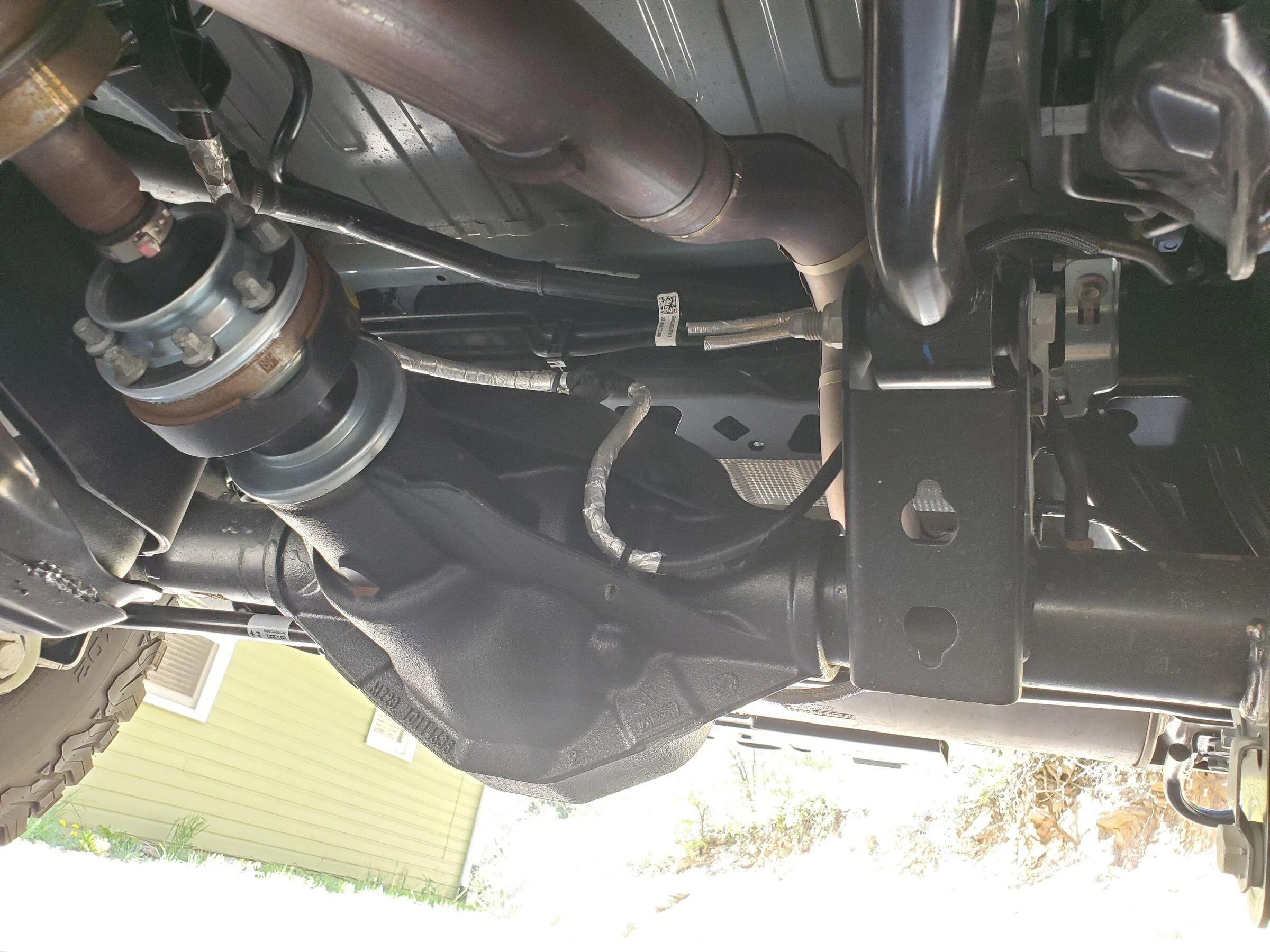

Edit: nevermind this is the track bar...
Ford Bronco Rear Too Stiff 20220608_101605
broadicustomworks
Aug 25, 2020
42
4,109
16,691
Hanging Rock, North Carolina
It's this bar behind the rear diff right? Looks like I do have one. Also looks pretty simple to remove, just two bolts. Maybe I'll try taking it off at some point and see what difference it makes...
No, that's your track bar.

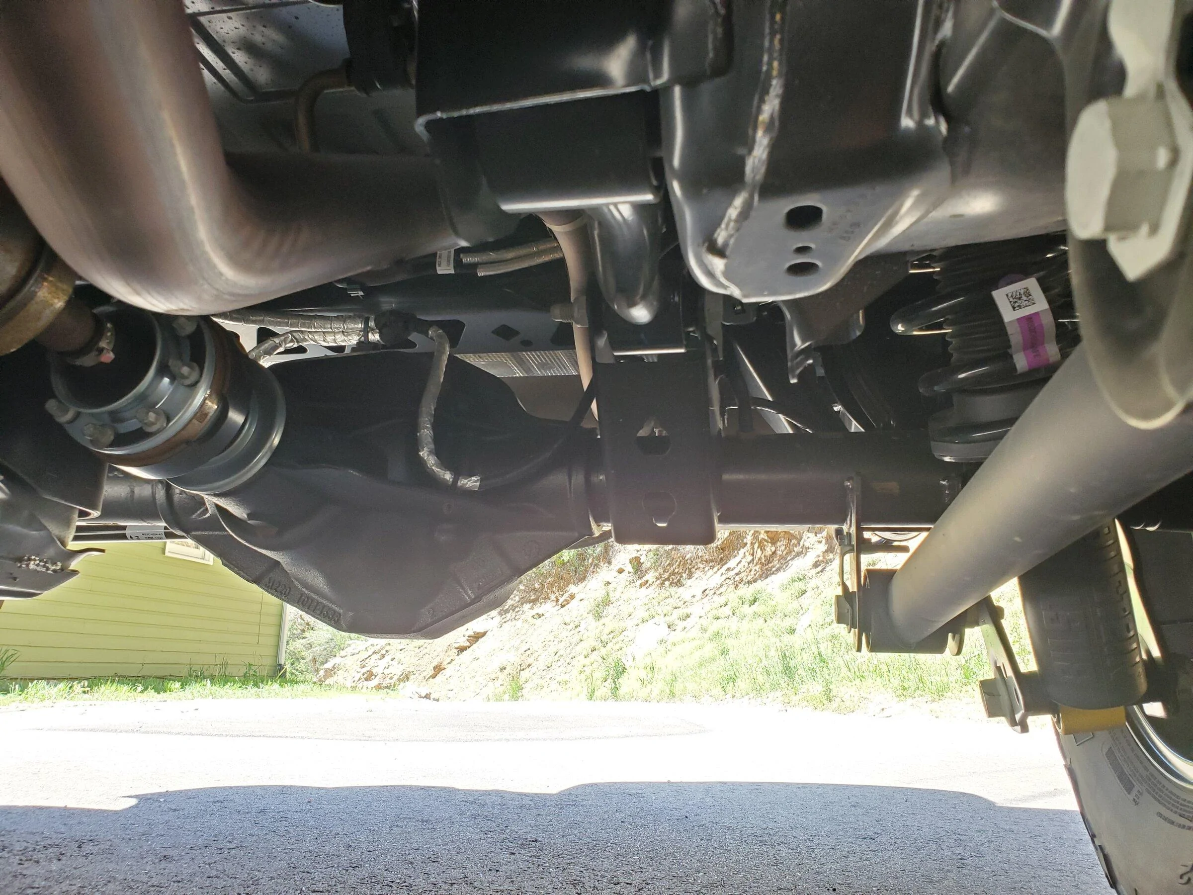

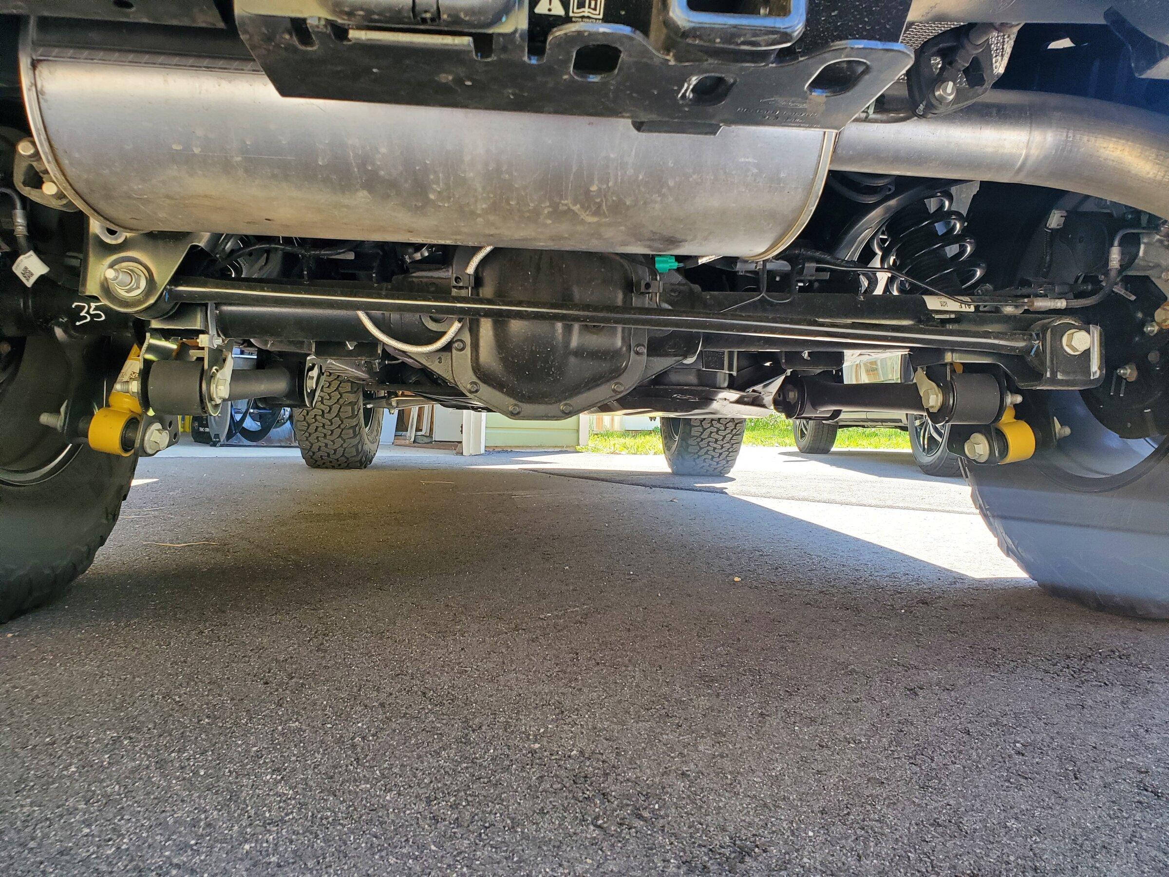

Duh.. shows how much I know about suspension components.
Looked up a proper picture of the rear sway bar and confirmed I do not have one
Ford Bronco Rear Too Stiff 20220608_111632
broadicustomworks
Aug 25, 2020
42
4,109
16,691
It's all good, buddy. None of us know until we do about anything.
Before I had my first Jeep and did a suspension upgrade I wasn't sure what the technical names were for some of it either.
Out of some old bad habit I STILL call the rear trailing arms "Rear Control Arms".
