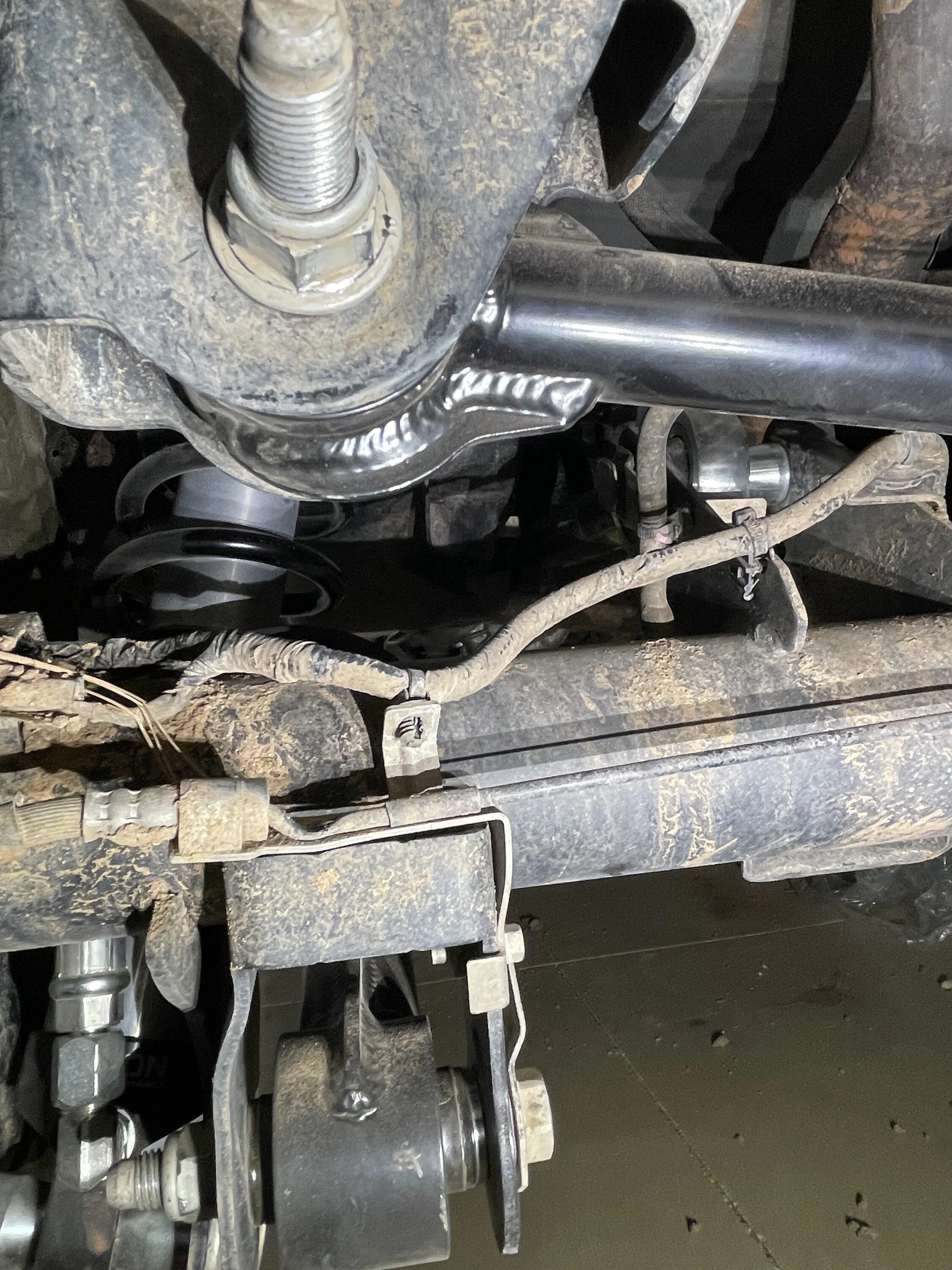

Ralphramst
Ralph
Nov 8, 2020
68
Carlsbad New Mexico
Jeep rubicon, F150 Limited
Ford Bronco Icon rear suspension too stiff (my error, solved) IMG_1383
Stage 7 ICON. Make sure the bolt is in the right way😃 voice of experience. I put it in backwards by mistake and then took it for a ride.
easy fix once I figured it out. Took a week to get a new brake line

I did recheck it. Seemed like axle was about 3/16” to one side. I adjusted it but nit
Well .... I did the same thing. Dang it. That's why it only had 1" of travel. Thanks for the warning, but it was too late.

Embarrassing Update: I put the upper track bar bolt, the one that fastens the track bar to the frame, in backwards such that it was sticking out over the axles and brake lines. It's a long bolt, longer than it needs to be. You don't see the interference when you have it up on the lift and suspension hanging. So the bolt was hitting the brake line and bracket. Instead of 14" of rear travel, I had 1". Damaged brake line so have to be without my ride for a week while part comes in. Thanks everyone for your help, unfortunately this was a stupid mistake by me. By the way, I was quite pleased with the service help I was getting from Icon. They went up a notch in my book.
