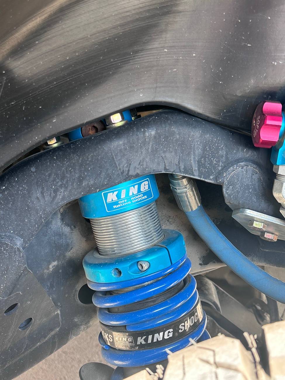

So I’ve just recently installed king 2.5 shocks on my 2-door Big Bend non sasquatch. The shop that installed it for me told me he had dropped down the psi in the front to 130 and 160 in the rear. I’m running 315/70/17 tires all terrain at 35 PSI. I haven’t changed the coils, everything is factory from king. I don’t seem to know what the problem is.. It’s running quite harsh and stiff. Whenever I go over a speed bump at a speed, I feel like the rear tires fly up. Could it be that I have lifted it too much? Too much preload?

Soften the compression and rebound. Start at the softest setting and work up as needed. You may end up lower the nitrogen pressure in the rear. 160psi sounds high to me.

I wouldn't recommend changing the PSI. Thats not how you tune a shock. These shocks are designed to operate at a certain PSI rating and King is typically 150 PSI.
The shocks you have are an early model with the dual rate spring kit. They have since switched to a single progressive rate spring. The new spring is capable of holding more weight, much better option that the dual rate spring kit you currently have.
The rear Bronco King Shocks come with digressive pistons, but the fronts do not. Not all King shocks come with digressive pistons.
The adjusters on King Shocks is a mid speed compression adjuster, there is no external rebound adjustment.
For ride quality issues, this is 100% what we specialize in. We must first make sure the spring rates are adequate for the total weight of the vehicle, from there we confirm shock lengths and amount of preload. If the setup is good, then we would recommend sending them into us for a revalve. In this case we would definitely recommend linear pistons. Depending on added weight, we have (2) different multi rate springs that may be a better fit also.
If you would like to explore some options, shoot over a message and we can help you out.

Thank you for replying! I tried adding weight to my bronco in the rear and I took a speed bump at a high speed and it was waaay more comfortable. Note that I have a spare tire delete in the back. Could it be a weight issue? spring rate ?

Did the shop torque all the suspension bits up while it was all at full droop, instead of on level ground?
Yeah they torqued it at full droop

Hard to say with out our sales guys running through your entire setup to see what sticks out. I recall those springs being too light, even for stock weight.
Made it 120 PSI in the back and 150 in front and now it’s fine. I thought about lowering it more but I don’t know if having a low psi will damage the shock or not.
