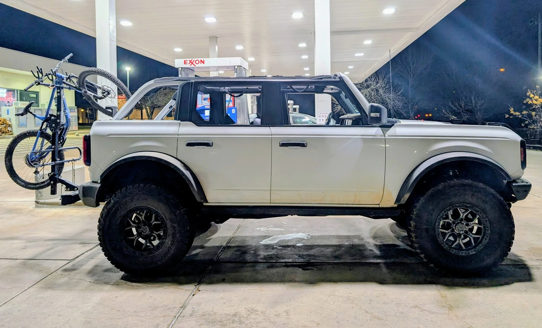

Affirmative:
Kuat v2 swing out: 40
Northshore Bike Rack: 50
Ez4x4 Trunk: 60ish
Ez4x4 Drawer: 30ish
Tools/bike gear 15ish
So that's about 200lbs over or behind the rear axle. Add on bikes at 35ea, although it is mostly just one these days...
Rides great! The constant weight on there is one of the reasons I sold a set of Hoss3.0 takeoffs, just figured given the position sensitive damping I'd be better off with Icon HD.
Pic below is day of and wo the top, doesn't sit quite as tall now!
Ford Bronco ICON CDEV 2.5 suspension PXL_20260218_032446561.RAW-01.COVER~3

Affirmative:
Ez4x4 Trunk: 60ish
Ez4x4 Drawer: 30ish
