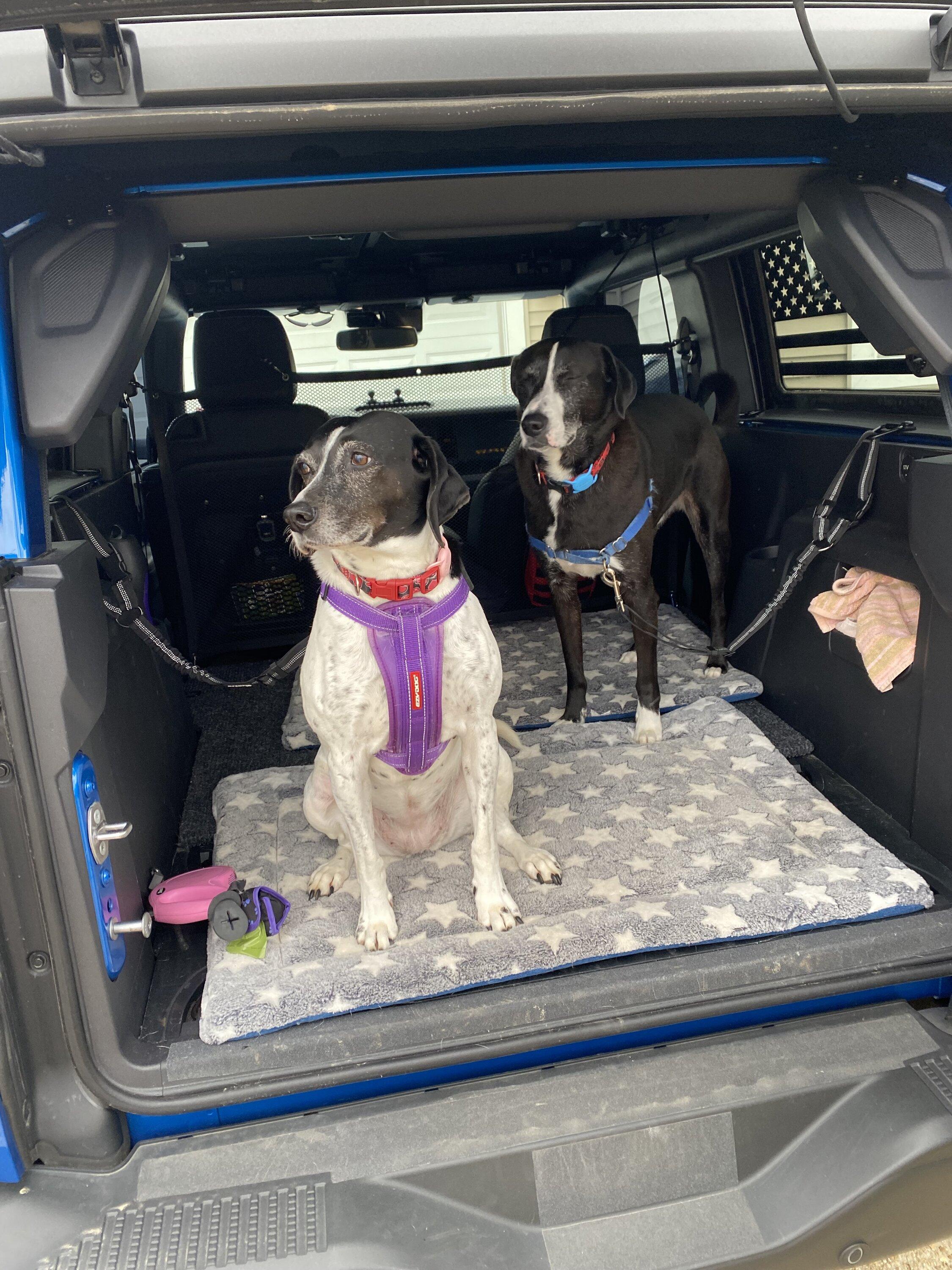

Nuked my back seats on my 2-Door and made a deck from wood to fit the contour. The deck fit just fine from the front to the back with out bolting down. Between the bolt tops, side seatbelt brackets and the rear tailgate lip it just fit level. Covered in a Lowes outdoor 5x7 rug cut down to fit. I have a working trapdoor that just needs just cut out that the carpet is still covering. Simple KISS design. Had to unbolt the speaker to get it through the back door.

That's perfect.
