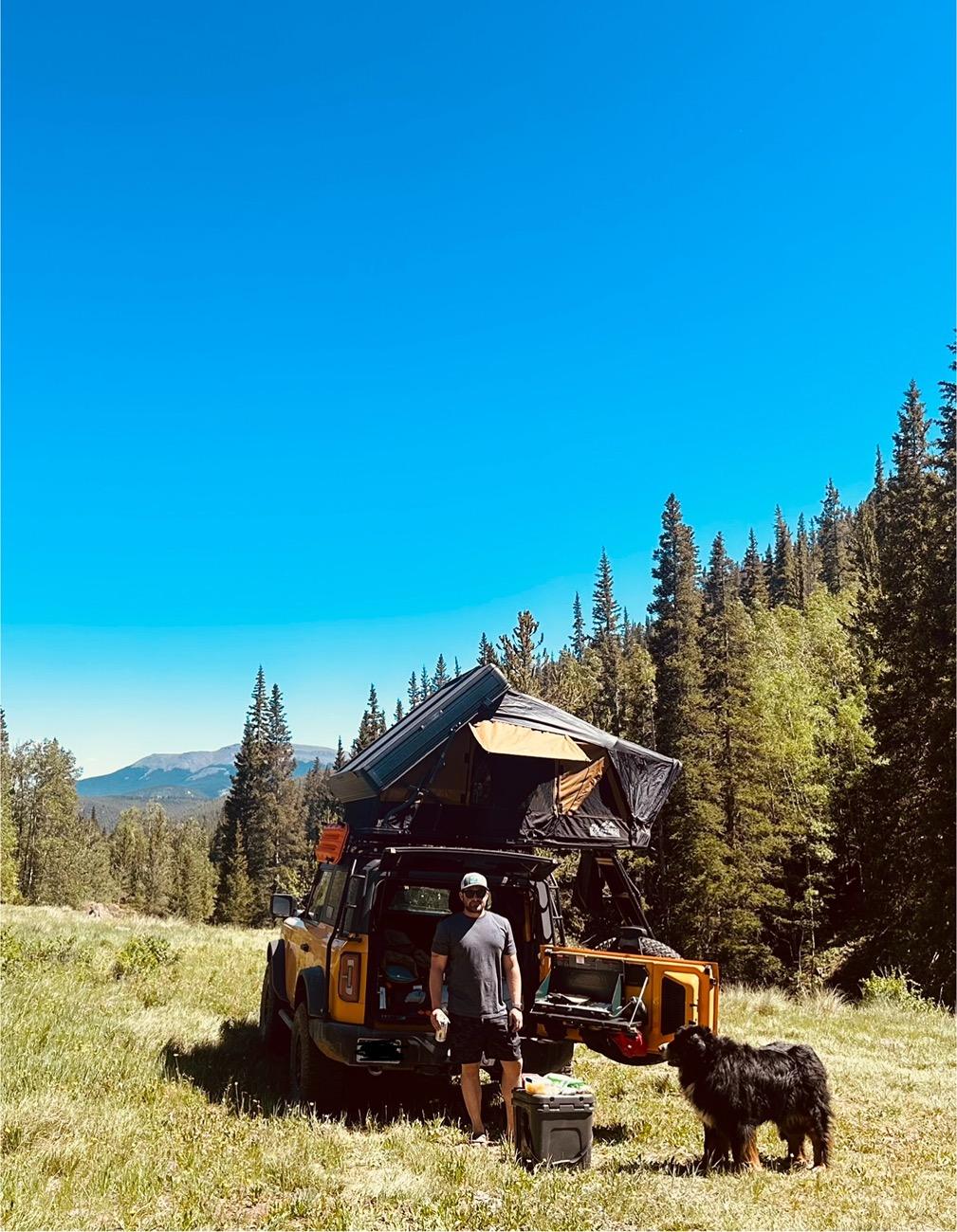

I’ve been positioning my build as an overlander and think it’s time to take out the rear seats and build a platform.
Wondering if anyone has plans for a ~4” platform that includes locking drawers and can support a fridge mounted on a slider.
Last piece I can’t figure out is including a “hidden” dog ramp that folds up and slides in under the floor platform. Imagine a giant slide out cutting board that pivots toward the ground when fully extended.
Any help or advice is greatly appreciated!

@CO_wildtrak Have not built my storage system yet but I’m wondering about your RTT. Which one is it and what rack is it mounted on. Thanks!

RTT is a 4x4 Colorado Alto Elite, mounted on a Gobi Stealth rack. Can’t recommend either enough!
