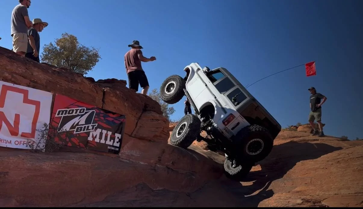

Honestly I mostly run with my rear locker engaged and only use my front when absolute necessary and/or I know I don't need any / zero steering input. if its that complicated, use the winch, its cheaper and wont get stranded. Yeah the front only locker is a thing, just not sure on this 6G.
Good examples for front use only-climbing something with an undercut and there is no other line available. Leaving the rear unlocked might let a tire slip back there to you aren’t putting everything into a bind as the front starts to climb. Not as good as an atlas but it does help.
Another good one is hard left turn on Milts Mile in Sand Hollow. The inside rear tire will be up on a rock and passenger side is fully drooped out. With the rear locked, the driver keeps climbing and you end up with a very exciting experience. Rear unlocked and front locked allowed the rear to simply pivot as the front pulled it around. Pretty boring video, that one.
Ford Bronco Rear locker can save a front diff. IMG_6801
If I have to resort to that, I just go up backwards with rear locked :p
