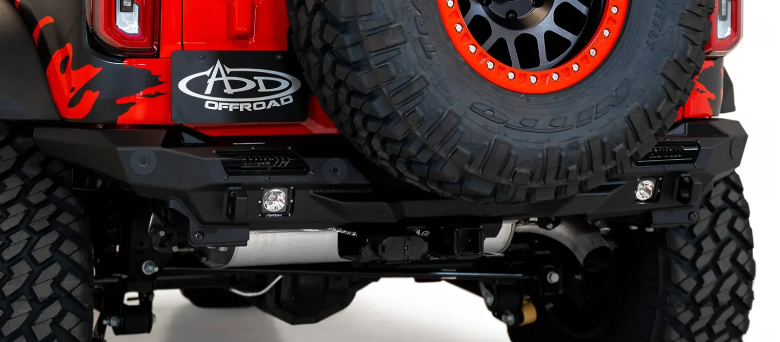

Does not sound like you have a bumper with pockets to mount them In. I use Baja Des. bumper pods on an Aux switch.
Look at the Diode Dynamic hitch light - especially the new one that has brighter light (I have the older one and it's great.)
4x4TruckLEDs.com has a kit that is made to mount 2 pod lights tucked under the rear bumper.

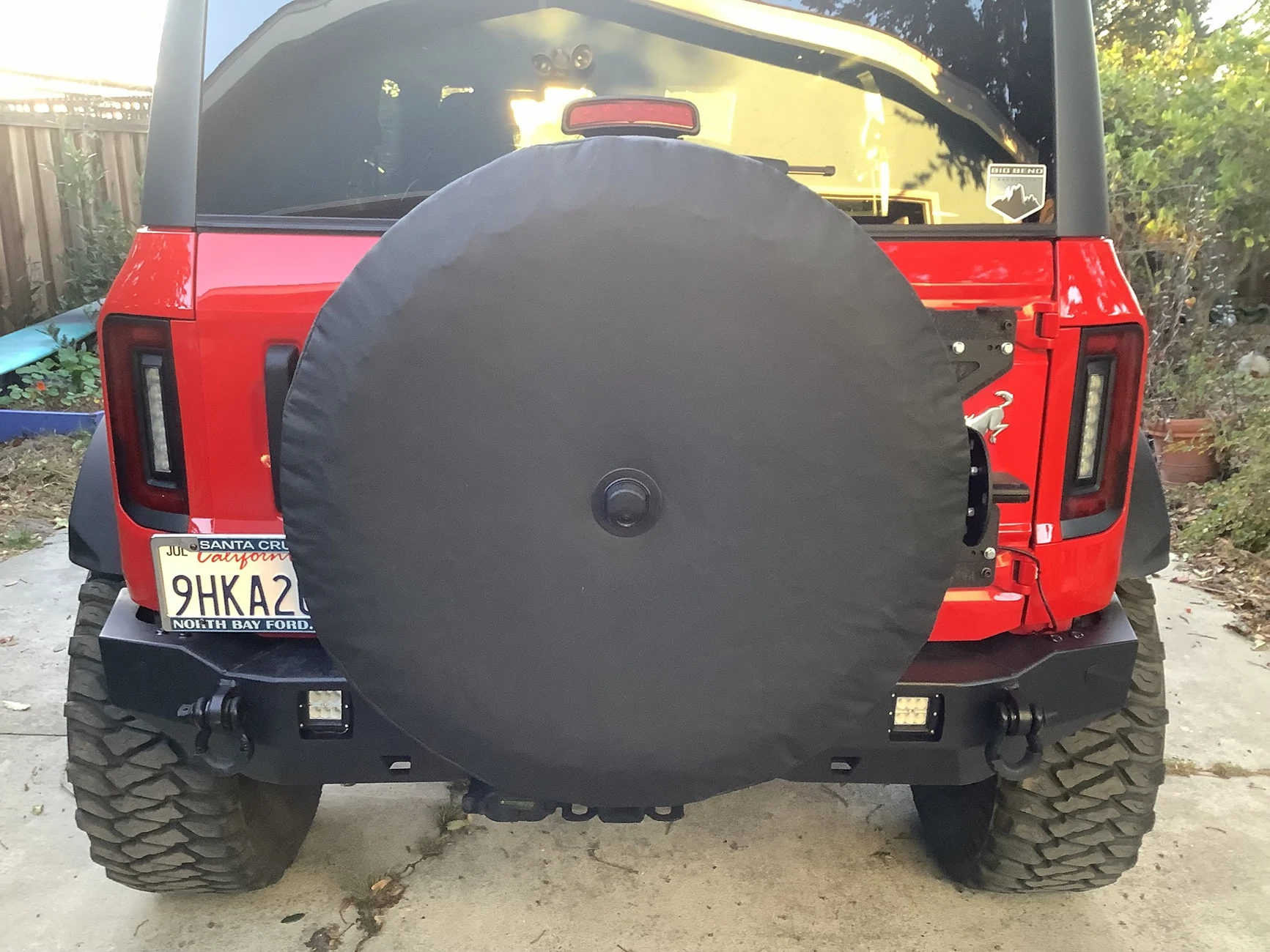

I have some generic 3” flood pods in my bumper…work well as daytime chase and backup lights but way too bright for camping…
Ford Bronco Rear Lighting Thoughts for Camping? IMG_0675

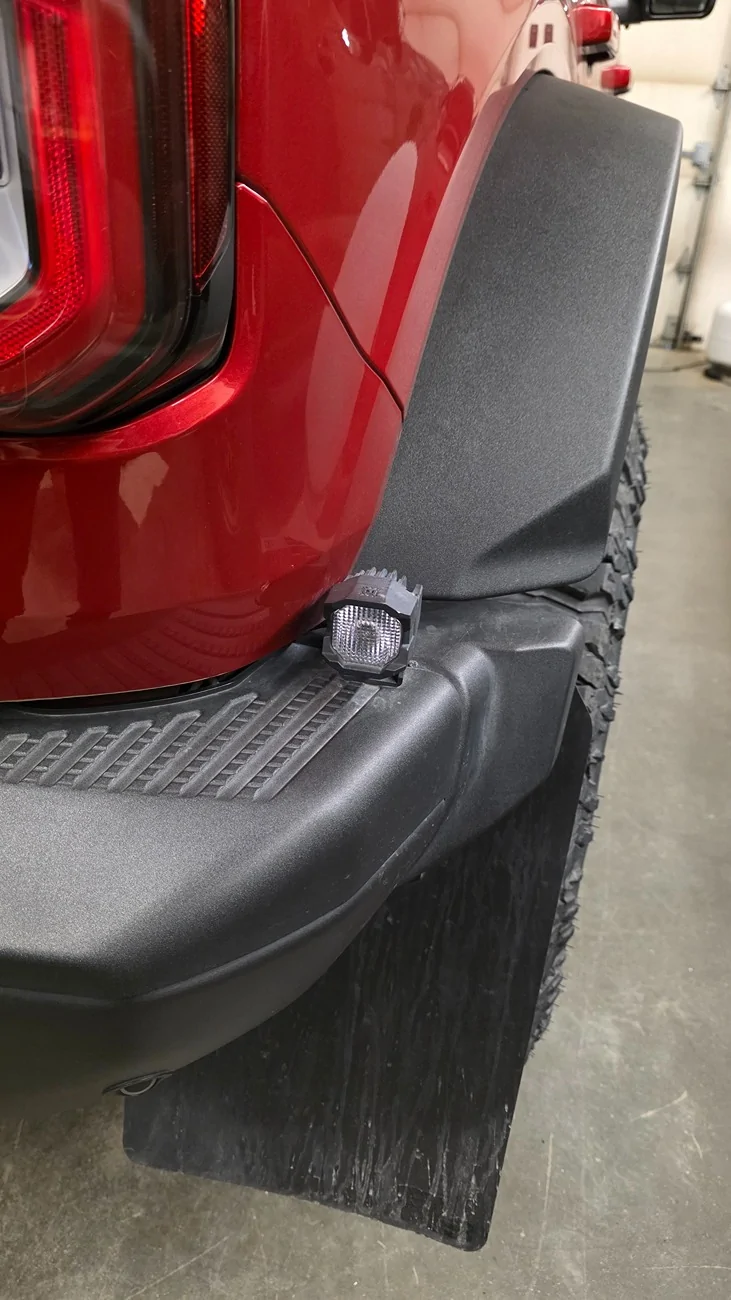

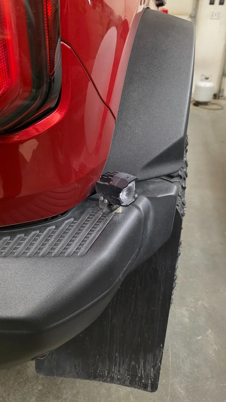

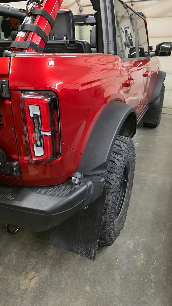

I went a bit different than most in that i mounted small lights on top of my bumper, not underneath or recessed in to it. I keep them tight enough that they don't move around on their own, but loose enough that I can turn them with my hand to aim where i want for use as a camp light. I also use a Switch Pros controller which means these can be turned on with a switch on my dash, or remotely from my phone without the vehicle being on. The Switch Pros is expensive but it sure is nice for this sort of thing.
Ford Bronco Rear Lighting Thoughts for Camping? 20250812_212502
Ford Bronco Rear Lighting Thoughts for Camping? 20250812_212509
Ford Bronco Rear Lighting Thoughts for Camping? 20250812_212526
