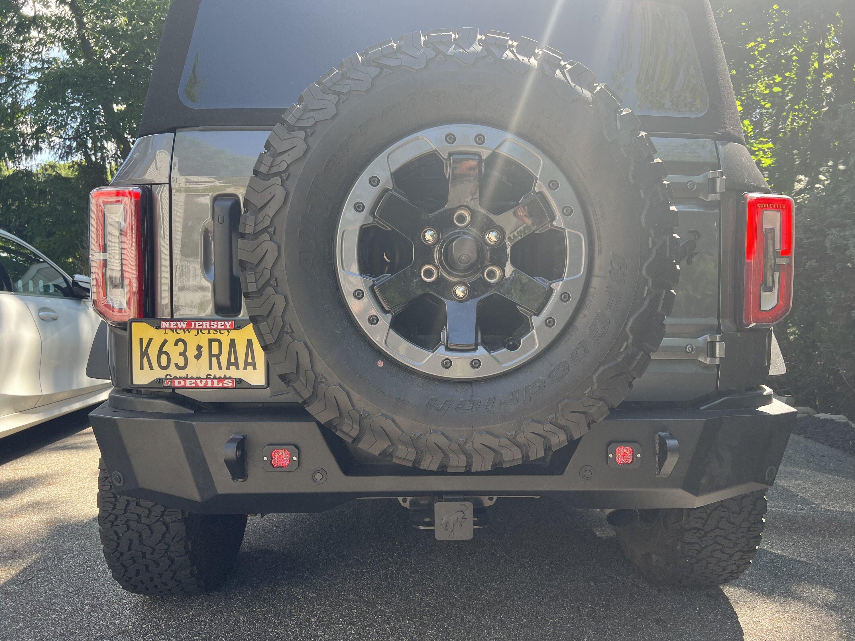

I did the exact same install with DD SSC1’s running a red backlight when the taillights are on and white in reverse and with an aux, however mine were installed in an aftermarket Barricade steel bumper that did not have cutouts. Cutting through the MUCH thicker steel on that bumper vs the stock badlands bumper was a real pain in the butt, but it looks and functions perfectly!

mhorvath1218
Jan 1, 2022
92
134
NJ
2022 Bronco Badlands
Looks great. Like it was born there. I used a 12v Milwaukee jigsaw and three blades. They were crappy, but they did their job.
Thanks, that was the goal. This stuff took about 15-20 drill holes with a carbide bit around the perimeter of each, then a heavy duty dremel cutting wheel to fully cut it out, then lots of sanding/grinding to smooth and paint to rust proof. Ended up being more work than I would have liked, but it came out nice!

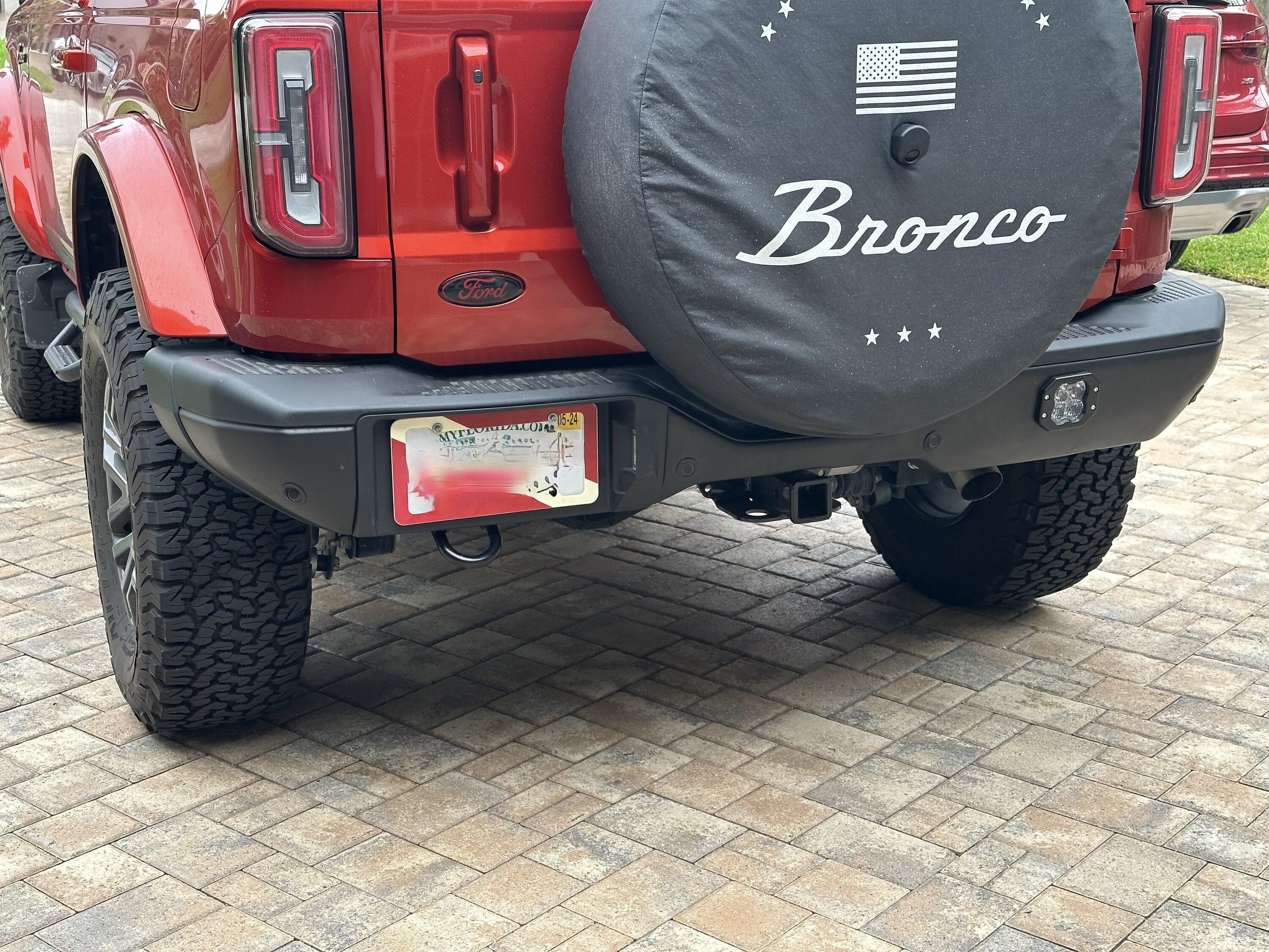

Jeffola
Jeffola
Jul 7, 2020
194
152
Southeast Florida
2023 Bronco, 2023 Hyundai Santa-Fe, 2019 GT350
Not too bad at all. Used patience and a drill to cut the corners then a few jigsaw blades later I had a square hole. It was metal. I lined it up with the frame horn as I recall for the wiring and clearance.
