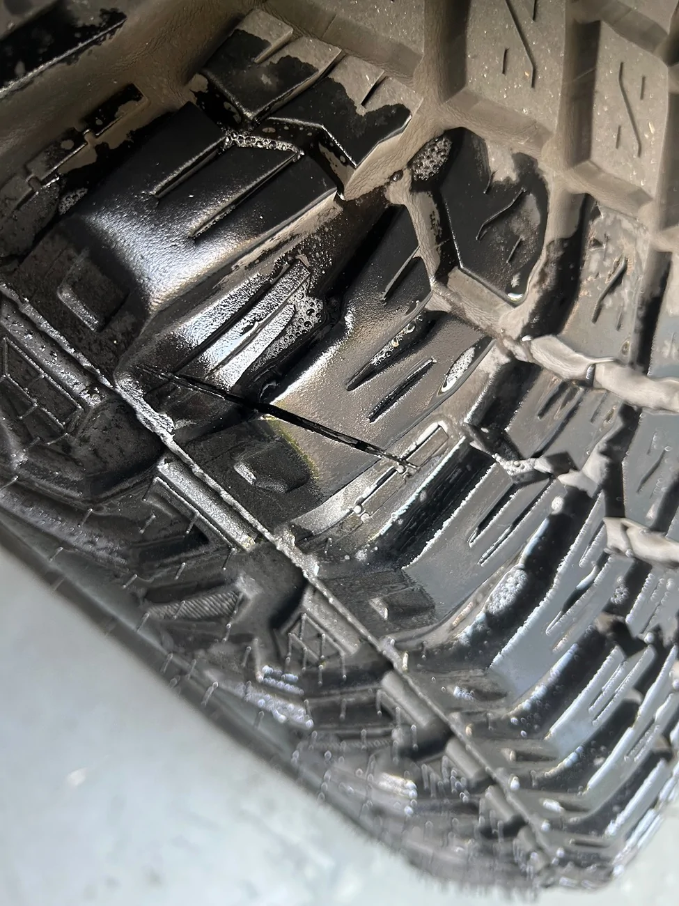

*Click click click* sound coming from the tires. Probably just a rock (as usual), will check it once I get home.
Ford Bronco Razor blade in GY MT - Advice? IMG_2004

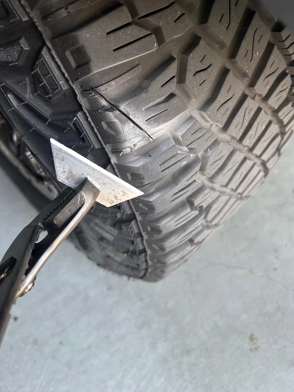

Yikes! Full drywall blade embedded in the tread, nearly flush (1/2 inch at least, not quite up to 3/4 inch). Pretty deep. Soap test is good. TPMS monitoring drive to work, still good.
26k miles and 3 years on the OEM tires. I was hoping to get at least 35k out of them before springing for KO3s.
Options? Might buy some vulcanizing tire seal and slap it on there as a start. I could put the spare on but I haven’t run 5 tire rotations, so it still has full tread. Could get a shop to match the wear down on the spare? Anyone run into this before? I almost wish it was losing pressure so I could just go buy new BFG tires but my wife would probably give me the eyeball. Don’t really want to run the spare outright unless I can match tread depth - not sure if that will put strain on anything over the long run.

Personally, I wouldn’t run that on the highway at 70-80 mph. That’s past the tread and hard to tell how deep into the plies it is. Given that it’s at the shoulder, it will eventually fail, and maybe blowout.
(Edit: A nail or screw wouldn’t concern me. This isn’t that. )
If it gets noticed during safety inspection, they might fail you anyways. At least in some states.
If you don’t want to buy a new set, shave your spare to match and mount it. Make the cut one your new spare and consider pre-emptively patching it under the slice.

I'd not worry a moment about that razor blade.

Its hard to know how much of the cord is damaged. Personally I would keep running it and keep an eye on it. This is on the tread, not the sidewall. It looks like you have a lot of tread left, pretty good for 30K miles.

Just consider it extra 'siping'. 🤣
That corner will now have just a little better grip in wet/icy conditions.
I've done and seen much worse.
If it's not leaking, I'd probably just ignore it.
But if you're concerned, take it to a quality tire shop and ask them to unmount it and do a thorough inspection. Key word there, though, is Quality. Be aware that some shops will take that opportunity to scare (hard sell) you into getting new tires. A quality shop will give you an honest evaluation and then let you make up your own mind. They can also make recommendations on making the spare usable long-term.

That hasn't punctured anything - so long as it doesn't cup off a big chunk of the tread at some point (at which point I still don't think it will explode or even lose air, just maybe start to vibrate / out of balance), yeah I'd keep running it.

Normal transfer case, I would throw the spare onto the Right Rear and use that as a spare.
Advance transfer case, I'd shave down the spare first.
