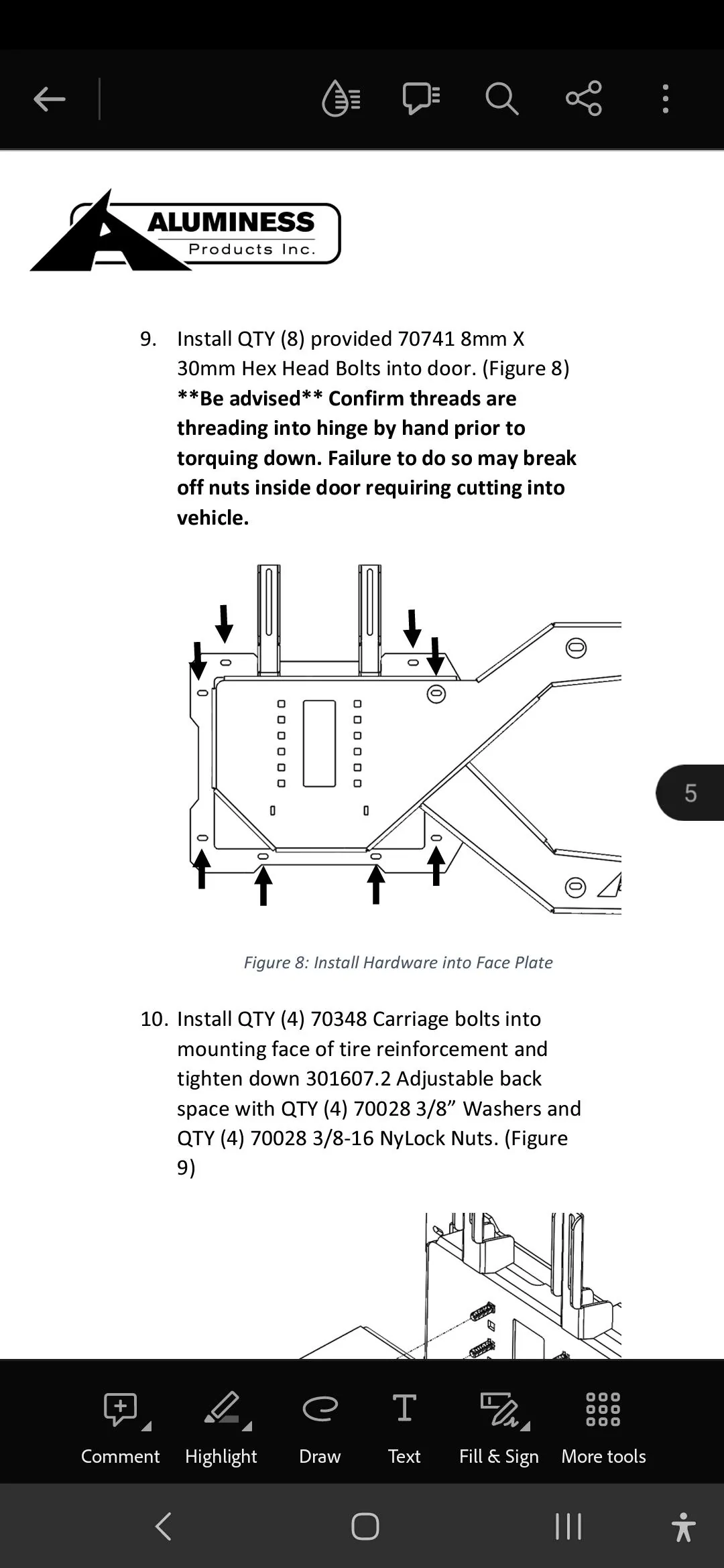

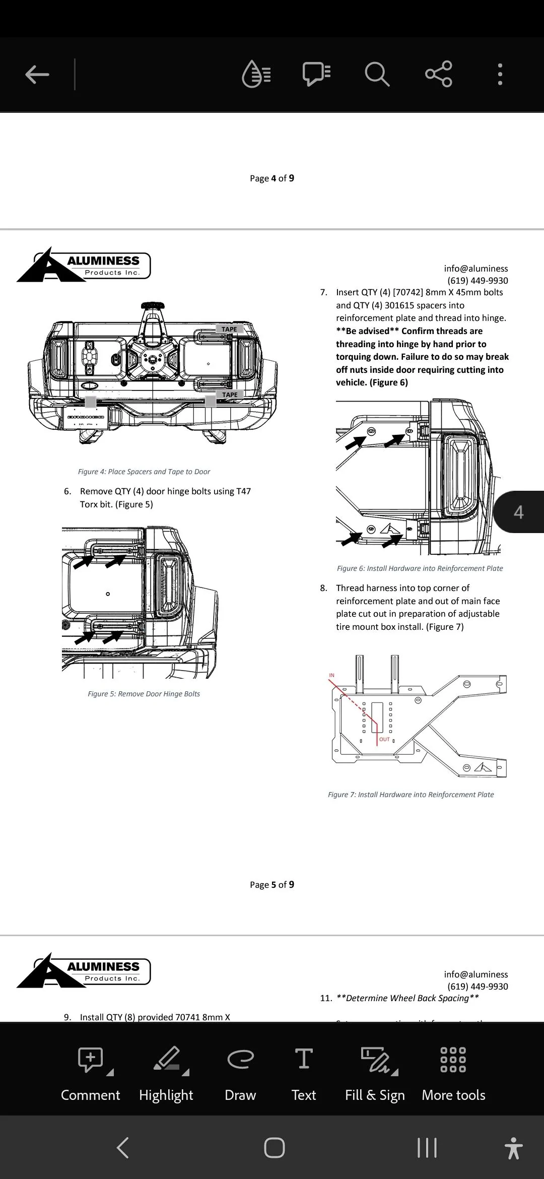

Hopefully your Wildtrack is living in your garage soon! I checked and your Aluminess does use conical spacers:
Ford Bronco Raptor Tailgate Hinges installed with Hammerbilt Bracket Screenshot_20230611_062938_Acrobat for Samsung
Ford Bronco Raptor Tailgate Hinges installed with Hammerbilt Bracket Screenshot_20230611_062903_Acrobat for Samsung
Yes the Raptor hinges are beefier and have their associated benefits but unless you're carrying a whole lot of weight in addition to your spare it should not be an issue using OEM hinges. The reality is that no one I know of has ever reported a failure of an OEM hinge and it is my humble opinion it is more about the fact that the OEM hinges are curved and tapered so that bolting anything to them securely without a spacer is unlikely. If you do decide to go with Raptor hinges, I would imagine that you could easily sell the setup you have to one of many folks on the forum who want to stick with OEM hinges. The Raptor hinges can be sourced for about $400, and then the Hammer Built set up that bolts directly to those hinges is about 200, so less than the cost as the setup you have now. The downside is that if you get the Raptor hinges they need to be painted...I ended up trying to body color match them which didn't go so well because it was too warm out when I painted them and I got some chalkiness so I had to have them sandblasted again and then I went with powder coat which I should have done in the first place. The upside is that you could buy an additional accessory arm for the Hammer Built setup and then bolt on things like fuel can carriers or various other things. The other upside is that you don't have to cut up your OEM spare tire carrier or rewire anything if you go with keeping your OEM setup and use the Raptor hinges/Hammer Built plate.
I do like that the Aluminess setup is 10 pounds lighter than the HB, but I also imagine that to bolt any accessories on to the Aluminess setup that you'd need additional parts.

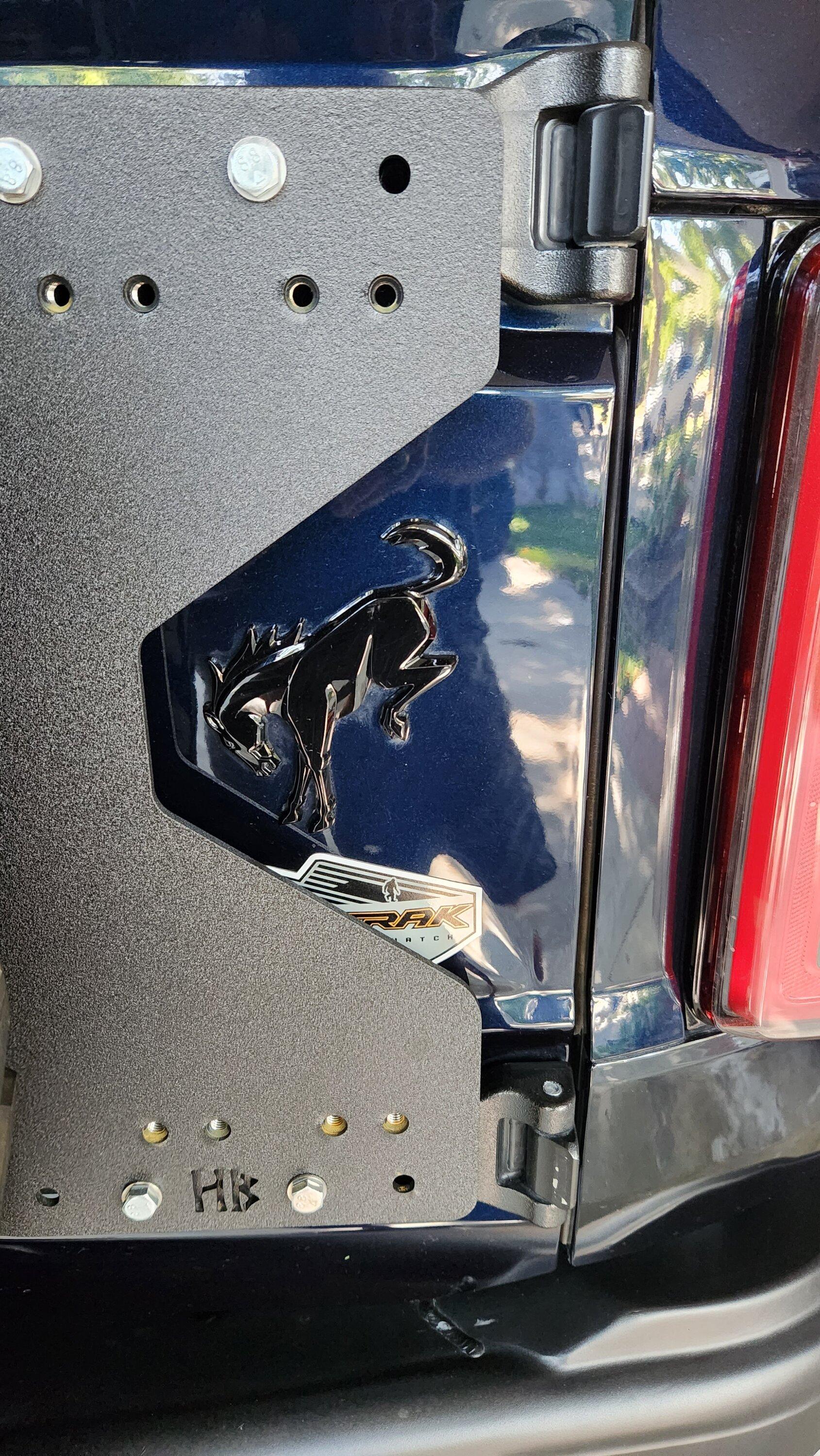

I'm planning to go this route - Raptor hinges and HB reinforcement. Other than the two hinges from Ford above - is anything else needed as far as Ford parts? I was also looking at this thread on Bronco Nation and wasn't sure if the additional parts listed there were needed - https://thebronconation.com/accesso...nforcement-options-a-battle-of-style-t.17321/

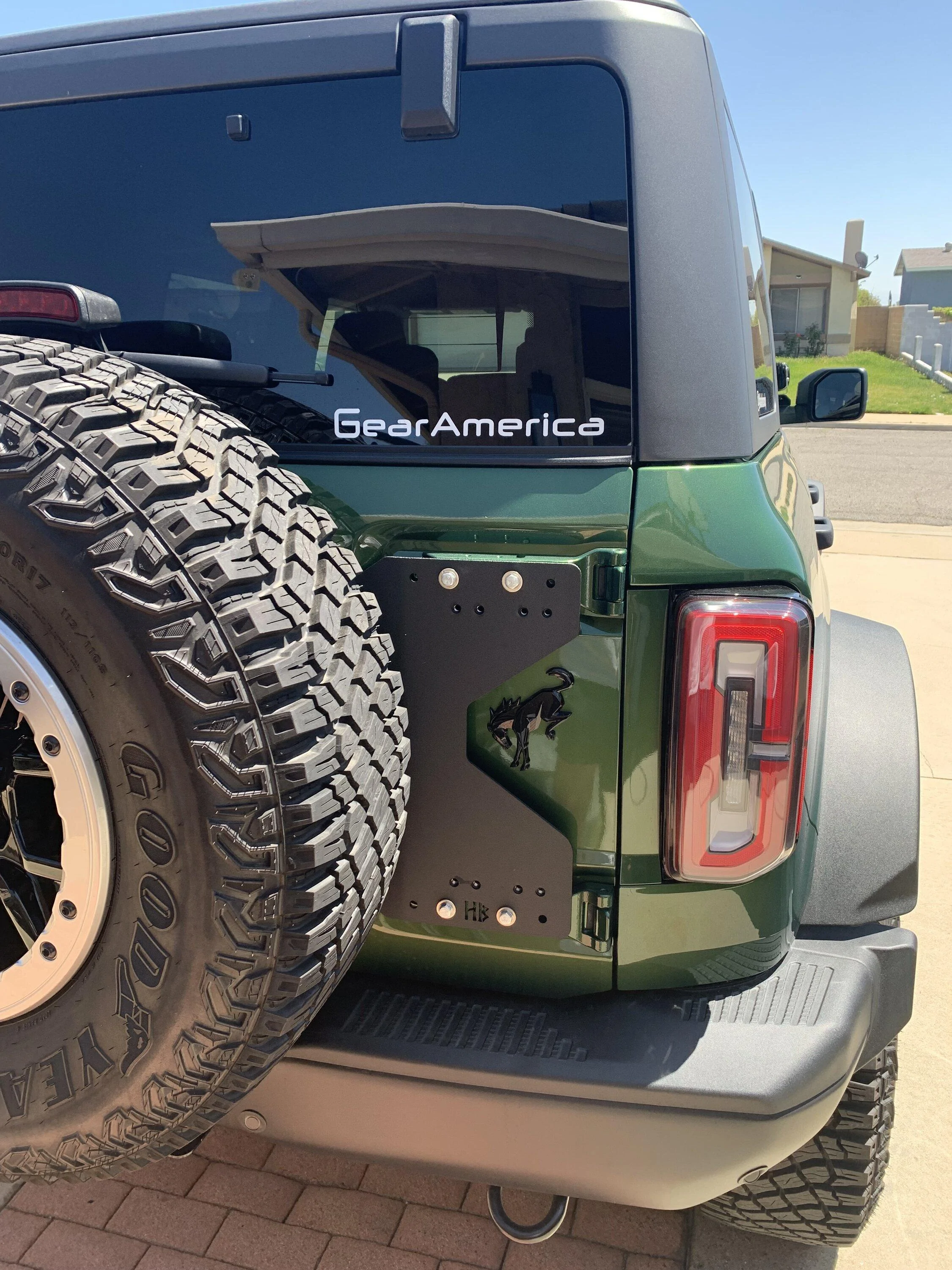

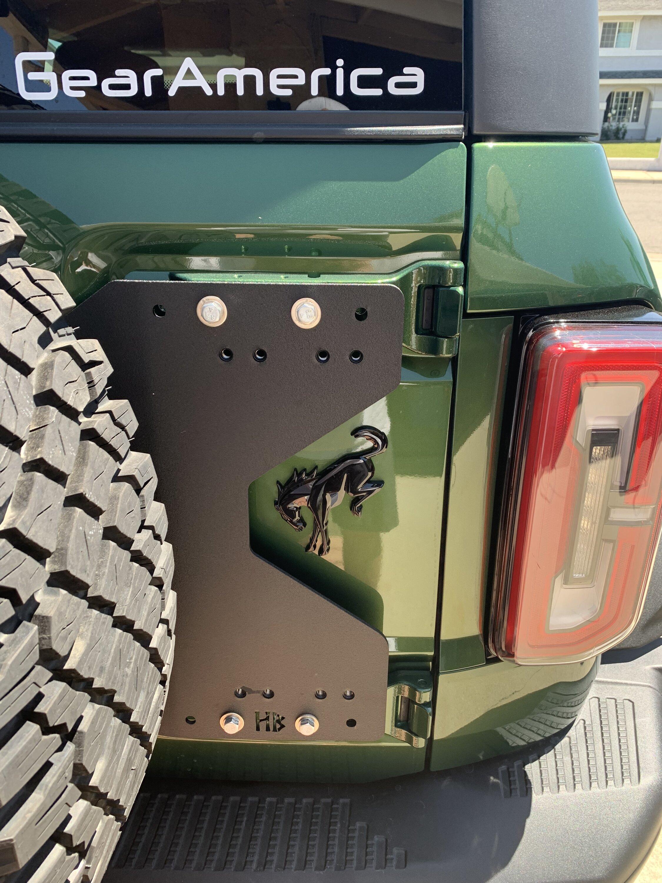

That’s all I used to install My hinges and HB reinforcement, besides painting the hinges to match the Bronco.
Ford Bronco Raptor Tailgate Hinges installed with Hammerbilt Bracket IMG_6798
Ford Bronco Raptor Tailgate Hinges installed with Hammerbilt Bracket IMG_6797

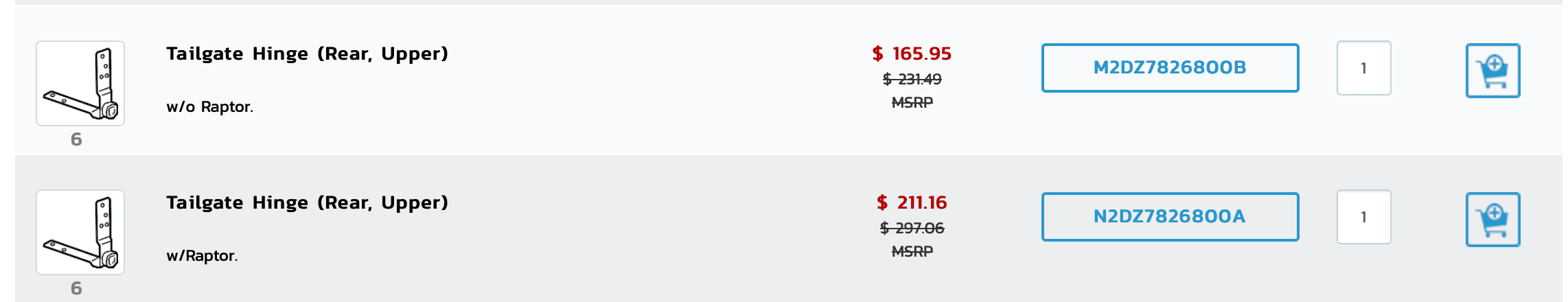

Thanks! Now I'm on a hunt to see who has them in stock and can ship to me. I have an apt with the body shop for other work and they are giving me a deal to have them painted and installed at the same time if I can get them in time.
any idea what the difference between the with and without Raptor options are?

You are referring to swapping your OEM hinges with Raptor hinges, and NOT using Raptor OEM plate, correct? Opting instead for HB Raptor-hinges specific plate? If so, you can buy the Raptor hinges from loads of online Ford parts sites...for about 400 for the pair. I tried body color painting mine, and It did not go so well because the day I chose to paint them was on the warm side and the pain was partially drying before it was hitting the hinge. After having them on for a while I decided to get them sandblasted again and to then have them powder coated in black...for me that was a much better choice. They come with a factory primer on them, but if you're going to paint them I recommend sand blasting first. Those little rubber pieces are meant to prevent the hinge from hitting itself when opening all the way, and you could use the ones that are on your OEM hinges and just swap them over if you'd like to save a few bucks. You do not need to replace the bolts that bolt the Raptor hinge to the tailgate because they are the same part number as the bolts that hold your OEM hinge to your tailgate.

My game plan is indeed to swap out my OEM non raptor hinges with the raptor hinges and then have the HB reinforcement plate installed.
I've looked up and called over a dozen online OEM part sites to finally have one offer to look up for me where they show in stock so I could narrow my searching. Turns out both that showed on hand stock have then in stock as filling a customer order and weren't available (but kudos to the folks that were willing to look up that info for me).

Raptor hinges on order (best price I found was $201 and some change each).

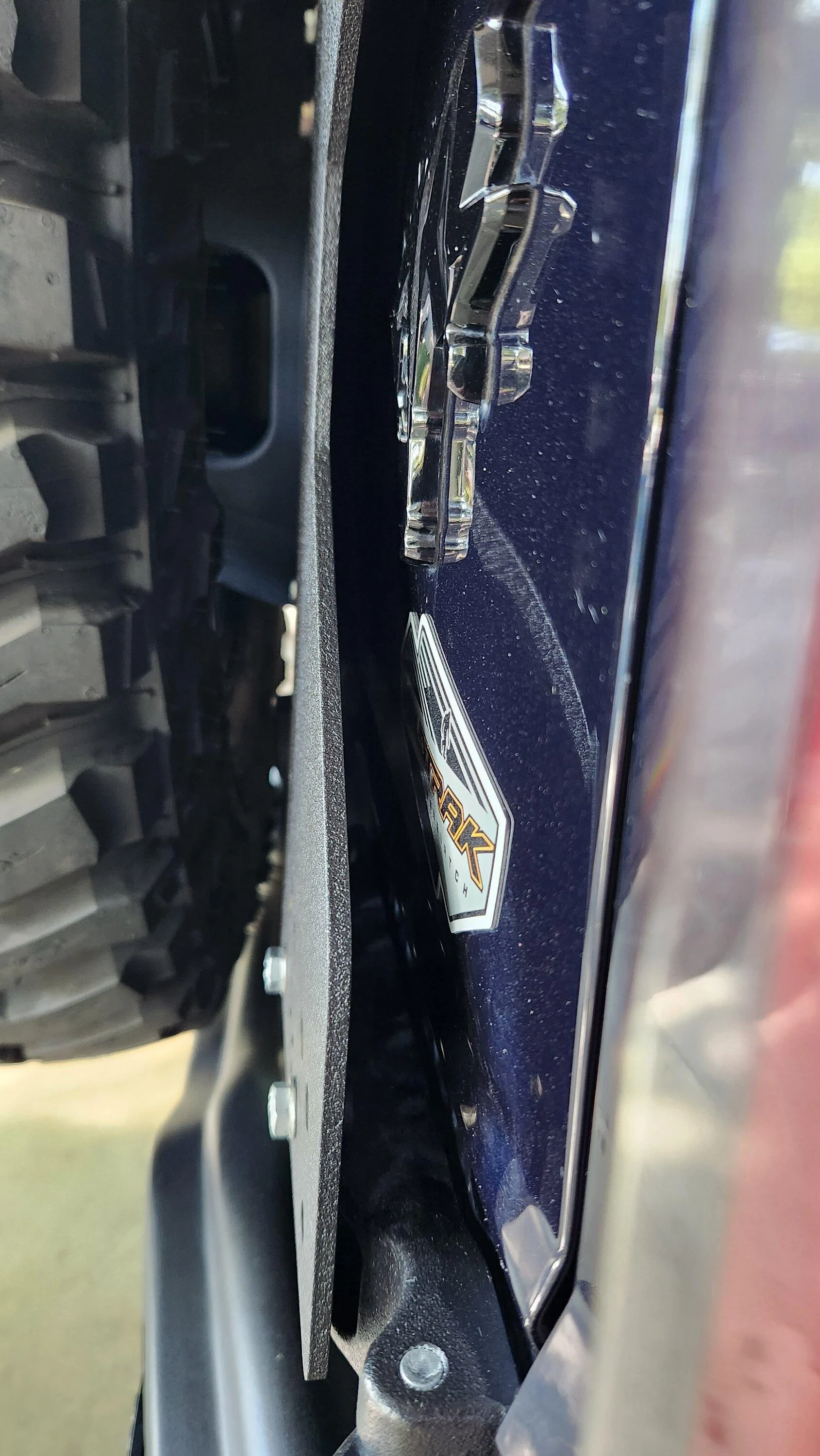

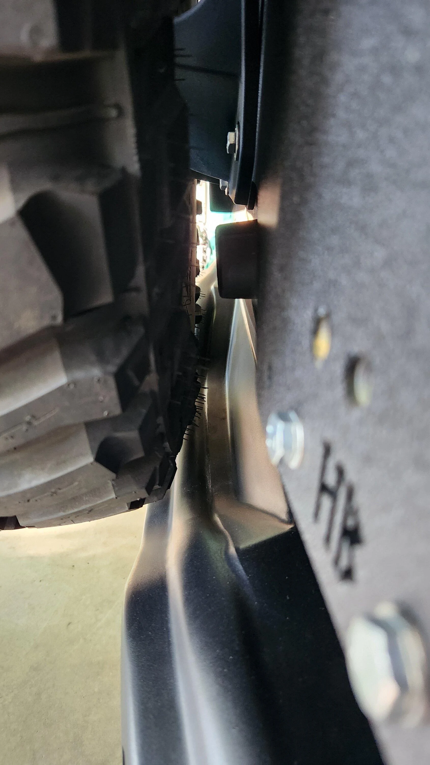

As I finalize plans... looks like you have the stock 35's with the badlands sas - did you have to extend the rubber stoppers on the tailgate with the reinforcement panel installed?
