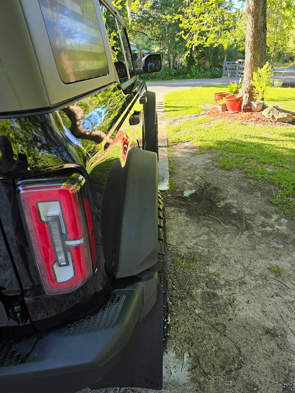

My understanding was the Braptor was 6" wider than a SAS Bronco . I could be wrong , but never herd 10" before .
The picture is o Zero offset wheel 17x9 with a 5" backspace and a 37x12.5
that is the stock SAS fender
