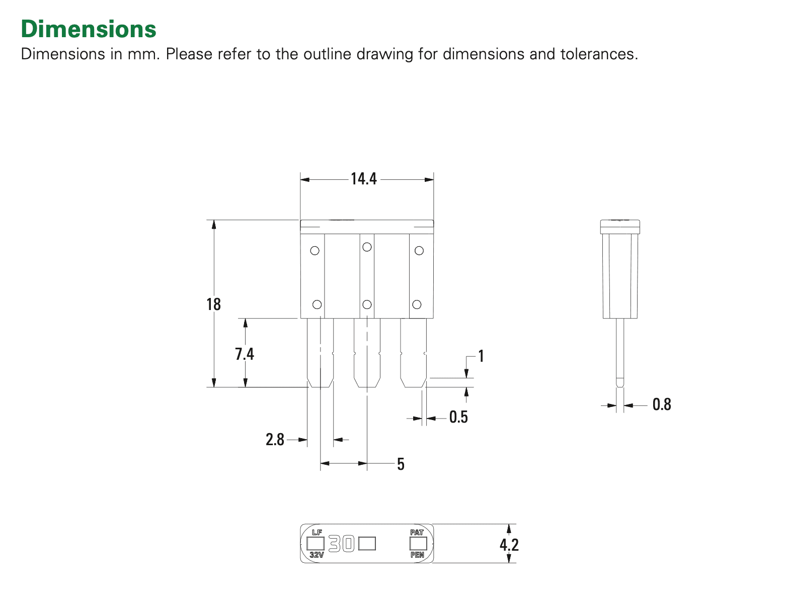

Buy a 5 Amp micro 3 fuse, the same that's in F19/20. There are two links in the fuse. One is F19, the other is F20. Cut one of the links. Plug in the fuse so the intact link is in the F19 position. That will disable the Telematics modem. Your lights will still work.
Micro 3 fuses have three pins. The center pin is common, usually it's the hot pin. The outside pins are fuses for two different circuits. In this case, one is F19, the other is F20.
According to the printed manual, F8/9 is a spare fuse. Only one side of F21/22 is used. Both are micro 3 5A fuses.

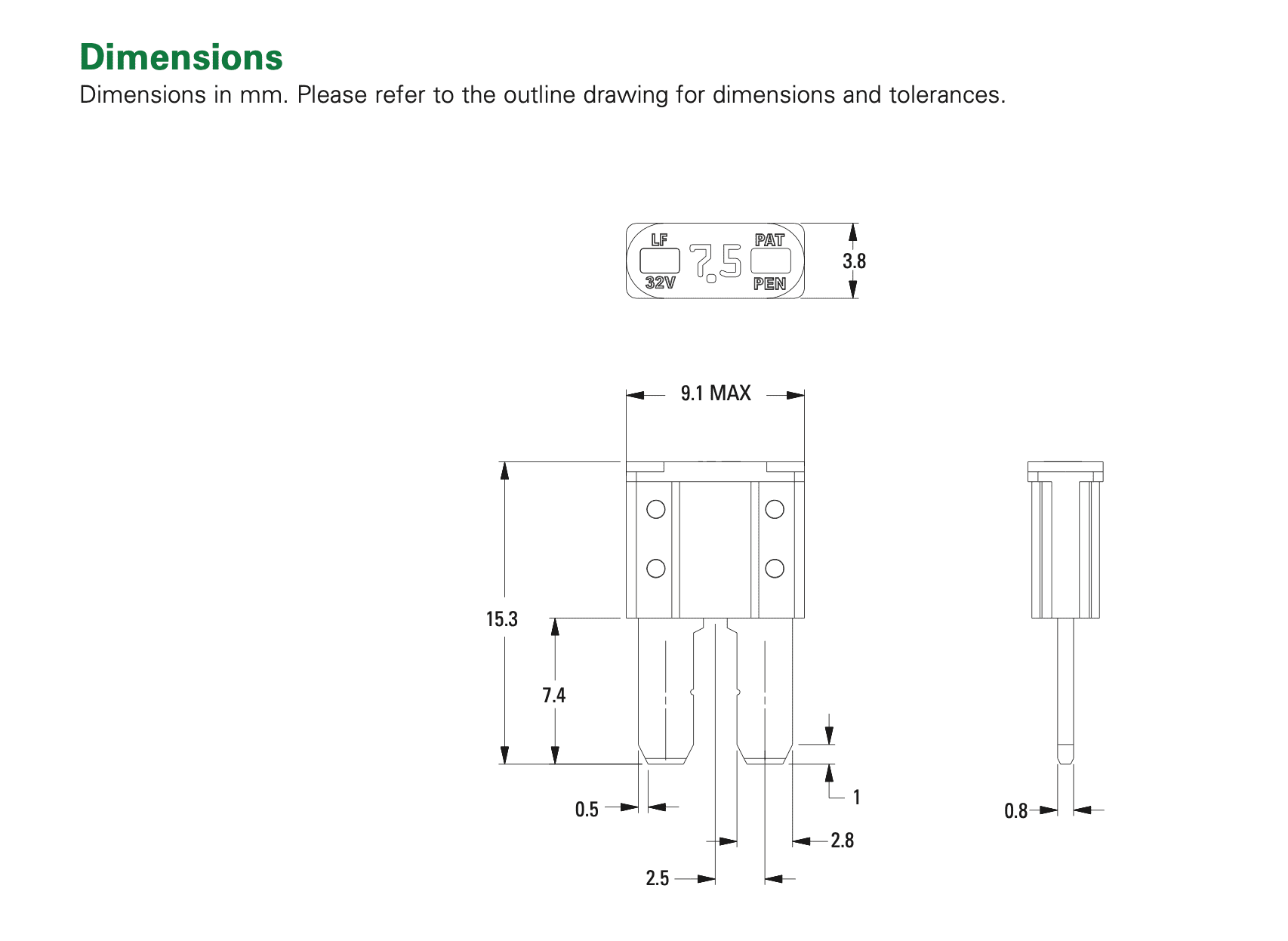

I haven't messed with 3 prong fuses.... but will a normal mini 2 prong fuse fit in the slots for the side you want to work? Or are they different sizes?
That's a good idea. I hadn't thought of that. It looks like one will.
Note that these are micro fuses, not mini fuses.
