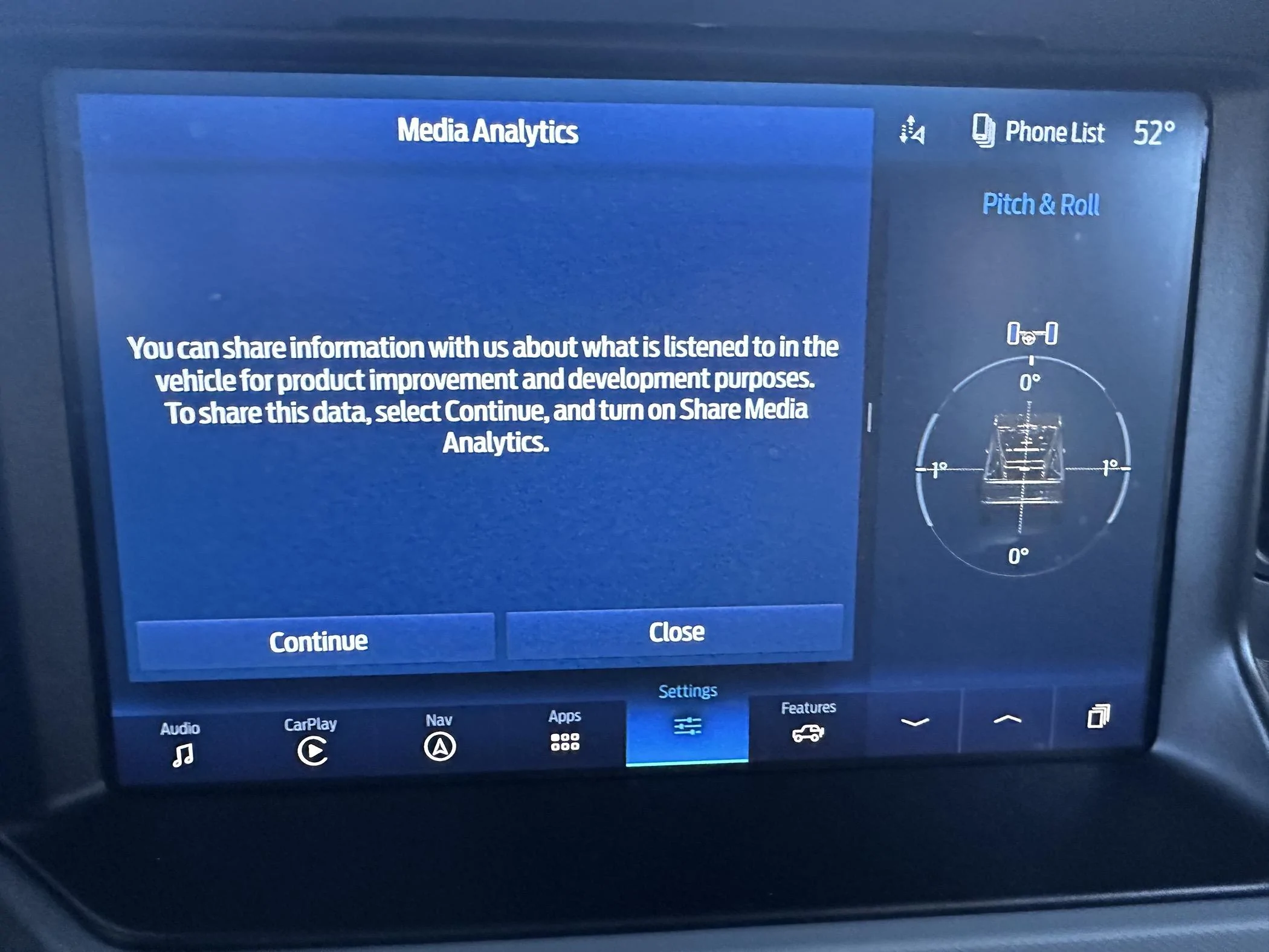

I decied to do this when I got a message while I was driving that stated:
"You can share information with us about what is listened to in the vehicle for product improvement and development purposes"
I noped out of that that real quick and pulled the plug on the modem. I did this over a half year ago and so far I have not noticed any issues so far.

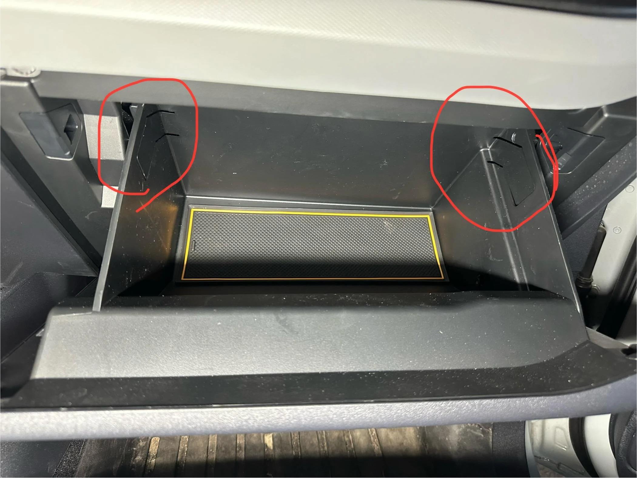

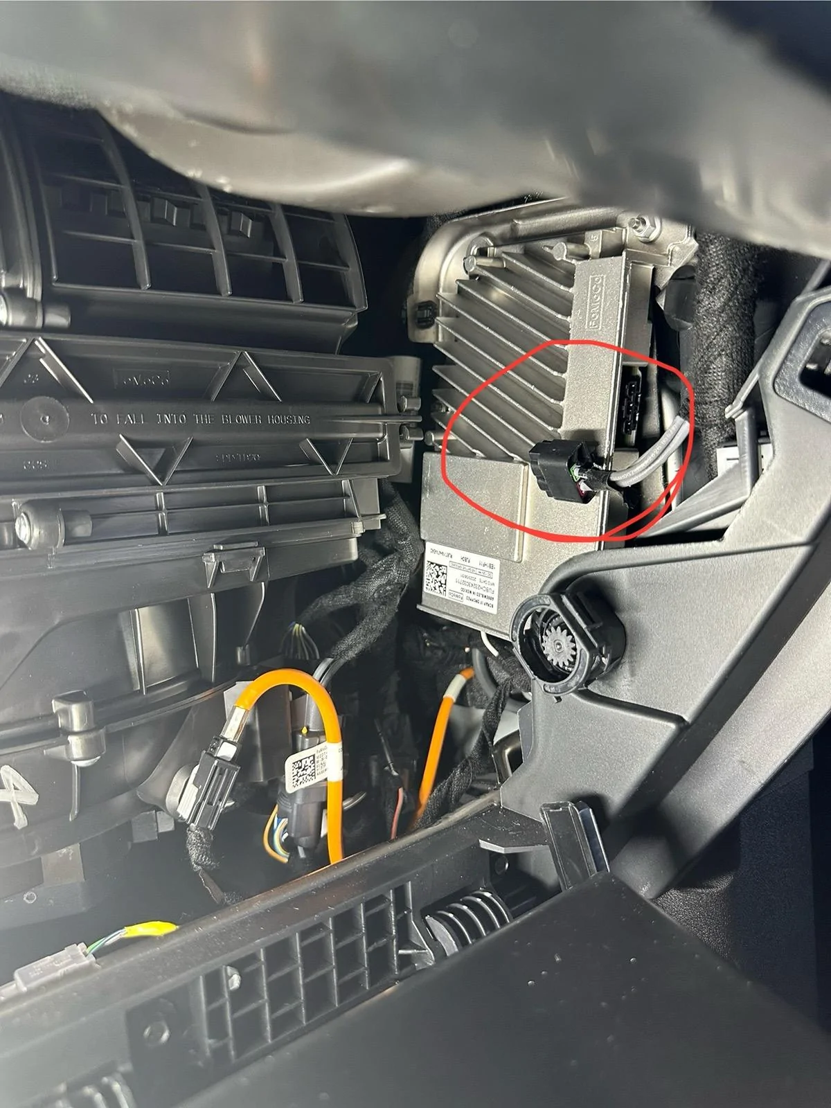

Then I just unplugged the cable leading to it but here are the steps:
Open the glove box
push the tabs to remove it from its rail
then disconnect this cable leading to the TCU

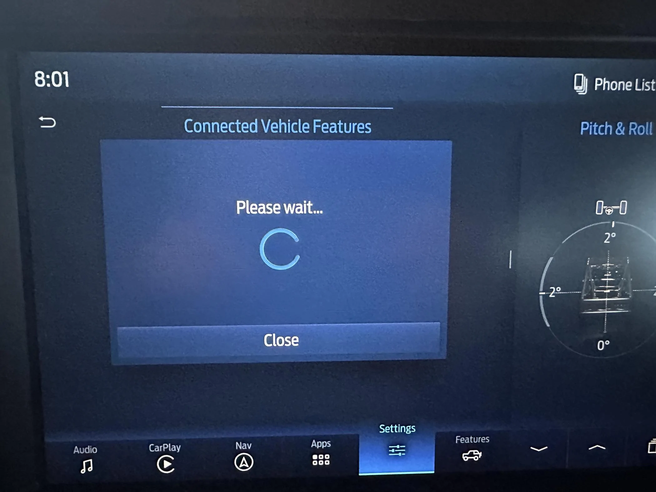

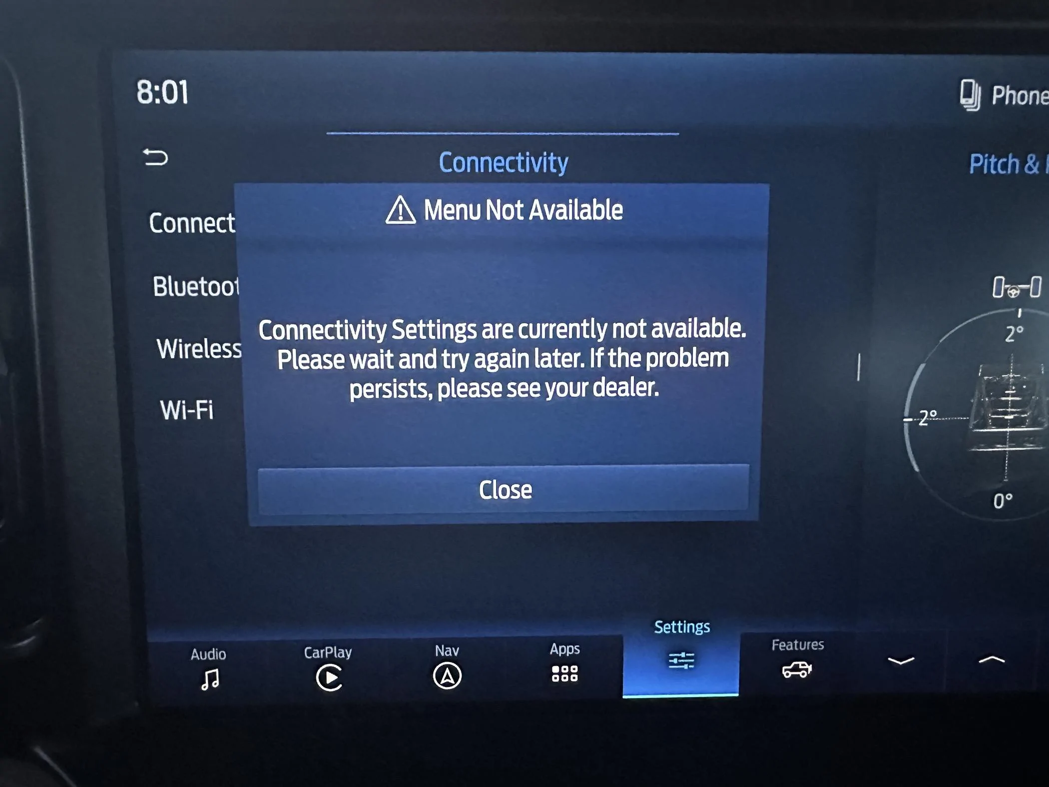

Afterwards if you go into "Connectivity" then "Connected Vehicle Features" it will spin and time out or give you the error below.

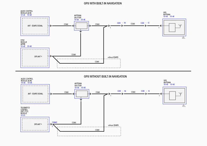

GPS is passive in that you can't track someone by GPS via the satellite. You need that person transmitting their GPS location - either by car modem or cell phone. As I posted, I have taken care of my cell phone for all this data brokering/selling of personal info. I'm trying to figure an easy enough fix for the Bronco so everyone can do it. If not, I'm pulling apart the dash, pulling out the infotainment system and yanking the modem behind it. If that throws a permanent service alert, so be it. It seems as simple as pulling fuse 20 under the dash, which will give you a permanent service alert but your lights may not work/Bronco may not start because Ford does not want to make it that easy, but I'll look around a little more for a way that does not throw that alert where the Bronco works fine. Otherwise the dash comes apart.

Done! Now I was not using a flashlight, but I figured it out. The clip/wiring you take off the TCU is not squeeze on the wide sides up and down. Use a small screwdriver on the side of the clip facing towards the glove box area. Depress the middle prong with a small screwdriver and it pops out.
