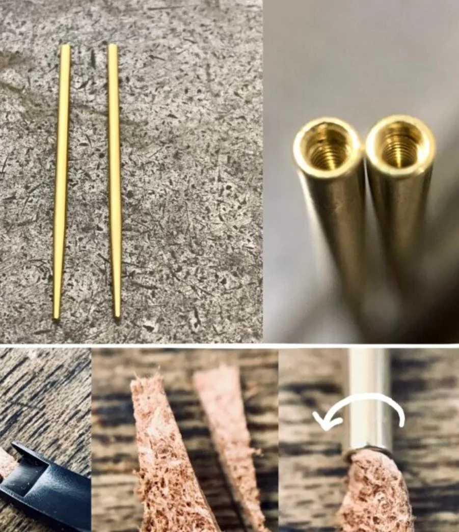

I use sharpened leather lacing needles for this. They come in a bunch of different sizes, screw on very securely, and can be used in tight spaces easily.

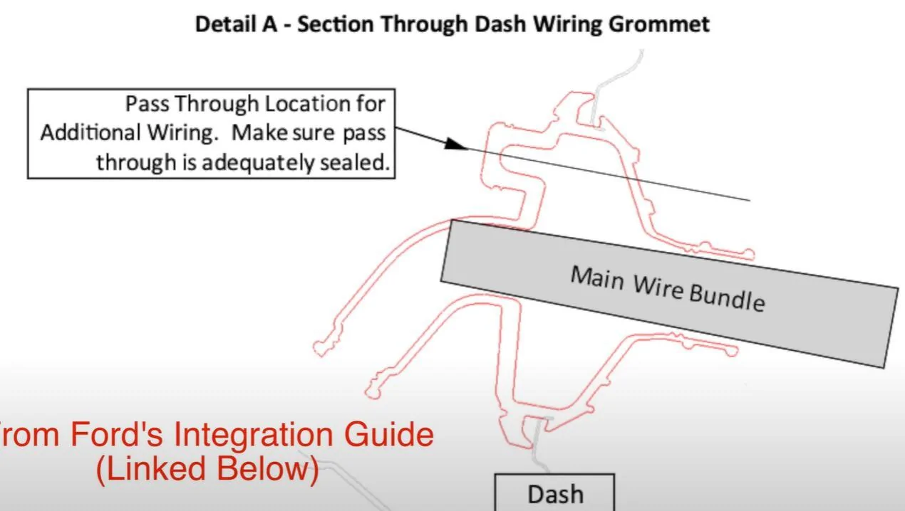

Instead we have to use the actual wire grommet, and boy is it annoying to get through.
A bit confused. This tip wouldn't work for the actual grommet?
I've obviously not worked on a non-Raptor. I've got a plethora of wires fed through his plug 😆.
RagnarKon
Bryan
Aug 5, 2021
5,501
14,635
New England
Ford Bronco, Escape, Focus
Yeah the actual wire grommet has an inner and outer seal to poke through. It's not just a simple plug.

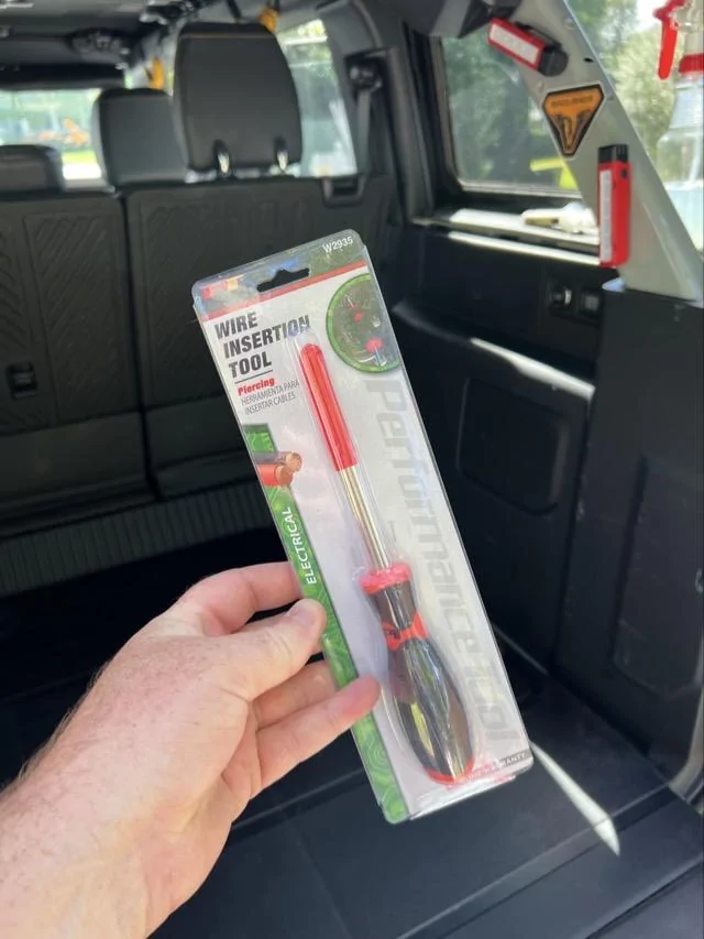

One non-TSA approved pokey pokey stabby stabby tool acquired.
More excited about this tool than I probably should admit, but we’ll see it I manage to get the work done without goofing something up.
