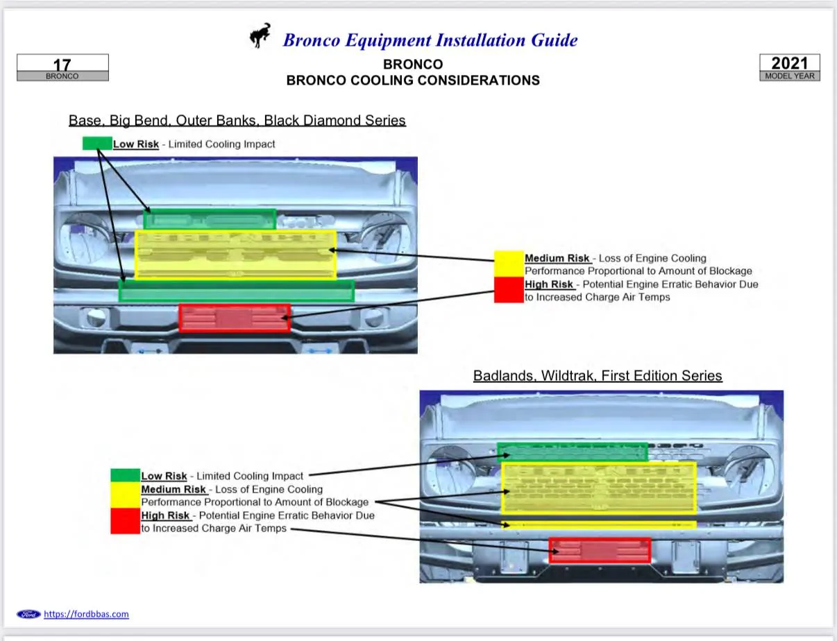

From the Bronco Installation Guide published in 2021…
Ford Bronco Please help IMG_3875
This was pre-Raptor launch but the Raptor critical cooling zones are commensurate with those illustrated.
Wow! The value of this forum never ceases to amaze me! Thanks so much for sending this! I've been struggling with this issue for years. Check out the picture of my setup. I'm going to move the light bar to up above the windshield and see if that resolves the issue.
