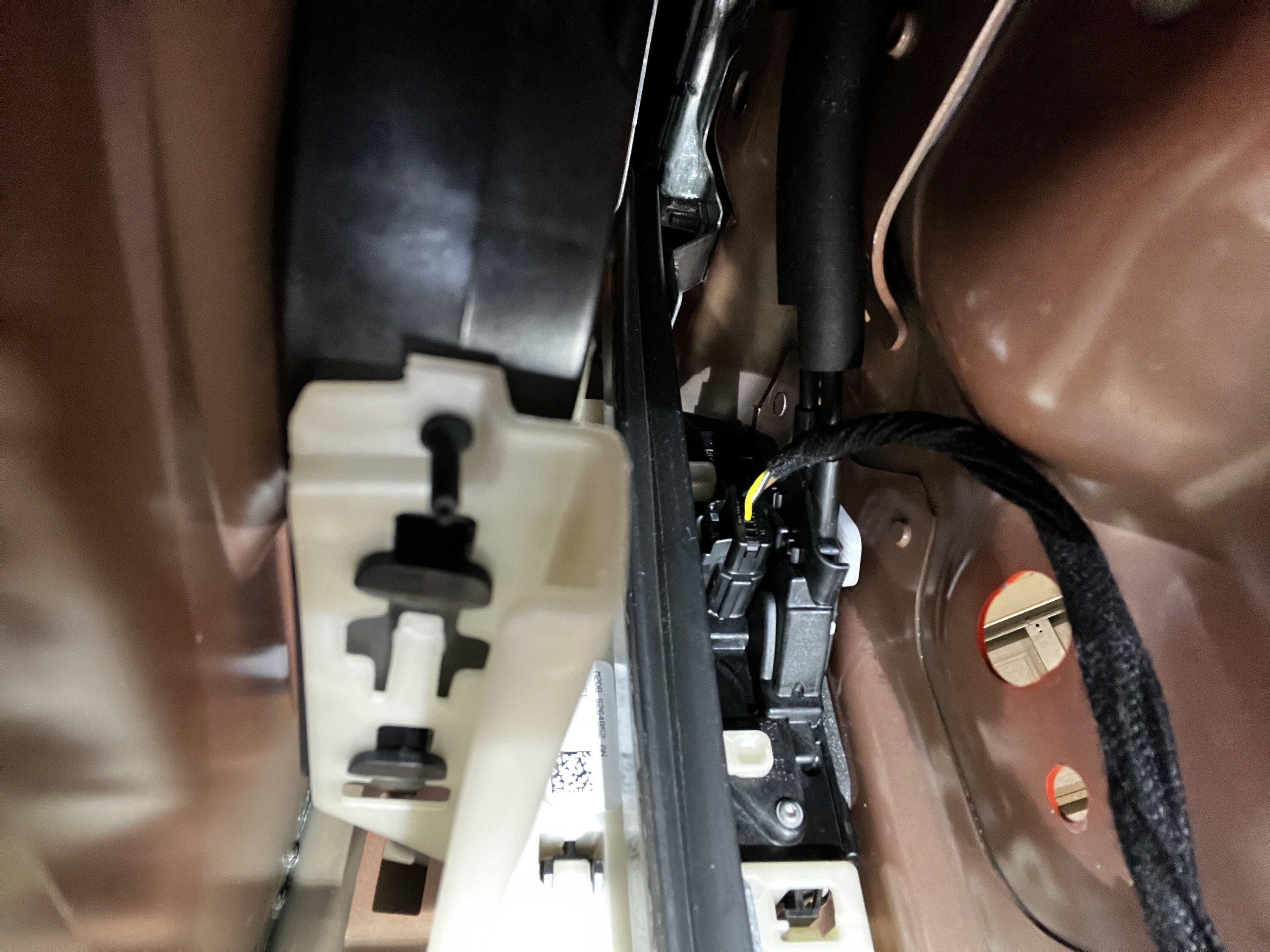

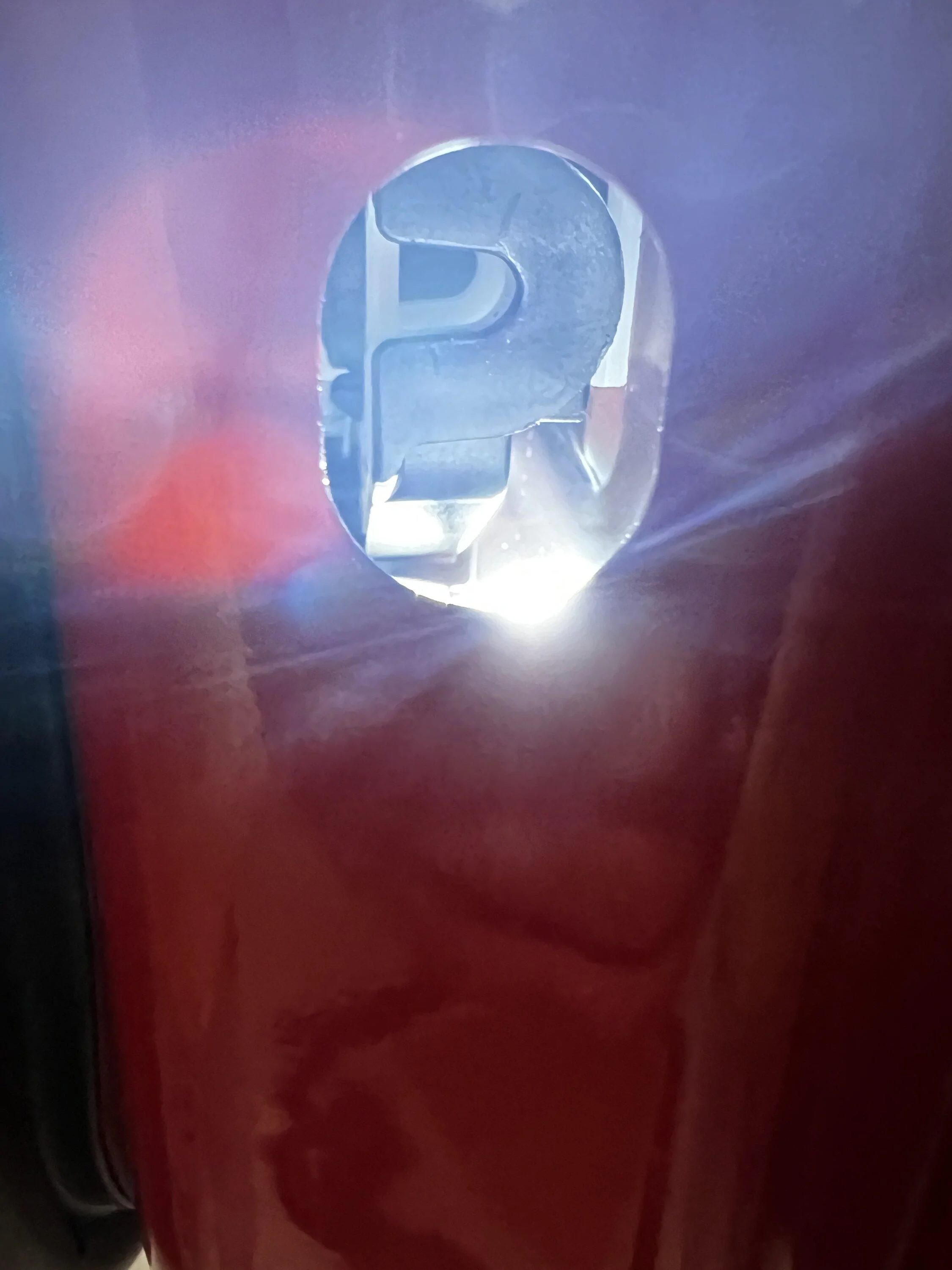

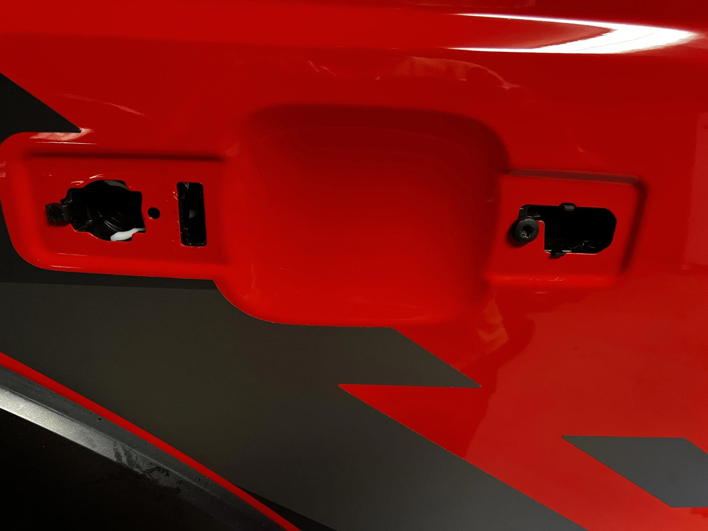

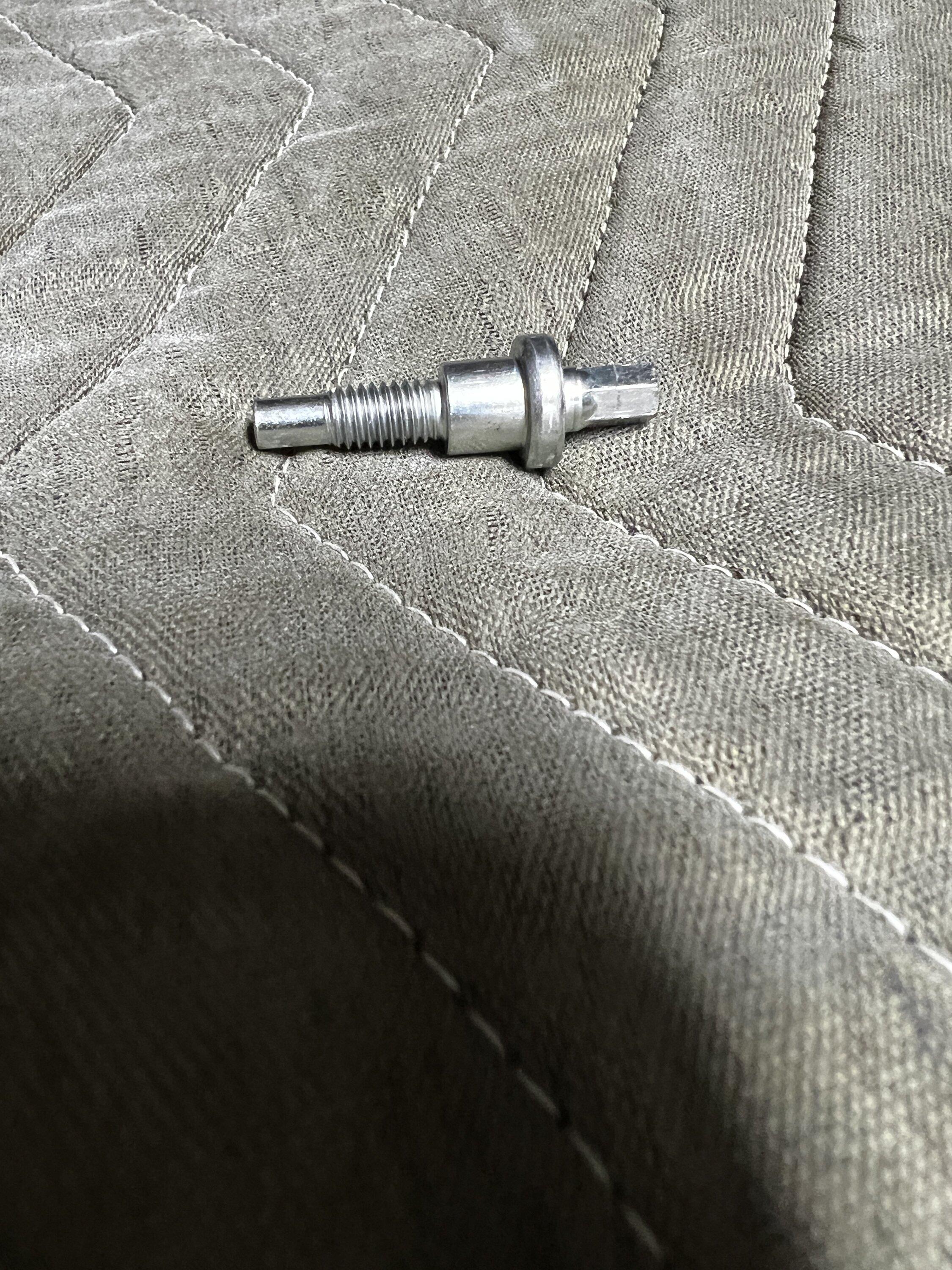

So I took the right rear door handle off to put some door cup film on and when I went to replace the handle the screw that holds it in place came out and I cant get it back in place with out removing door mechanism was wondering if anyone has any experience doing this. see attached pictures.

Yeah that’s only supposed to come out enough to release the handle. Now that it’s completely out you’ll more than likely have to pull the whole latch and reinforcement out to reset it.

Okay here is everything you should need.
First you'll have to remove the rear door panel (if you haven't already)
then in order to get the latch assembly out, you'll need to remove the rear window glass, then the latch itself.
I attached a PDF for each of the procedures including the rear glass alignment procedure in case you need it after reinstalling the glass.
After the exterior door handle adjustment bolt is reinstalled in the reinforcement/latch assembly, you need to make sure the reinforcement is set correctly to get the exterior handle back in. I highly suggest you do this before reinstalling the window glass or door trim panel.
