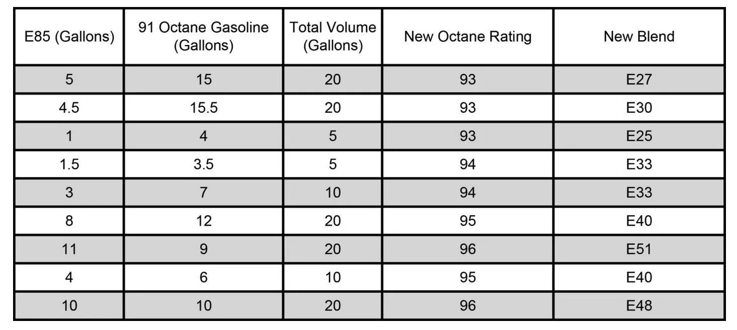

I'm mixing 91 octane pump gas (10% ethanol) with E85. Unfortunately, we can't get 93 here. That would be my every day fill if we could.
I'm using the following chart (source) along with E85cal app.
Ford Bronco PCM Adjustment Time to Octane Screenshot 2024-07-23 at 10.54.48 PM
The app also said to get E48 it is very close to 50-50 ratio of 91 and E85. That checks out with a basic back of the envelope (BOE) calculation of pure ethanol at 100 octane and 91 octane averaging to 96.
(BOE - 1. Ignore the 10% ethanol for a quick BOE, 2. assume equal parts mixture, 3. result is 95.5, not 96.)
She is running good. My 0-60 (definitely not the best way to estimate power) improved from (a poor) 6.6 s down to a 6.3 s. My physics based full vehicle performance simulator calculated that this about a 25 hp gain (and used the same % gain for torque in the simulations).
Are you sure E48 is 99 octane? Are you sure E30 is 96 octane? Does not sound right.
Still not sure how magazines report running sub 6 in the Raptor...

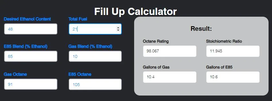

I was just basing the octane rating off an online calculator I found. Certainly could be wrong, but here is what it shows with 91. Obviously this is assuming the pump gas is actually 10% and the pump E85 is actually 85%, which I'm sure is lower. So the octane probably isn't as high as this suggests.
