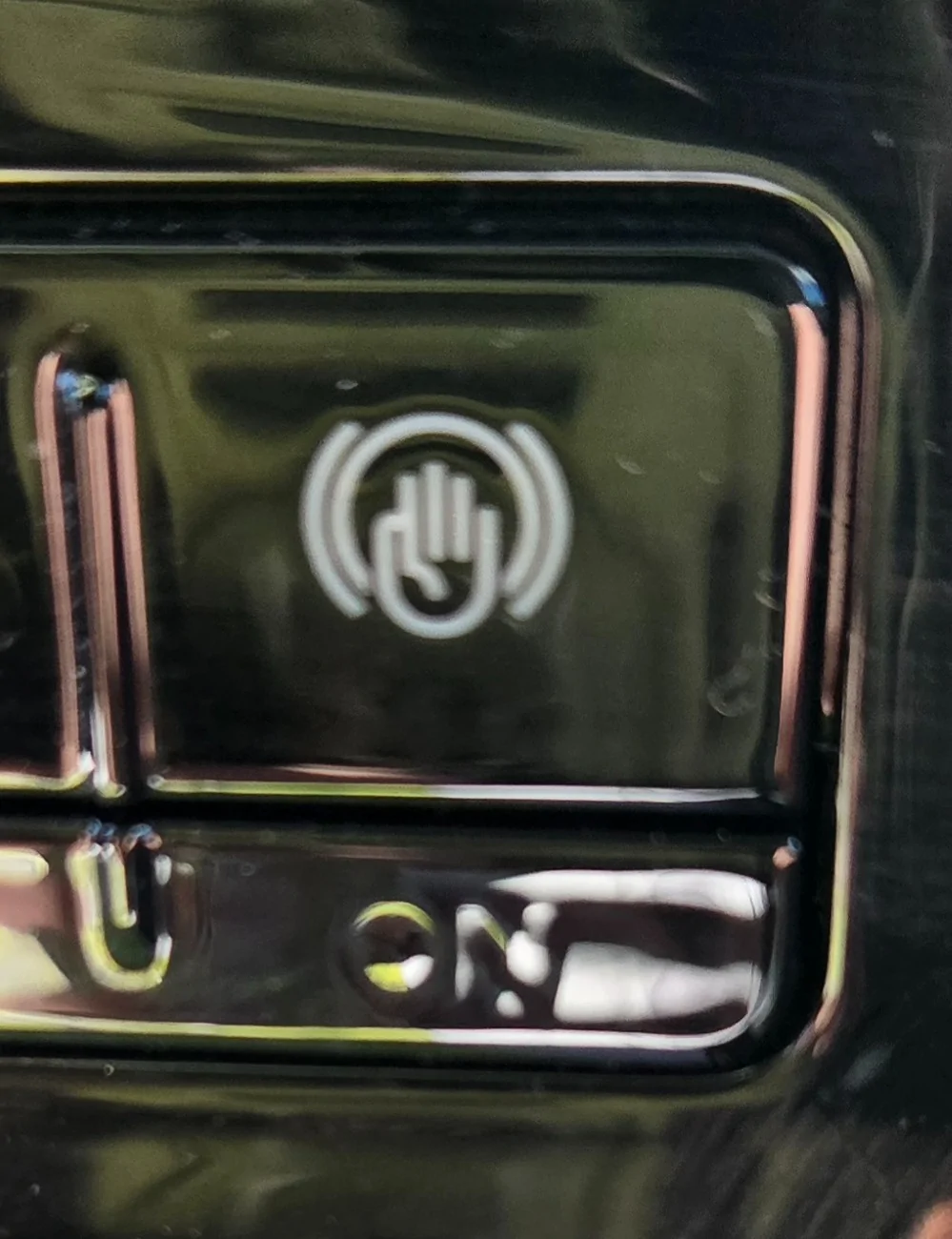

Look for this button, especially on explorers because my wife just bought a 25 and I found this. I dont know if its in the newer Broncos but wouldn't hurt to look.
Ford Bronco Parking Brake sets automatically 20260515_105724

I think so the new explorers are the same
My 2023 Explorer Timberline had that feature as well.
That is the "auto-hold" feature that will keep the brakes engaged when you come to a stop at say, a stop sign....you can take your foot off the brake pedal and the brakes will stay engaged (and rear brake lights remain on) until you press the accelerator pedal where it releases. It keeps you from creeping forward while at a light with your foot off the brake pedal. I have this engaged on my 2025 Maverick Hybrid AWD and it works great. You can turn it on or off....and if you don't press the brake pedal hard, you can modulate your braking without auto-hold engaging. With the feature turned on, the "auto-hold" light will pop on in the cluster when you come to a full stop and have pressed the pedal hard enough to engage the system.

Thanks for a much better explanation than what I read about that feature. It really sounds more like taking the responsibility of being a driver out of the driver though. Of course, I dont live in a CITY and dont have to deal with "traffic jams" per say but its part of being a driver and keeping your foot on the brake when needed or park brake applied or in PARK. 🤷🤷
Thanks again for the much clearer explanation though.
