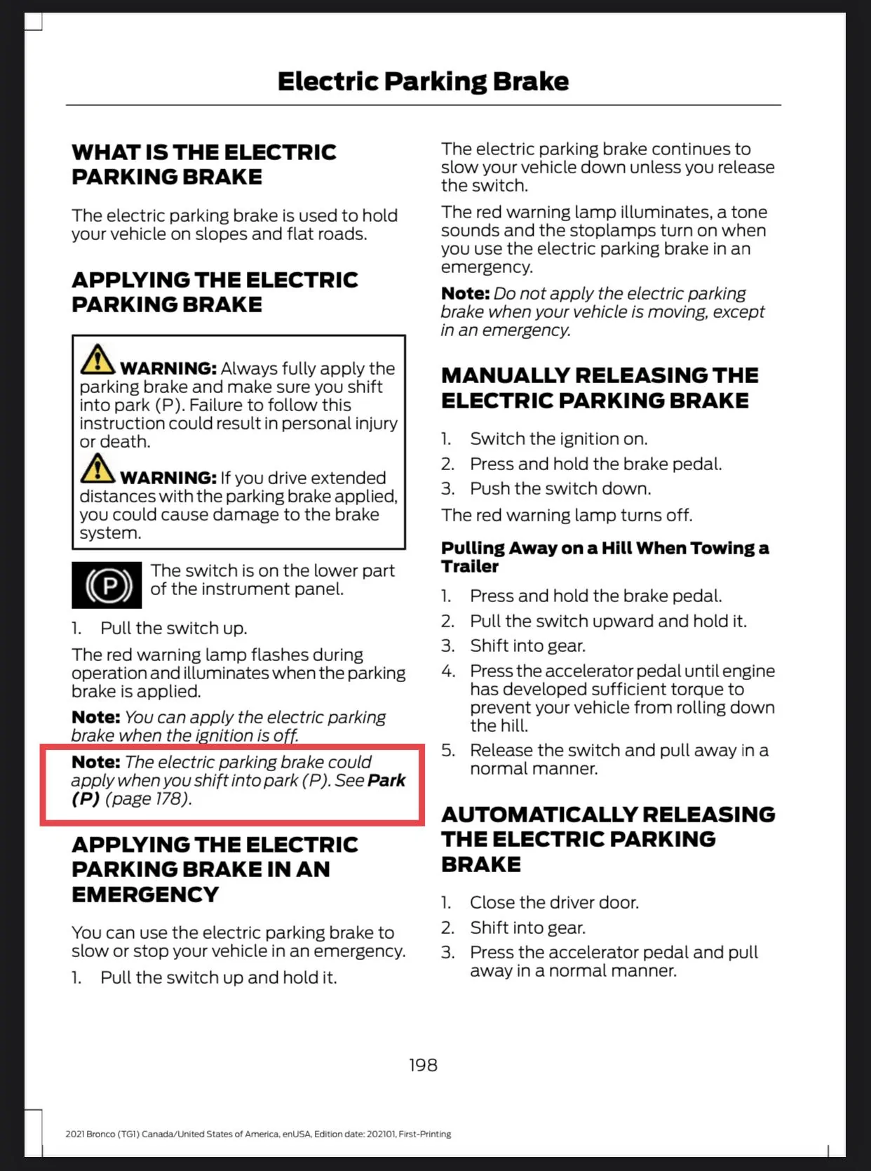

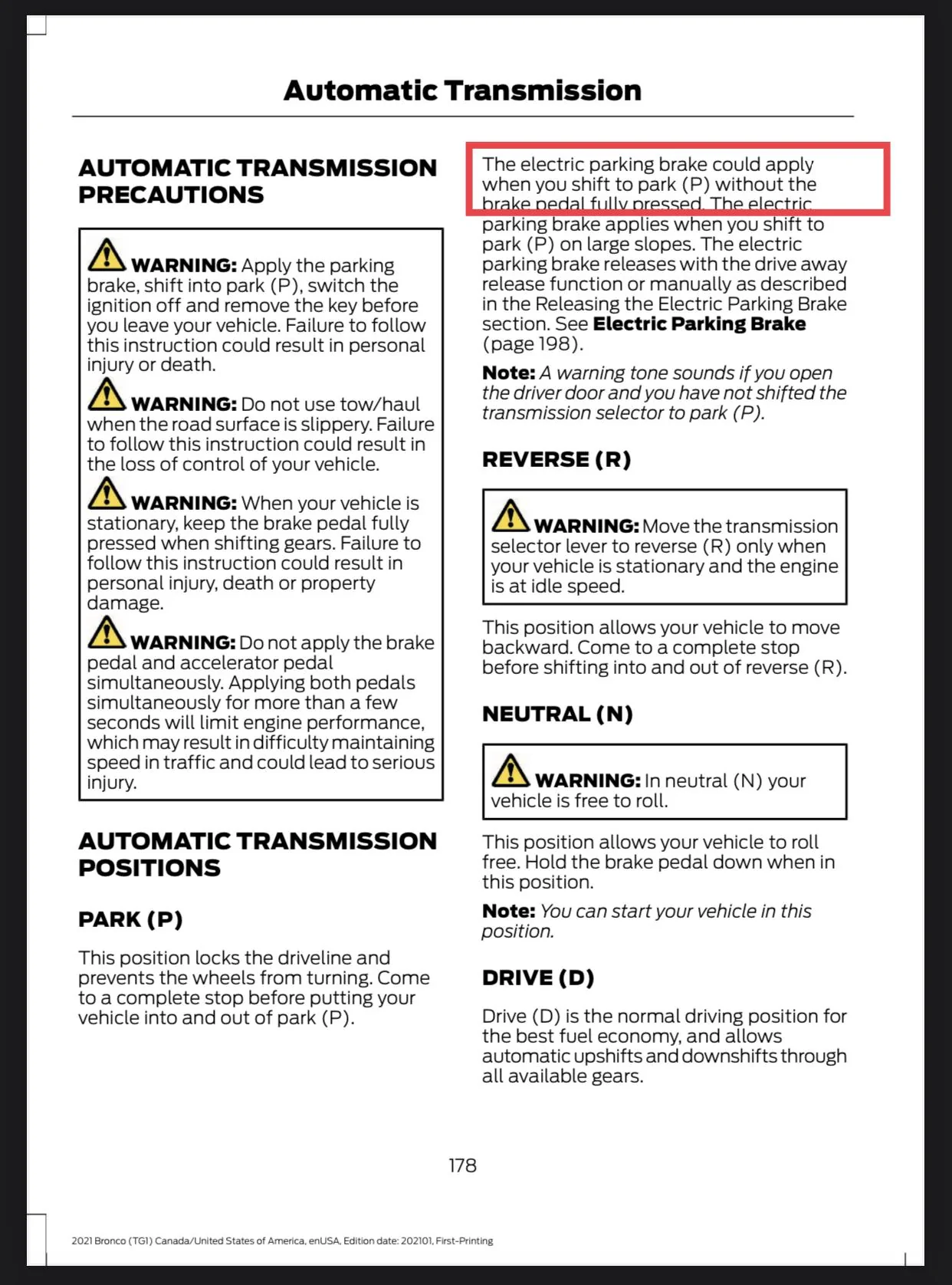

According to the manual:
“The electric parking brake could apply when you shift to park (P) without the brake pedal fully pressed.”
Ford Bronco E-Brake engaging automatically CD0BD0E7-6C5E-4D6A-A807-0988B4D2A1F8
Ford Bronco E-Brake engaging automatically 27B4E43E-1BEB-4B3C-BD9D-3D607BEFF849
Thanks. That might be it. Will have to pay attention next time to see if this is the cause
