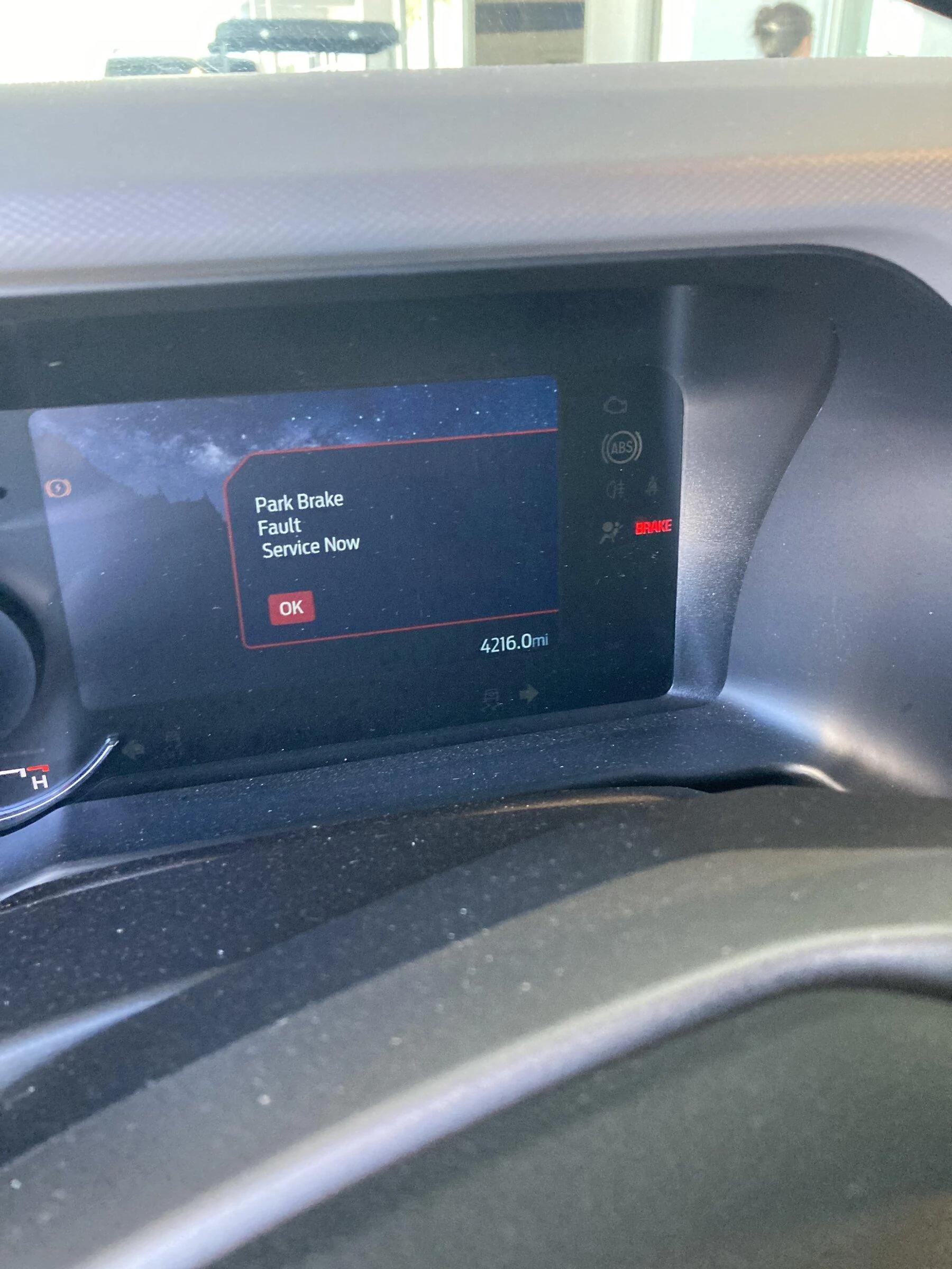

I open the door, before I start it, theres a rapid beep and a red "parking brake fault" message. which then goes away when I start the car... and I did not have the parking brake set, but maybe it sets it automatically when I park?
it happened the first day I had the car and I freaked out but it didnt happen again until today, a month later. It was frigid both times, Im up in michigan, it was like 10 degrees today.
anyone had this? I know dealers typically struggle to diagnose random issues that dont present regularly, I dont want them to start doing exploratory surgery.
