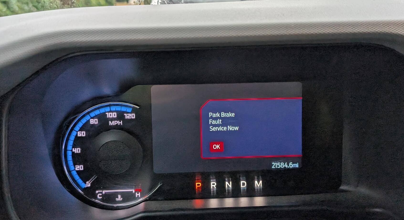

A random message popped up saying parking brake failure- service immediately. Outside of my warranty. Took it to dealship & had to pay $150 for a daignose/update. Really?

I’ve seen this a couple of times — if the brake
Is a bit slow releasing the computer thinks it hung up and will throw this.
Low battery voltage can cause the brake to go slow. So can just hitting the accelerator to disengage rather than using the handle - but that’s rare.
If it clears and doesn’t come back I don’t worry too much about it

I have the same issue, I took it to the dealer and they couldn't find an issue. I get it every few months.
Ford Bronco Park brake failure - service immediately 1736806235548-e7
