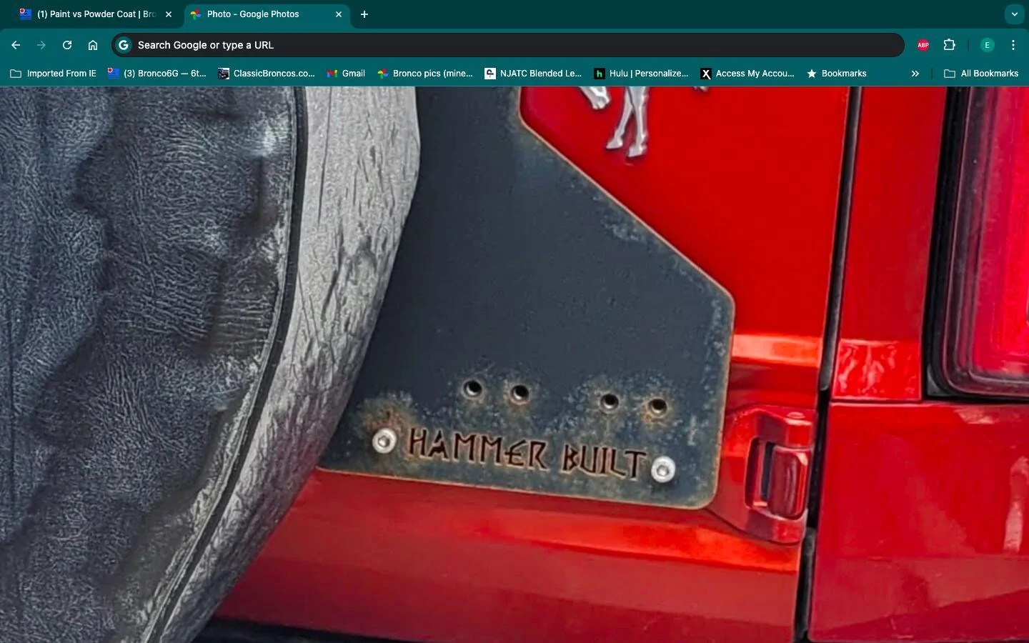

I have a pic of somebody's tire carrier I took at the Wis. Dells Super Cel this year.
Might get in trouble for this, LOL ....
Note the edges and threaded bolt holes. This thing is simply not a candidate for powder coating.
To be honest, it's not a candidate for any coating until it gets a fair amount prep work.
Ford Bronco Paint vs Powder Coat Screen Shot 2024-07-13 at 11.43.19 AM
This is why... I ... Me .... I prefer a heavily prepped piece(sand blasted, sharp edges rounded off, etc) , sprayed with epoxy primer as the main line of defense against rust. The epoxy will bond much tighter to the steel and really slow the advance of what you see above.....and it will be TOUGH, but if/when it gets damaged, it's protective qualities around the damage will remain intact AND you can repair it afterwards.
